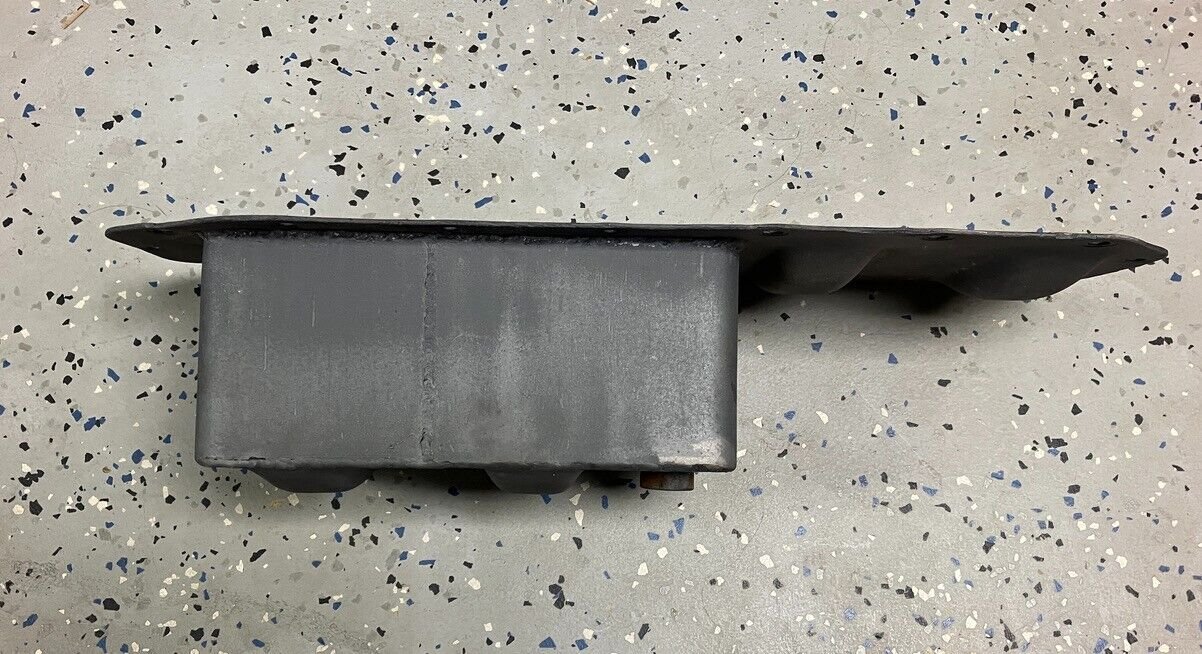

Deep sump oil pan question
I picked up a deep sump oil pan and I would like to use it on my 1926 non pressurized engine. I have other speed items on the engine so this would be a neat period piece for the bottom end. Looks like an original pan extended to hold 2-3 more quarts. Sump hangs between the wishbones. Pan has a single drain port to drain the sump. Other than taking extra oil, any concerns running this on a non pressurized engine? Oil would fill the sump and pan and just spill back into the trans like a stock pan. Just want to do a sanity check before running this. Thanks!

Re: Deep sump oil pan question
First post. Picture? Why would you want so much more oil? Original pan is sufficient if you check it occassionally. The two oil holes in the pan is how you check the oil level. With only one hole, how would you check it? On the original, the shallow area under the rod bearings ensures the bearings have sufficient oil. Such a deep area between the wishbone might cause the bearings to not get the proper lubrication specially when going up hills. I’d worry about sloshing in such a deep pan without baffles. Jim Patrick
What other speed stuff? Dips on the rods? You may think about using a cut T pan mounted above to eliminate windage of the crank that may starve rod bearings. Also not a bad idea to tie the 2 bottoms together allowing the trans to pull oil from the sump where it should be cooler.
Yea, first post. Pictures won’t load…anyways, I didn’t build the engine but it’s a rajo bb, Winfield down draft carb, original Bosch distributor. Not sure what was done internally but the crank appears to be ground, smoothed and probably balanced.
I wanted to use it because it was a piece of 20’s speed equipment and went with the car. I figured the deep sump wouldn’t matter since the oil level would be to the top of the pan cover even with the deeper sump and travel back into the transmission sump like normal. Oil check/drain would be the same place as a stock T.
Hi Drew,
If you want to use the sump for astetics bolt it on under the inspection cover! The dips retain just enough oil to lube the engine if you remove it
without a pressureized crank you will have to add enough oil to bring the oil level up to the rods.Then when you go up hill you will starve the
front of the engine & going down hill you will flood the engine. With the oil level above the sump you will likely break all records for Model T oil
leaks. I dont think windage has much effect on a engine untill 3000-4000 rpm?
Craig.
The dip tray is necessary as Craig described. "Windage" is necessary. This churned oil mist is what lubes the motor.Craig Leach wrote: ↑Fri Oct 27, 2023 10:56 amHi Drew,
Craig.
If you want to make the sump functional, you drill a hole between each of the dips. Heat & form a standpipe (looks like a volcano) thats about 1/2 - 5/8" high & about a 5/8 hole. Excess oil splashes thru the holes into the sump. A hose between the sump & crank case below the radius rod mount allows oil to flow onto the flywheel & re-slung. Excess Oil cycles thru being cooled.
True Craig. But it was easier to say than describing all you were which is why I mentioned using an original pan as well just with holes. A windage tray was the easiest way to describe how it might come into play. Basically drill a couple holes in it allowing for it to be used as a resivour while stopping the slosh.
Drew, this is the pan you bought from me on Ebay. I made this at least 30 years ago. It was gas welded. I ran this on a non pressurized motor for years with no issues. I would be happy to buy it back from you if you decide not to use it.
