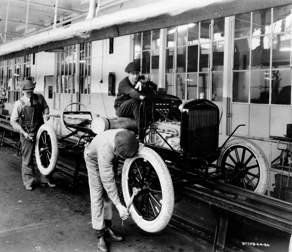

Photo of the 10th million T, note the date on lower right of photo, June 4, 1924 the date of the 10th million.
The zinc plated tank has black straps, but the engine is painted in all grey, special paint job for a special Ford

Tried a free colorize photo service on the Interne t https://www.img2go.com/colorize-image
set to "generic" & high res 35. Even the tank looks galvanized!

That's one hell of a hub cap wrench !
- Posts: 4642
Re: Oval Gas Tank Strap Finish?
That photo has been around before and I’ve wondered the same thing if the two guys are tightening the hub caps or the axle nuts. The guy on the rear wheel is looking at the rear wheel and it’s got the hubcap already on it. So I guess he’s finished tightening it up?
It sure seems they wouldn’t need a heavy wrench to tighten the hub caps but what do I know! I guess Ford didn’t want the hub caps to come off very easily! It’s not real clear what the guy on the back wheel has got in his left hand. Interesting since it’s colorized.

It is a posed photo, so what they were doing/wielding need not necessarily relate to anything that actually went on on the line.

That very well could be a posed photo but using a large heavy wrench to put on hubcaps is more than it actually needed.
