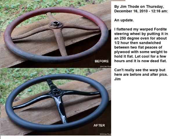

- Posts: 6337
Re: Fordite steering wheel finish?
From two earlier posts above https://www.mtfca.com/discus/messages/1 ... 1292601172
