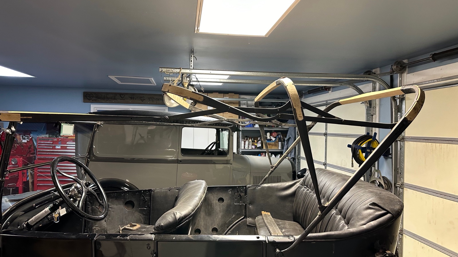

I’m working on a `26 touring ..
It came with a nice set of top bows,,wood kit for bows,,and the rivets …..
I got it all fit and ready to drill and install rivets..I have the backup tool but wonder what the driving tool looks like to round it over …
They have a hole down the center …..
Should I heat before I set them ….
Thanks for ANY help you can offer with the process…..Carl

Check out this older post about doing that. http://www.mtfca.com/discus/messages/80 ... 1249733464
- Posts: 4471
Re: A riveting question..
They're hollow rivets?? The proper forming tool depends on whether or not they're solid or hollow.
No matter what, you should not need to heat them.
https://www.mcmaster.com/products/rivet ... th-washer/
https://www.mcmaster.com/products/rivet ... ow-rivets/
These may be pricey, but you can certainly find cheaper options on eBay.

I have the RIVITS ….They are hollow…That reference to the older post was helpful…
Thanks Guys ,,I’ll post my results when I get them done ….![Image]()

I realize that you have the rivets. The links I posted were for driving tools that you asked about to round over the rivets. I included links for both solid and hollow rivet drivers.
