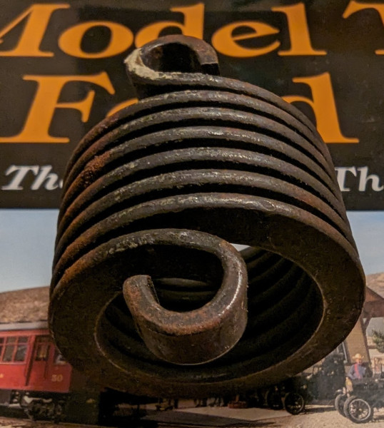

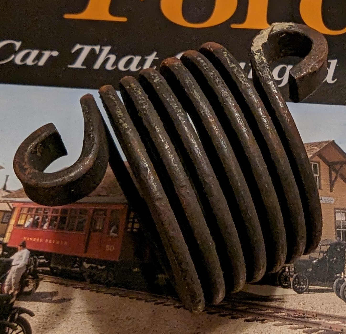

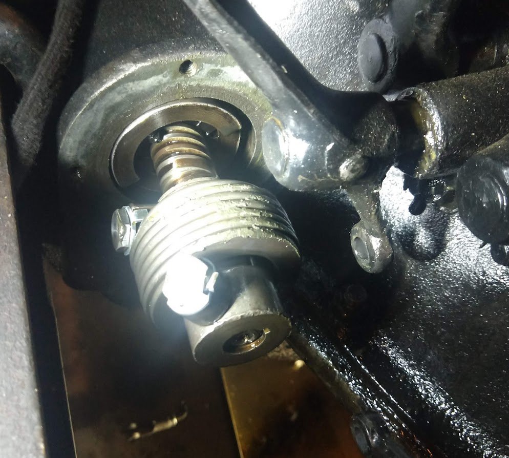

Thank you very much to all who contributed to my problem. I believe I have solved it. I took off the bendix cover and saw that the pinion gear was jammed against the hogs head and would not move.(see photo)
I had tried rocking the car backwards and forwards a little while in high gear. Then I remembered some talk of damaging things more.
So I had to literally pry the bendix out off the starter shaft. I'll next try straightening up the shaft and getting a new bendix if the parts are too far gone. I'm just wondering if the bushings are damaged. We'll see in the next phase.

Boy - I'd say the starter shaft is bent - the spring indicates the car has been started either on 12 volts or the spark advanced - Bendix & starter need to be removed for a thorough inspection !

John, the Bendix spring is shot. You need a new one........ After removing the Bendix, step on the starter button and observe the armature shaft, if it wobbles excessively it will have to be straightened. In my experience, there will all always be a very slight, very slight wobble in the armature shaft, minus the Bendix on testing. You can check out a website, www.modeltstarters.com, for quality rebuilds and Jeff can answer your questions and be a further help .

If that starter shaft is actually bent that much, I would recommend a rebuilt starter. It is nearly impossible to get the shaft completely straight with the typical home tools. Two things can cause the starter to lock up. One would be leaving the parking brake forward when trying to start and the engine won't turn because in high gear. Worse is to try to start with spark advanced. Also using 12 volts with a starter wound for 6 volts causes it to hit the flywheel very hard.

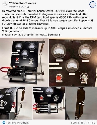

I would highly recommend David Woods if your starter needs overhauling or just a checkup. His prices were more than fair and he had a very quick turnaround,
I think it's important for us to recommend people who do good in this hobby. David can be reached at DWTWORKS@gmail.com. He's in Williamston, MI and his number is 517-927-9232

Have to also recommend David Woods, he does early coils, generators along with starters. Had built this test panel for starters, complete with torque test.
If you do Facebook, his page is Williamston T Works. Has some good info, pics, and videos on his FB page.
Screen shot of the Starter Tester he built to check, and inspect re-builds he does. Nice guy.
