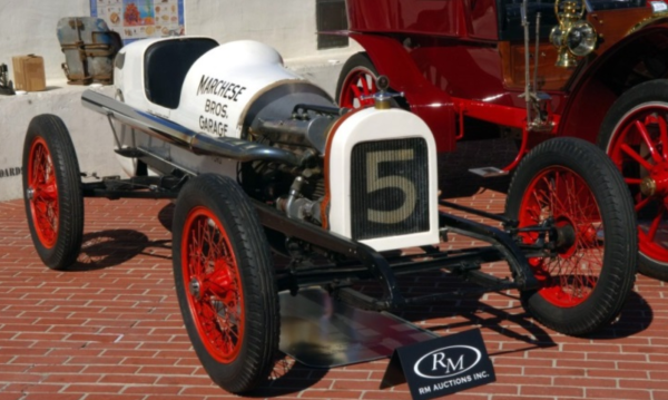

Sold for $41,250 at 2007 Monterey Sports and Classic Car Auction.
The Ford Model T four-cylinder engine was a popular powerplant for racing, as it was strongly built, widely available, and with a little tuning could be transformed into a competitive powerplant. There were many Model T cylinder head builders during the post-War era such as Harry Miller who created dual overhead camshaft Model T heads, and the single and double overhead camshaft rocker arm Frontenac heads created by the Chevrolet brothers. The Gallivan dual overhead camshaft head is a little less known but very technically advanced. These were the ones chosen by Carl and Tudy Marchese in 1925 to upgrade the Rajo head on their Model T-powered car.
In the capable hands of Carl Marchese, the Gallivan head Model T block special was driven to a victory in the 1924 Milwaukee race and set a new record on the State Fair Park track at 77.7 mph. The car continued to race for the next few years. It was later discovered in an Indianapolis wrecking year in 1952. The car was later restored to its former glory.
It was brought to the 2007 Monterey Sports & Classic Car Auction presented by RM Auctions, where it had an estimated value of $25,000 - $35,000. It was offered without reserve. The estimated value proved to be underestimated, as bidding quickly surpassed those figures. As the gavel fell, the lot had been sold for $41,250 including buyer's premium.

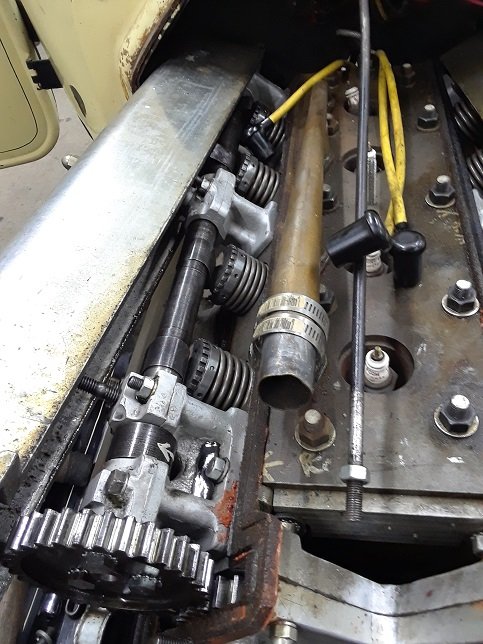

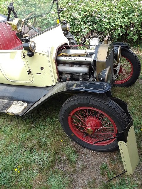

Post by flatbroke3 » Thu Nov 09, 2023 11:53 am

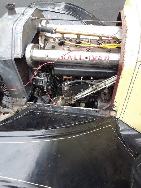

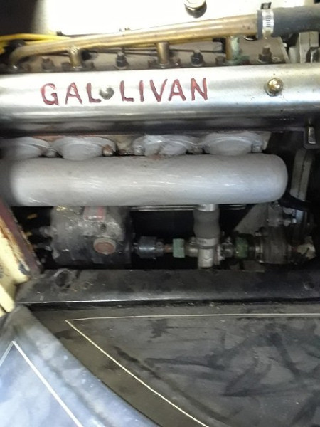

a few photos

Post by flatbroke3 » Thu Nov 09, 2023 11:57 am
will add more

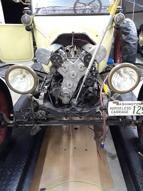

Re: Gallivan Update
Post by flatbroke3 » Thu Nov 09, 2023 12:03 pm
had to resize these

Re: Gallivan Update
Post by got10carz » Thu Nov 09, 2023 12:08 pm
I'd would never have thought that would fit inside the hood of a brass car. The ultimate sleeper!!

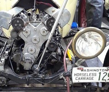

RVA23T
Posts: 834
Last Name: C
Re: Gallivan Update
Post by RVA23T » Thu Nov 09, 2023 9:19 pm
I think the horseless part is an understatement and helps make it a sleeper!

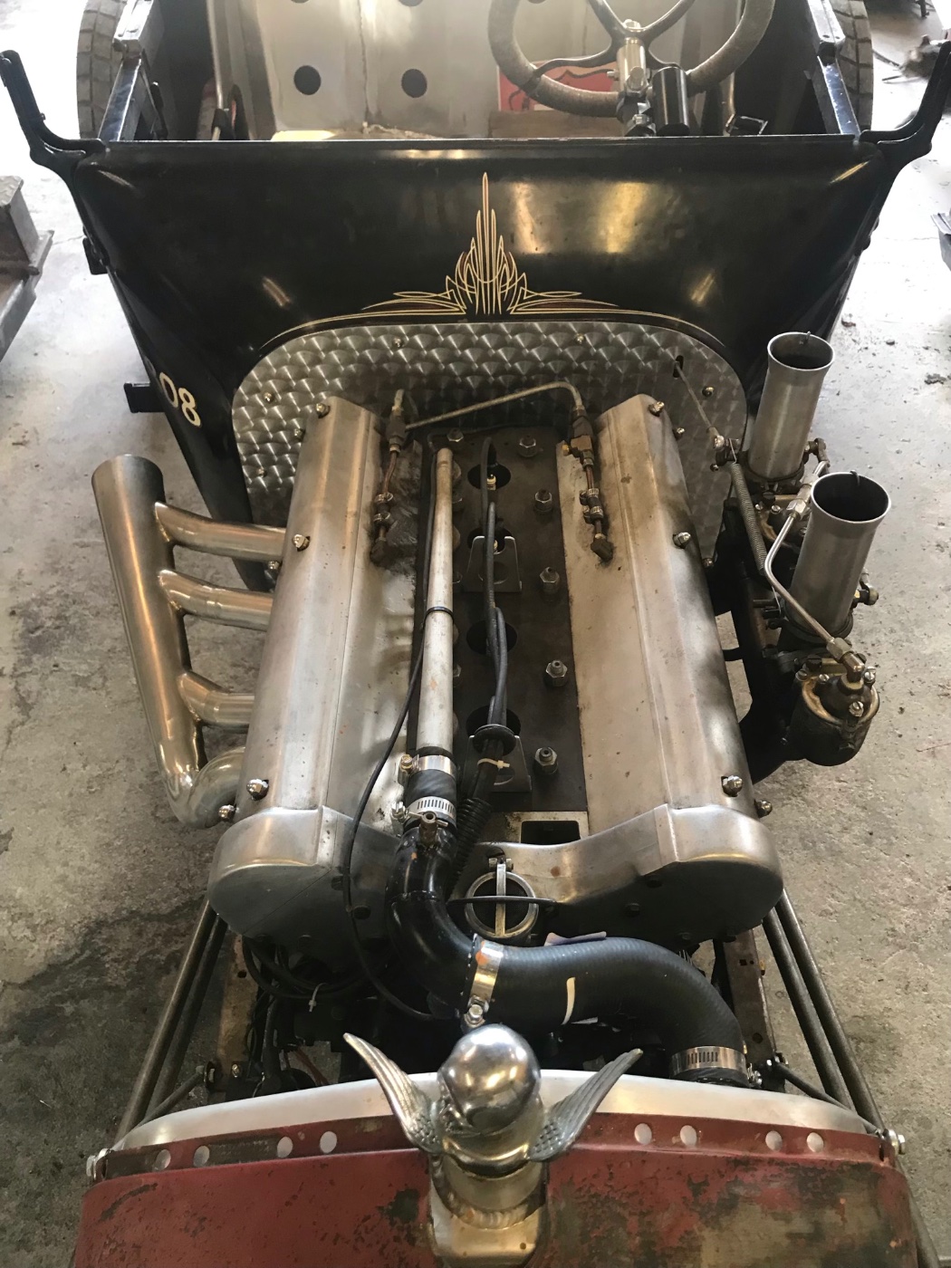

Re: Gallivan Update
Post by Erik Barrett » Mon Nov 13, 2023 4:26 pm
Here is our Gallivan/Rajo powered T race car. Uncut B crankshaft.
If there are any others being actively raced, I would like to see them and race them. This one is set up for 1/10 mile sprint, usually on a hill. It’s a white knuckle ride. This is a later head made after Jagersberger took over when Gallivan got into trouble with the government. Turns out he was supposed to be building airplane engines for them. The Hispano Suiza influence on this head is evident.
