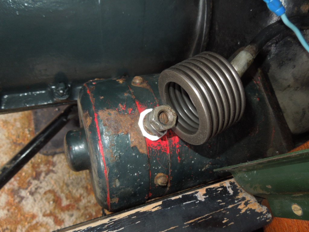

My experience is the opposite to most.
My first T came with a 12v battery and standard starter. People all said carry extra Bendix springs etc.
Car has been 9 years at least on 12v and never broken a bendix spring plus it has a Z head and the compressions are very high, 80 - 90 psi.
Just make sure you set the lever correct every time you start it.
I have recently purchased a 1914 which has a starter and has been 12v for 17 years with no issues. It broke its Bendix last weekend. Its only a 20 minute job to replace.
We have a tourist Model T railcar in the district that volunteers drive on the weekend which is on 12v. Due to untrained drivers historically this broke a bendix spring several times a season. The auto sparkie that used to replace these all the time fitted a bendix spring on top of the starter to reduce the load from the 12v coming in and it has NEVER broken a bendix spring for years so I believe this method works.
I have now fitted a bendix to the top of my both of my 12v cars.
Its a real simple job to fit.
I have never carried a spare bendix spring in any of my T's.

- Posts: 5246
Re: 12v battery for 6V equipment
You have been lucky.
That bendix spring atop the starter doesnt limit the engagement bang.
It will lower the cranking speed.
Exactly opposite what is needed for a 12V battery on a T starter.
