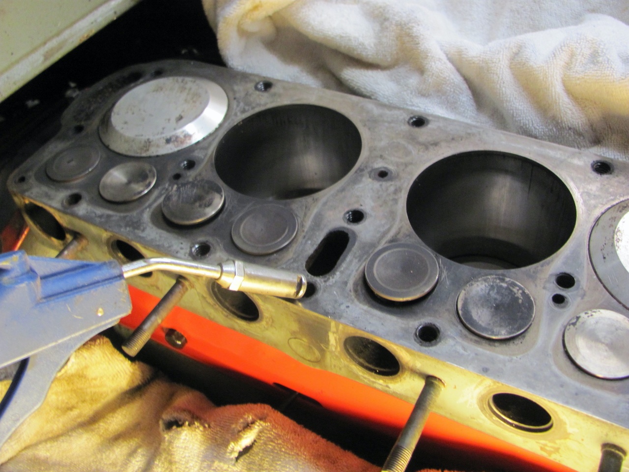

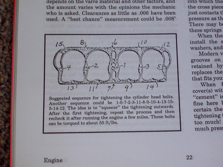

Folks torque in their own sequence. As long as you spread the sequence in a balanced way across from eachother and staggered, it should be alright. Here is one sequence. Use the same sequence when loosening or tightening. As you remove the bolts, blow the holes out with the head in place so the debris does not get in the cylinders and clean the threads with a wire brush. You may want to dislodge the hard compressed debris in the bottom of the holes with an ice pick, if necessary. Jim Patrick

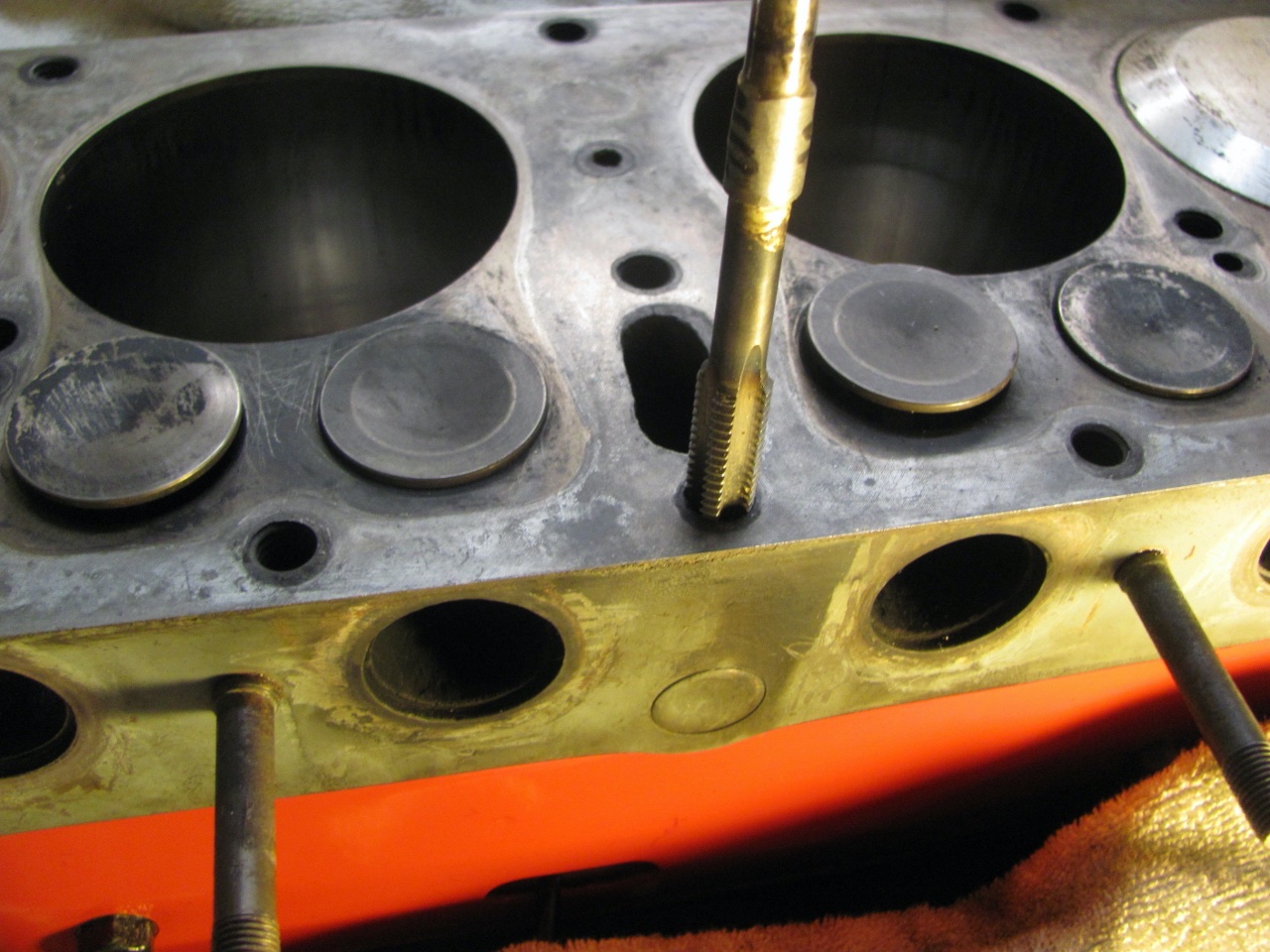

You need to use this tool to properly clean out the block threads !

The photo of the tool I posted is not a bottoming tap - it's made exclusively for cleaning threads - not re-tapping ! Available at an engine machine tooling company.

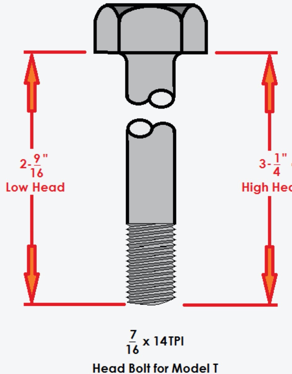

What are the specs on the thread clean out tool. I’m in Hawaii and there is no place to carry a bolt in to buy one so I do have to order from the net. I tried to look through the forum and Google but have not found the bolt thread count anywhere?

Head bolt sizes.
Caution on using a bottom tap or thread cleaning tap with the cylinder head still in place. As you withdraw the tap, debris can fall free back into the hole when pulling up through the cylinder head holes. The debris may still remain as you have to blow out the residues at the bottom of the block hole.
