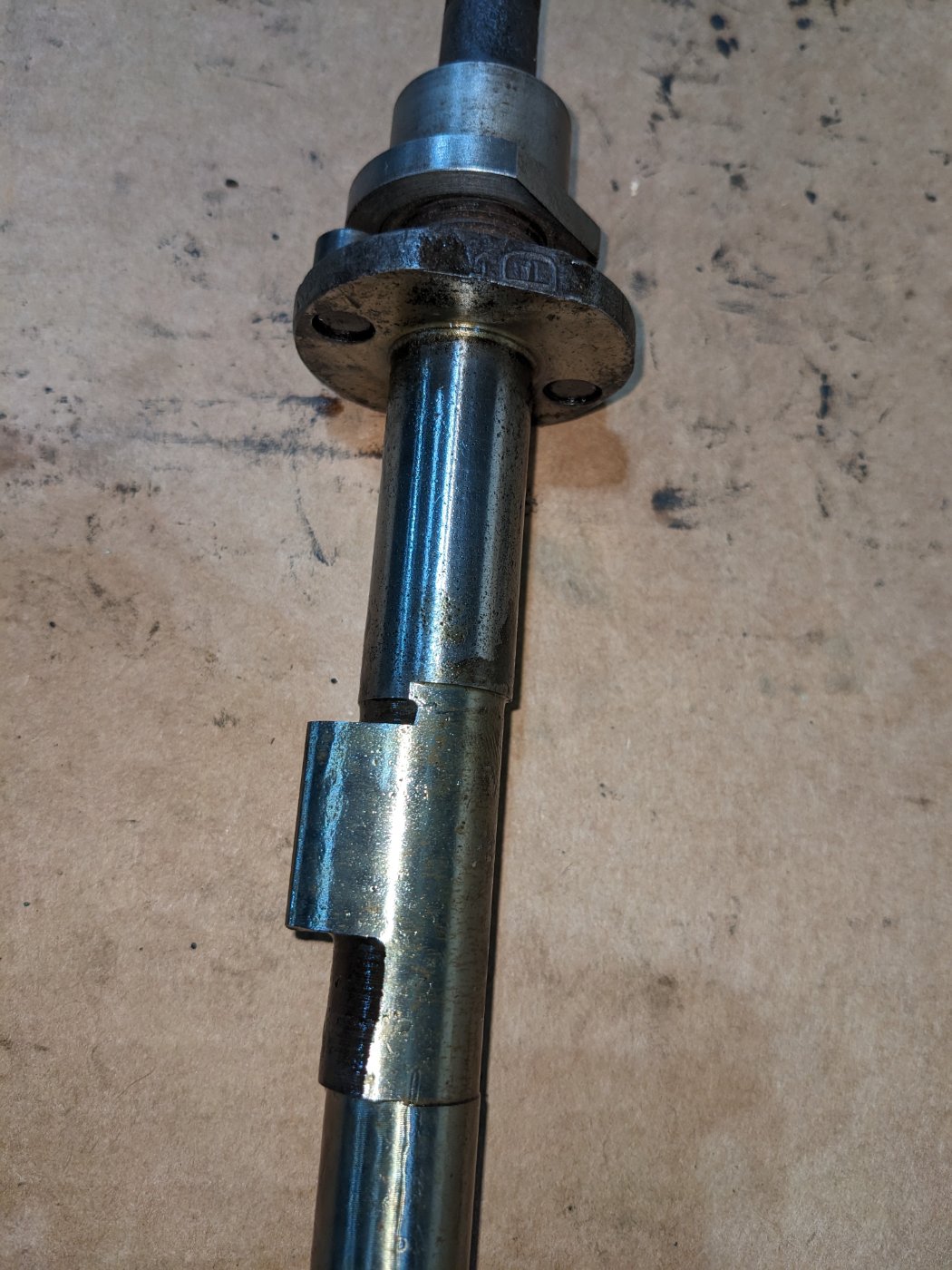

• It was ground from an early cam with short front lobe,
• Lobe heels were ground below the shaft O.D. requiring a thrust kit,
• Lobe lift is .290,

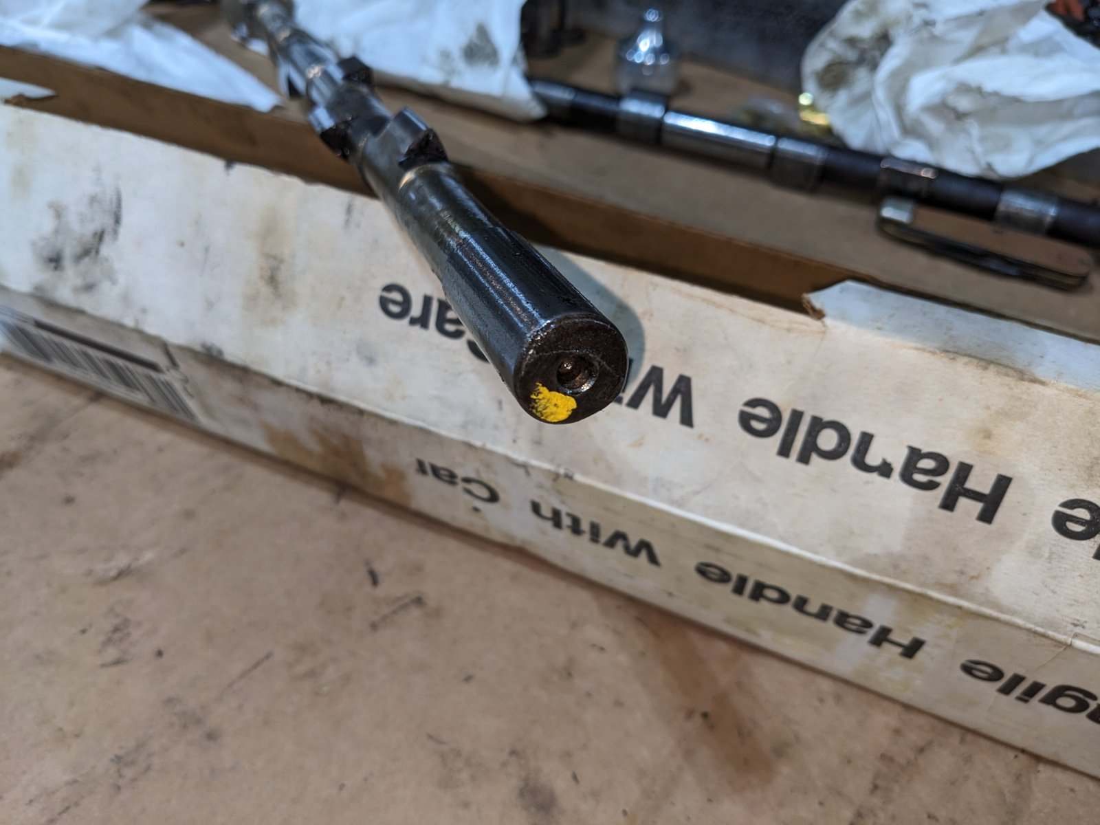

• There is a dab of yellow paint on the rear end,

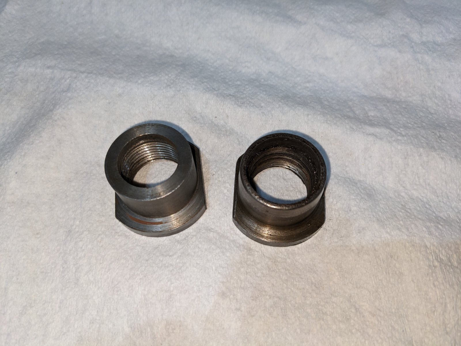

• It came with a machined cam nut (fillet omitted for thrust washers) that appears to be made for the cam and not a modified original. The I.D. at the front of the nut is smaller than stock. That means the wall at the opening of the cam nut is thicker than stock and the I.D. is smaller than the nut’s thread O.D.

No, Craig. The threads are like any other cam. The machined cam nut on the left was machined to size but not completely deburred. It was purpose-made for this cam.

I don’t know who reground the cam but am with Craig in thinking that it was done for a specific configuration. That cam nut is set up for a mag cross drive gear or maybe a distributor drive gear.

There was guy from Texas, not Texas T, who sold cams with 290 lift. It was undercut between lobes just as pictured. This was about 20 years ago. He set up at Chickasha between Bill Barth and Potter, McLaren.

This is interesting. I have another cam nut coming as part of the thrust kit. I'll have to put them together and measure the differences.

Is it possible that nut was made for a different modern seal ? As aside note has anyone concidered milling & plugging a early front cam bearing
