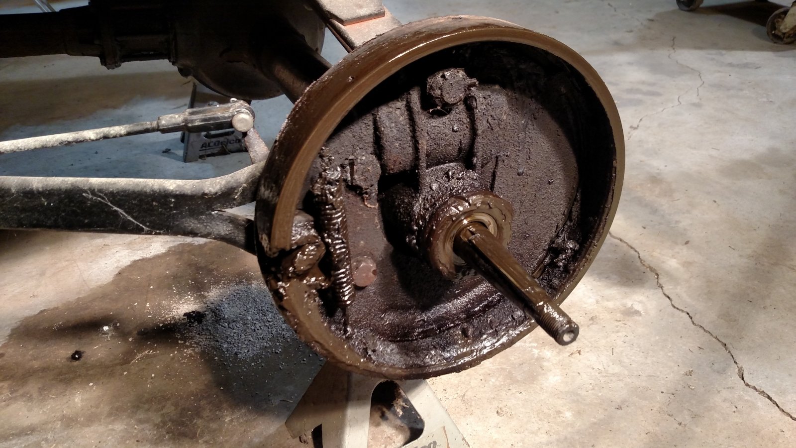

New arrival so no previous rear end history- 1914 small drum.
A couple of weeks ago I removed the rear bearings and repacked. I also removed the axle sleeve, cleaned it all out and fitted a modern inner seal. I used a new felt axle cap washer from a packet stating "axle cap washer" plus new steel washer and new metal cap.
Driven approx 30 miles.
I noticed heaps of gunk running out of the rear brake drum on one side.
Pulled apart to find everything soaked in oil more then grease?
I also discovered the felt washers center hole is too big for the axles hence it didn't seal. That I cant rectify but I am confused as to why the bearing and brake drum etc is covered in a slightly thick oil and no grease to be found anywhere.
Question - does the grease turn to oil when it isn't sealed in the cavity correctly?
I dont know what oil is in the diff (I just checked the level) but I did fit a new inner seal. Is it possible the diff has a light oil in it and this has run up the axles and diluted the grease in the bearing and pushed it out through the poor fitting felt washer?
Your thoughts?

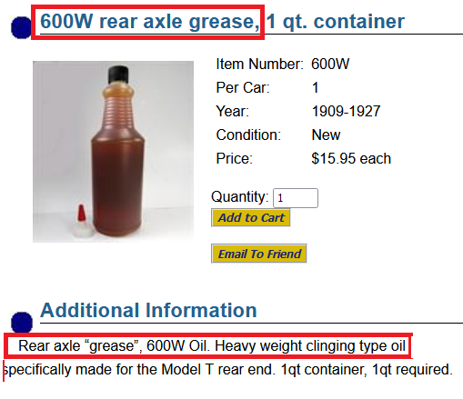

Matter of semantics - when is oil called grease - You may have the right stuff
"Rear axle fluid " that suppliers sell for Model T's

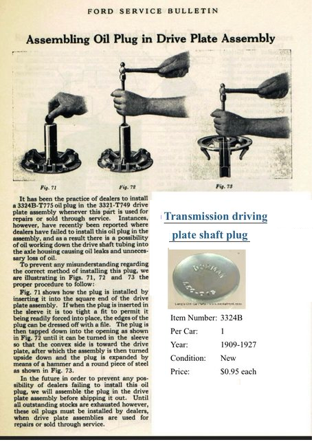

Sometimes, over the years, if the drive plate and driveshaft bushings are worn, oil from the crankcase can leak past the fourth bearing at the tail end of the engine and migrate to the differential through the drive shaft pipe connecting the rear end with the engine, thus, thinning out the rear end gear oil. If the thick gear oil gets thin enough, it has no trouble getting past the pumpkin seals and out through the axle shafts. Jim Patrick

Thanks Frank, I have never seen a seal in the position on any of my cars so I will put them on (I have a heap of them) when I remove the wheels to fit the correct new seals.
Yes I used 600w grease, exactly the same as the pic posted.

It sounds like oil is seeping passed the fourth main. Check the amount of grease at the universal. I have found that packing this will help to keep oil from going down the torque tube.

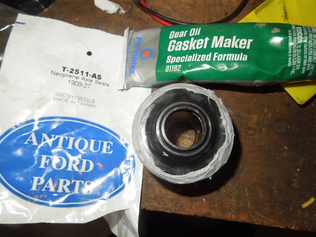

Re: Rear axles bearing grease looks like oil
"I think I got the inner seal from Macs a few years ago, modern style."
Seal failure:
In order for a modern lip seal to work, the shaft must be smooth & pit free. You would have had to get a view of the surface where the seal rides.
Depending on what was used previous, one can expect pitting @ a minimum & a horribly chewed surface from the leather with finger washer tensioner.
If yo used the black neoprene type seal that looks like a ahmash hat, The seal surface is about 1/2" wide. These seals will grab onto the axle shaft & destroy themselves.
Either way, Pull the bearings & inspect the seals. See if they are still functional.

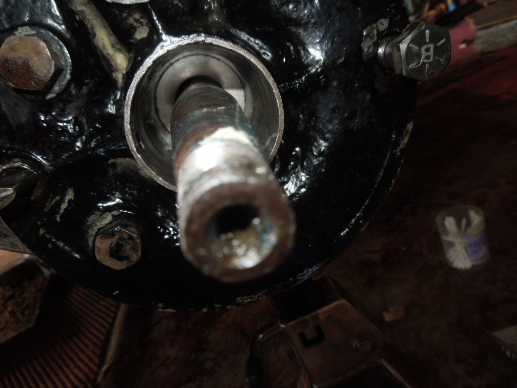

Kevin, your comment earlier that the felt seal hole was too big for the axle shaft probably indicates that the felt you installed was the one that goes in the relief in the hub.
Sometimes the shoulder in the hub that retains this felt is so worn/damaged that it almost seems insignificant and its purpose is overlooked.

John, there was no existing inner seals in place before I fitted the ahmash hat as you call it. But these new seals have only been in for 2 weeks and hardly any miles, Maybe the oil from the diff has got around the outside edge of the seal.

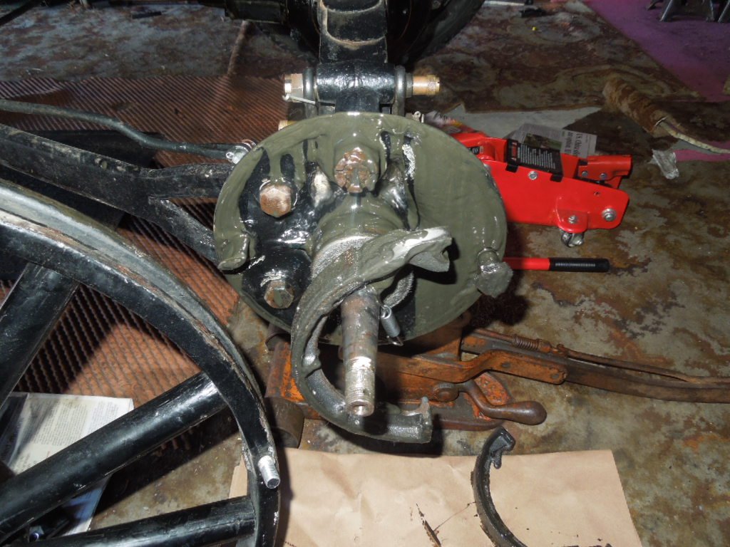

On an interesting note I removed the other side wheel also yesterday because I had also fitted the large centre hole felt on that side and there was no signs of any leakage coming through from the diff past the seal. The outer bearing showed oily signs so I cleaned that and greased it up plus I changed that axle seal out for a second hand tight fit in the meantime also.
I looked at the sucked out diff oil/grease again just now after it has settled over night and its clean and consistent. This would indicate there is no engine oil leaking into the diff unless its settled at the bottom of the diff head where my suction pipe couldn't reach.

- Posts: 5130
The right side gets more oil flinging & churning from the gear teeth. The left side carrier is being pushed against the thrust washer pack, allowing a minimum of lube to get past.
Check those inner seals & see if they are still intact. It doesnt take many miles to fail.
Think about it.
If the inner seal was doing its job, there would be no leaks, even when overfilled.
I am fairly confident you will find the seal shredded or de-laminated from its backing washer.

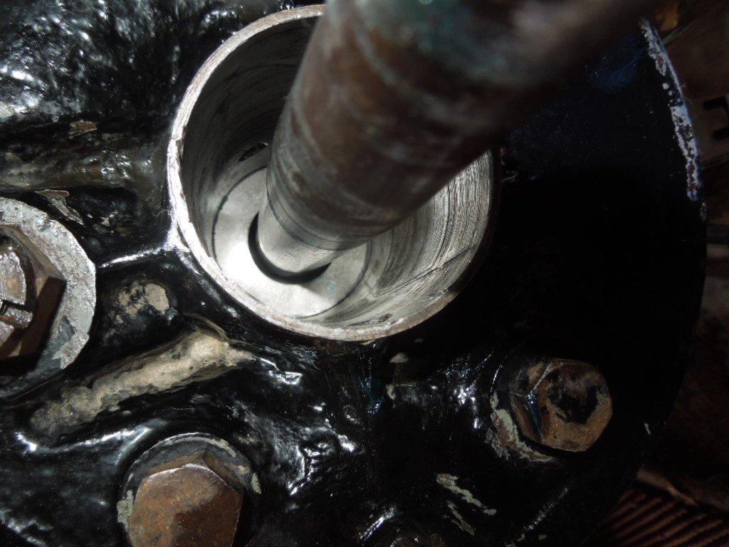

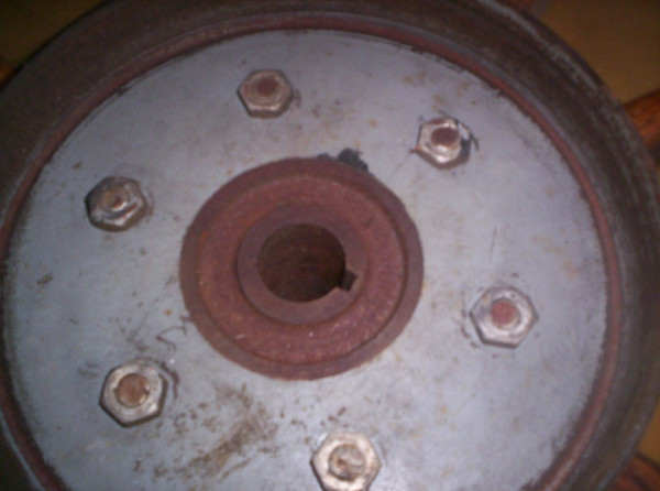

Kevin
Look at this hub and you can see the groove where the second outer felt seal goes. Soak it with just enough oil to hold it in place. This is the outer axle housing cap and the felt protects this cap from being rubbed raw by the hub. Too many people forget to install

Looks like I have it beaten.
I read that applying a sealant to the inner face of the outer edge of the modern neoprene style seals (that fit inside the rear wheel bearing) can stop the leakage getting past.
So I done that, pushed them in firm, then inserted the wheel bearings to hold the axles in a central position and left it for 48 hours to set before reassembly.
So far so good, its been about a week and about 50 miles with no visible sign. I will confirm it when I removed the drums to install the new felt washers when they arrive.

What does everyone think of the modern outer seals that replace the old outer axle caps? I have the aluminium machined ones that have o rings to fit on the axle casing and with a neoprene seal to fit to the axle.
- Posts: 7133
I like the alloy machined seal caps with the O ring and modern lip seal on the axle. However, it is vital that the section of axle that the lip seal runs on is not damaged in any way, or the seal will not last long.

Well that didn't work.
Removed the wheel after a bad leak and look what I found.
Looks like the axle might be bent (check the video), do you think this would promote the leak?
https://www.youtube.com/watch?v=u-PBQ3ZDlfo
[attachment=0]DSCN4581.JPG[/attachment]
- Posts: 7133
Kevin, most of the run-out in the axle is in the threaded end, and is not likely a contributor to the oil leak. tThe colour and consistency of the leaking fluid is way off. It looks very likely you are getting engine oil in the mix. I would be checking the contents of the universal joint ball housing.
Mark Nunn
- Posts: 1287
- Last Name: Nunn
- Location: Bennington, NE
I scooped about a quarter pound of grease out of this brake shoe. It doesn't look like that anymore, having done a proper rebuild.
- Posts: 5130
Hard to tell for sure from the picture, but the cup doesnt look on all the way.
It takes a BFH to compress the felt seal & get the cup on all the way.
When you re-attend to it, pull the bearing & insure your inner seal is still in tact.
- Posts: 6542
In agreement with Allen. You may be missing the plugAllan wrote: ↑Tue Dec 05, 2023 6:45 amKevin, most of the run-out in the axle is in the threaded end, and is not likely a contributor to the oil leak. tThe colour and consistency of the leaking fluid is way off. It looks very likely you are getting engine oil in the mix. I would be checking the contents of the universal joint ball housing.
- Posts: 5471
Well, that's a mess ! Couple of pointers from casual observation - your rear shackles should be installed with the inside twist oiler on top and the rear on the bottom - opposite of they are now for ease of oiling (still have to get under the car to get the inside one !) & when installing the brake shoes, attach the springs with the hook from the inside to assist in holding the shoes towards the backing plate - just suggestions.

- Posts: 5130
If the output plate plug is missing, the plate needs removing. 6 bolts. @ the very least, the motor/trans has to be lifted off the crank case a bit.
The easier to repair is a sloppy 4th main. Replace. .0015-.002" clearance.
If you have a transmission screen, it concentrates on the 4th main. It can be turned 180 degrees to limit some of the concentrated oil.
