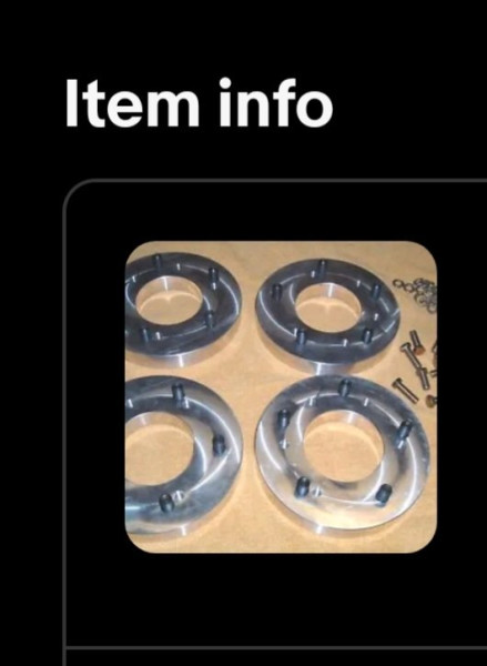

I have a Set of A wire to T hubs I am not going to use.
Here is their pic from where I purchased them from ebay last year.

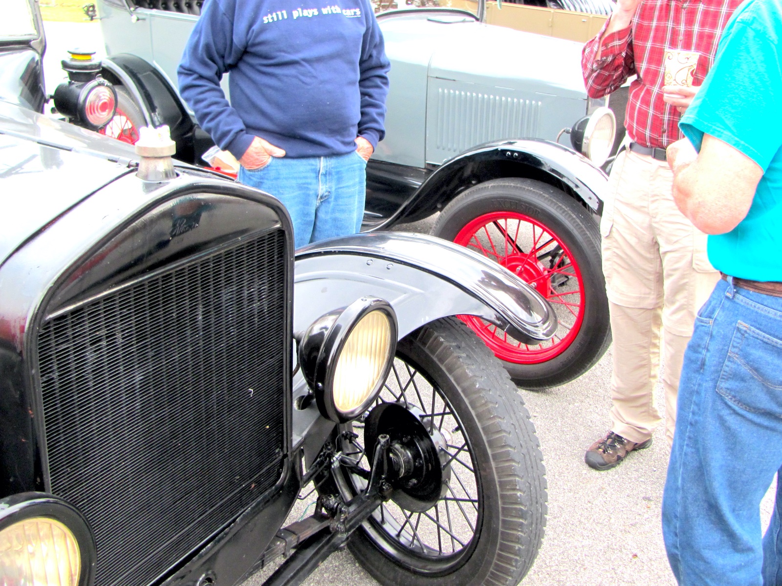

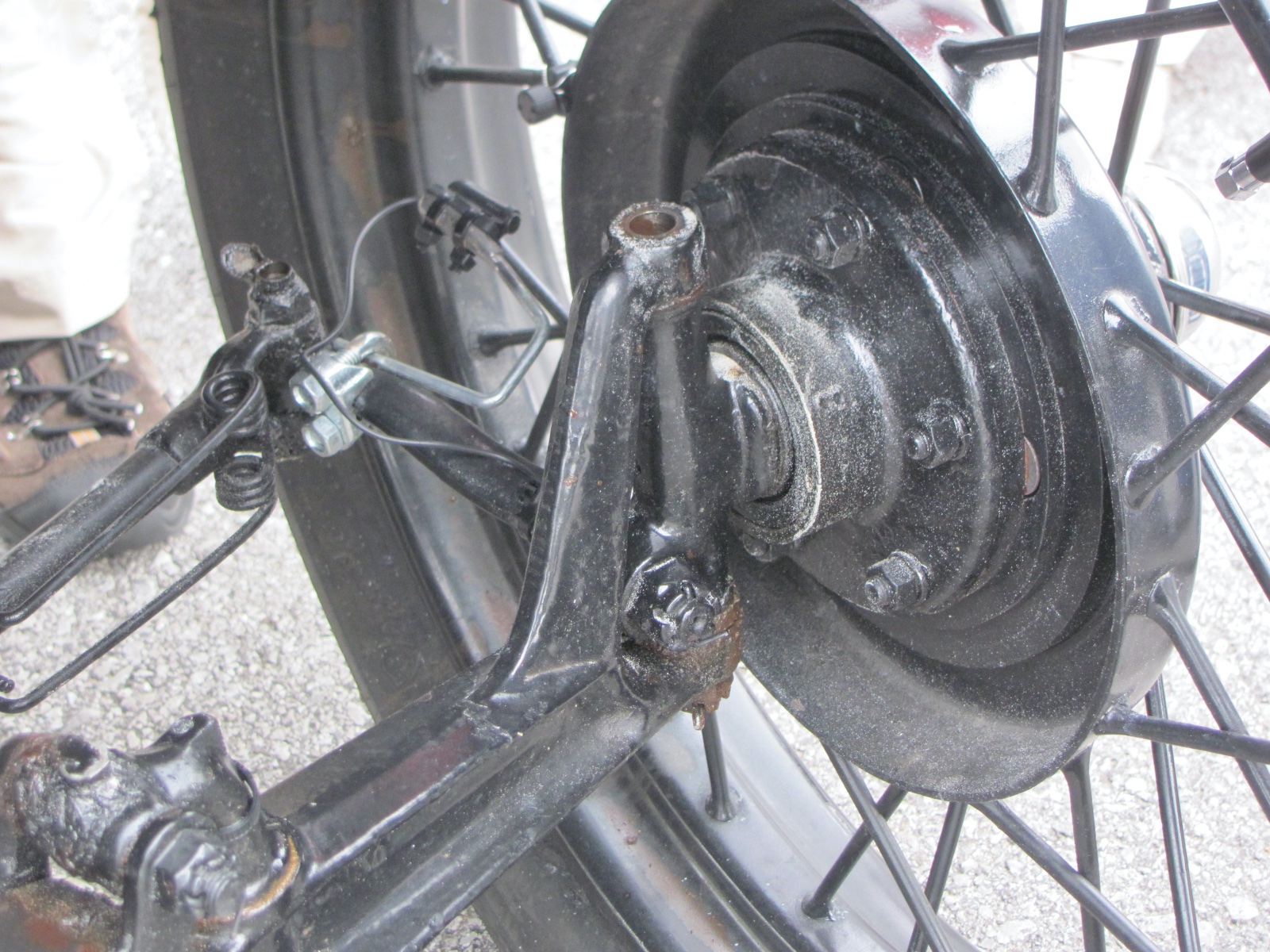

Just a bit of info on adapters for wire wheels. Am believer that Ford engineered the front wire wheels for lateral support with the correct mating hubs.
Model T front hub with long snout and the mating taper 'Dixie cup' like cone of the T wire wheels.
And Model A front hub with brakes, for the Model A wire wheels for contact at the drum and and snout of that hub.
Examined causally this Model T in the foreground on tour a few years ago, my grey touring with red Model T wheels and front hubs in the background.
What I thought was missing oiler for the spindle bolt on this T, was surprised and told the owner, he has a problem.
Closer examination showed his wheels to be Model A with spacers, on the Model T spindle. IMO, suspect the lateral load is too great with offset of the wheel and the lack of support at the end of a wood wheel hub.
The king pin bolt head and about 1" or so below was gone, vibrated away. Only the threaded lower end of the king pin remained in the spindle body, which fortunately could be removed easily for fix.
Lucky to find this out, and brief road repair was made by the owner fitting a longer bolt found at hardware store up the street until proper king pin could be fitted.
Engineer carefully changes, most instances hard to improve on Henry's design.

Looking at the close up of the A wheels on the T he’s using the spring anti vibration old accessory to “tighten things up in the front end” ! Nice paint job but front end needs attention under the paint? I have to say though my cars aren’t perfect either. Just wanted to bring out the accessory “ tightener upper” in the photo.

where much cheaper than T wires.) The two sets of adaptors I have where $450 & $275 New. The most I have ever paid
for a A wheel is $30. Yes they don't look as good as T wires but then T wires don't look as good as Buffalos. And you can't
tell the difference going down the road which is what I prefer to do with mine.

I have 2 each for sale on the classified parts $120.00 with shipping. You would be lucking to find just the material (USA made) for that price today not to include the hardware.
Just Sayin'

Any Ford 21" welded spoke wire wheel will eventually crack around the lug bolt holes if the hub does not support the wheel shell out near the outer bearing. Unsupported, the area around the lugs is constantly being flexed and will develop fatigue cracks. Further, although powdercoating a wheel looks good and is inexpensive, it tends to hide cracks when they do develop .

Henry I would have bought them but your add says model t wood to wire
I need model t wood to model a wire
