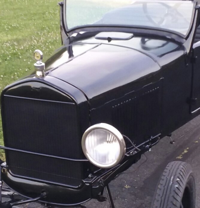

Too shinny and undercarriage makes a Model T look over restored. Many suggestions have been a satin finish or maybe semi-gloss but not flat black.
If you trying to make a period looking speedster, that's not intended to be in a museum, don't make it too glosy. A friend of mine that has a Model A high boy that I want really bad is black primer. His logic is that when teenagers were building these hot rods & had a few extra bucks would they spend it on paint or performance accessory.
