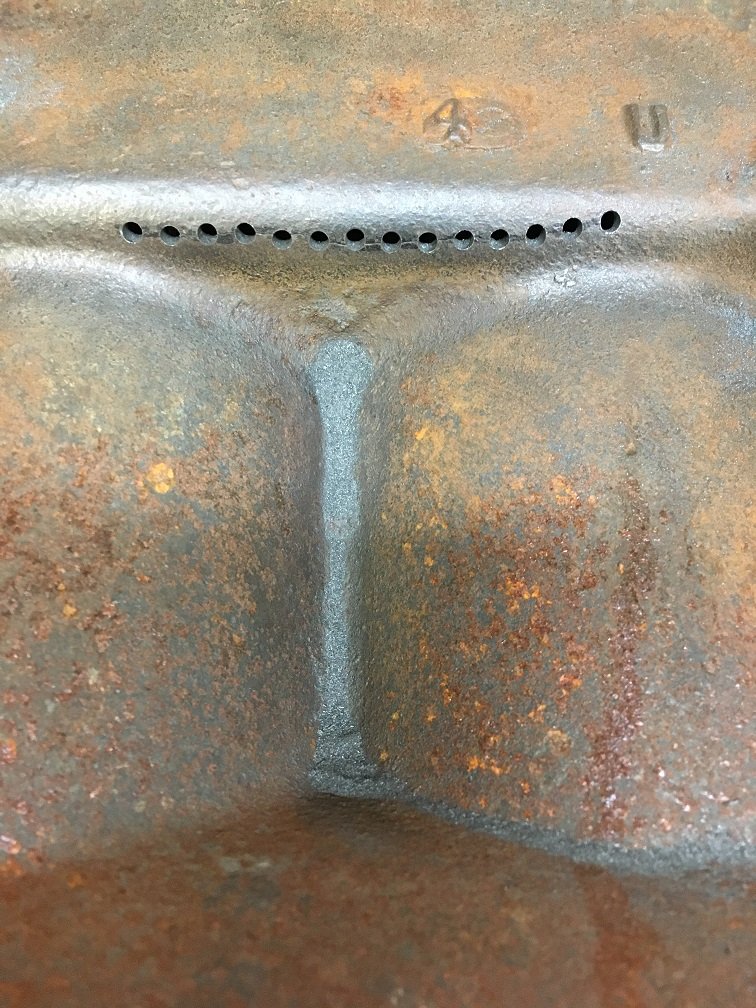

Here is the nickel tour of using the Lock-N-Stitch pins to fix a crack as I have done it. I am not an expert and will welcome any tips or corrections from those who are better experienced.
First drill a series of holes along the length of the crack using the Lock-N-Stitch spacer. This first set of holes are for every other pin. Next counter sink part way into the holes to provide a shoulder for the pin to snug up against. Then tap the holes. Screw a stitching pin into every other hole and supply enough torque to twist off top of the pin. Here you have to be careful because if the cast iron is too thin where the crack is you likely won’t have enough threads engaged with the pin to withstand the torquing and you’ll end up stripping the threads. If that scenario seems like what you’ll be up against, snug the pins as much as you dare and then use a small cutting wheel to cut off the upper part of the pin. Now insert pins into the leftover holes. Grind the top of the pins close to the surface of the cast iron, but not all the way. You want some material for peening later.
Now start the process over by drilling, counter sinking, tapping, and inserting pins in all the spaces between the first set of holes. This is where the overlapping process of the repair takes place. Grind the new pins as before and peen the whole length of the repair to squish the top of the pins against the surface. Finally grind what is left down to the cast iron to smooth out the repair. A pressure test is always a good idea when you are done for peace of mind.
Here are a few pictures to help visualize the process. They show the first set of pins being installed.
Rich C.
