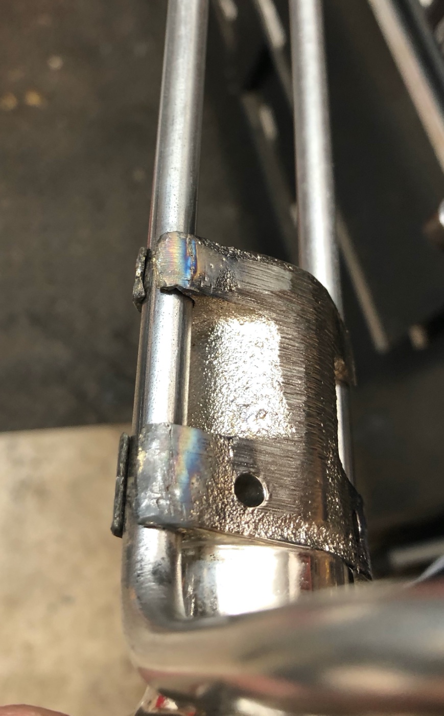

I have to replace the steering gearbox and I've pulled the gearbox from the steering column, but is there a specific way of removing the rods from the gearbox?
I'm guessing it's just heating it up and prying them open, but just want to make sure before I ruin anything (although I'm not sure the gearbox is usable to anyone else)
For some reason the steering in my gearbox doesn't have a pin guide

CW, The bronze material of these gearboxes has a very low work-hardening limit. Once annealed, it can be stretched about 15% before breakage can occur. I did the same task that you are doing and researched the metallurgy to ensure success. You cannot just heat the casting and pry it open in one step. You have to get it really hot with a torch, let it cool naturally and pry a little bit. Then repeat the process several times until the rods can be removed. Good luck.

The tabs on the gear cluster can be carefully bent back, after annealing the tabs. You only need to open them just enough to remove and install the rods. If you aren't going to re-use the case, the tabs can be bent cold, with a screwdriver tip, but they will fracture.
Heat with torch to dull red, then let cool. Bend back gently. Usually, pulling up on the rods will open the tabs enough. After the new cluster is re-nickeled, repeat the process to allow the tabs to be closed back over the rods.
Here is install after dull red heat, and cooling. Note the discolor of the new nickel plate when the tabs were heated to anneal for folding back on the rods.
