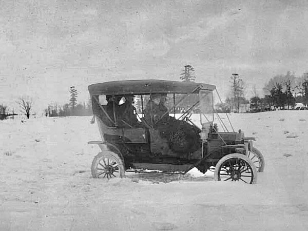

The cars were quite shiny when new, but didn't stay shiny for long. Here is are some old threads on the subject:

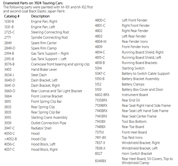

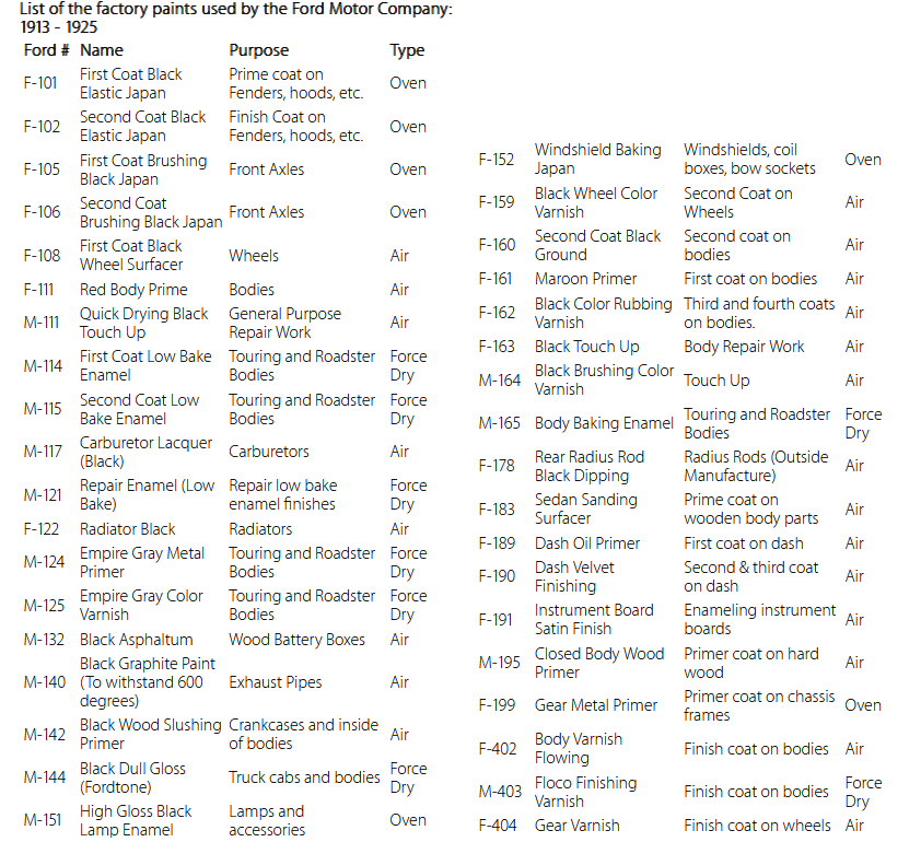

MANY years ago, an MTFCA member by the name of Reid Welsh did an exhaustive study to find the ingredients of actual Ford Gilsonite. There were many posts by him on that subject. He actually produced several batches and used it to paint his 1922 Coupe.
From what I can remember, it was a mixture based primarily on petroleum. Mainly tar, and was applied by "Flow Process" through a nozzle starting at the top of the body and flowing down to the rocker panel area. This was done by a man on each side of the body as the body moved down the production line. The paint was allowed to run down the sides of the body and run off the bottom. It was then allowed to drip into catch pans and ran back through the system to be used again. This process was used on the body only. All other parts were dipped into a tank of water on the production line, with a layer of paint on the top. As the parts were carried through the tank, it would be drawn up from the water through the paint, thus sheeting the water off with the paint.
The painting process was the most time-consuming operation in automobile production. Before this process was developed, the paint used for automobile body production was more of a pigmented varnish that had to be brushed on in layers. A coat was applied, allowed to dry, sanded, then coated again, and so on.
With the advent of the automobile paint baking oven, invented by John Dodge of the Dodge Brothers, the time to paint an automobile went from hours to minutes. One little problem. Gilsonite apparently only came in black due to the pigment used in the making of Gilsonite. The pigment was lamp black.
With the introduction of quick drying lacquer, cars were then offered in a choice of colors.
If you were already aware of this process, please excuse my refresher, and if I am in error about anything I've posted here, I invite your corrections.

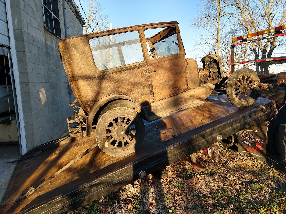

Here is a photo of my 27 Tudor the day I pulled it out of a warehouse. Note the streaking of the original paint and rust lines. Seeing this at first I wondered how someone would have painted the car. This forum has images of how it was done: using sprayers that wiped/sloshed/smeared the paint on.
I guess the original paint didn't take long to lose the glossy finish due to poor quality chemistry. Tar doesn't stay shiny for long.

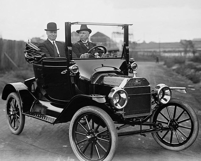

Here’s a shiny one from Tom Rootleb’s (Dollisdad) photos. Note the reflection of the rear fender on the side. Probably brand new. It didn’t take long for the gloss to disappear when parked out in the harsh elements, but they did look good for a short time. Jim Patrick

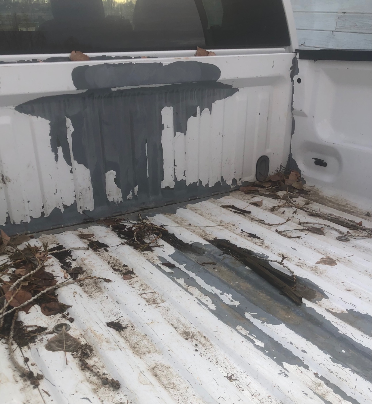

I remember guys getting shiny $99 Earl Schieb paint jobs on their cars back in High School. You were king for a few months before the paint faded out to no gloss mess. Cheap paint then, cheap paint now gets the same long term results I figure. It would be interesting to get some Ford formula Japan Black enamel and apply to a panel, and set it outside to document the weathering and fading timeline to estimate how long Ts went from showroom shine to dull appearance.

A most interesting , very detailed, investigation to Model T paint & what was used where. https://www.fordmodelt.net/m/p-r.htm
CONCLUSIONS (of facts presented from the study)
There are four main conclusions to be drawn from this investigation. First, the paints used on Model T's during the black era years of 1914 to 1925 were really color varnishes. These types of paint bear little resemblance to the modern automotive finishes used today when restoring a Model T.
Second, over 30 different types of black paint were used at the same time to paint Model T's. The different types of paint vary according to the means of drying them (air versus oven drying) and were also formulated to satisfy the different means of applying the paint to the different parts.
Third, Model T's during the black era were painted using the techniques of brushing, dipping or flowing the paint on. Paint spraying equipment for finishes did not come into widespread used in the Ford factories until 1926.
