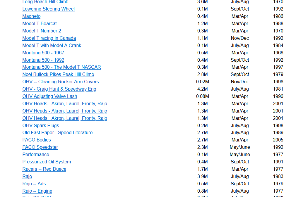

Take a look at these sites you'll need to browse around a lot.
North West Vintage Speedsters
https://www.nwvs.org/Technical/MTFCA/MT ... cles.shtml
just a sample of the index These are different
https://www.nwvs.org/Technical/MTFCA/Ar ... edster.pdf
Tulsa Model T Club
https://mtfctulsa.com/Tech/
Tulsa Model T Club
