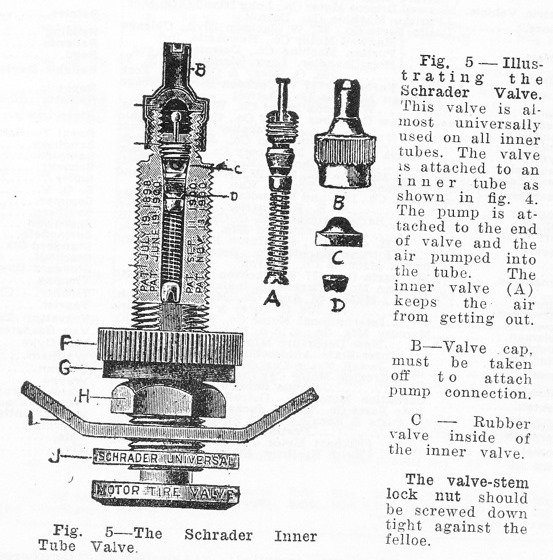

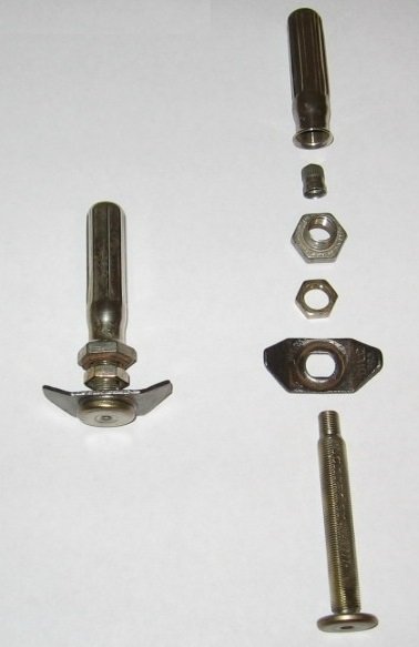

There is another nut, called a rim nut. The valve dust cover screws onto the top of the rim nut. Originals are stamped from sheet metal and have a leather washer on the bottom so that they don't scratch the rim. Older cars came with round, knurled nuts. Later cars came with hex shaped rim nuts.
Current reproductions are solid and come with a rubber washer.
