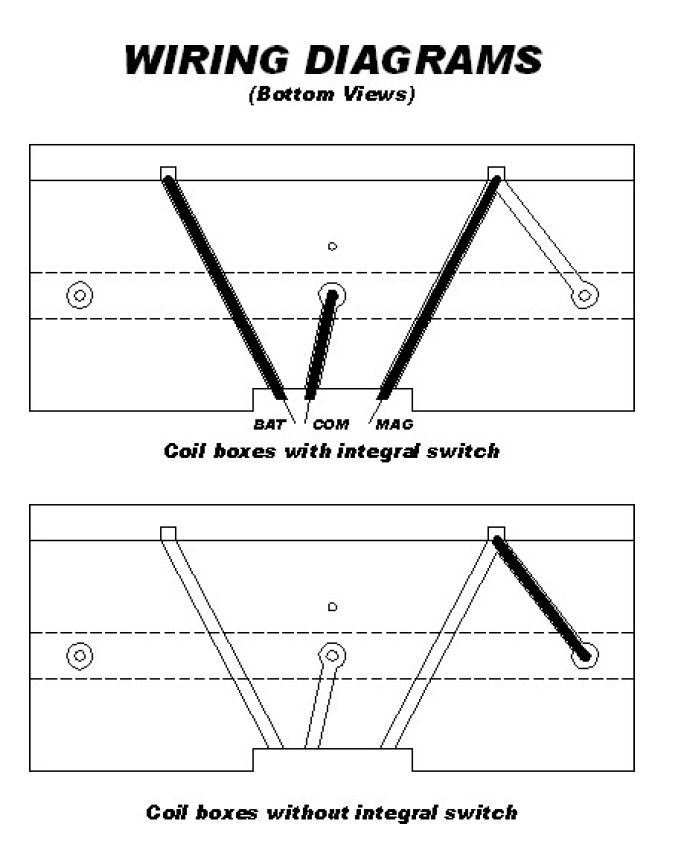

Got another question if you all don’t mind. I’ve decided to rebuild the coil box. The wood and contacts looked to be in decent shape but I pulled it out and found that the board had a decent bow to it. This is probably the reason the previous owner jammed so many wooden shims in between the box and coils. I ordered the full rebuild kit and I have been reading through previous posts discussing a coil box rebuild. I came across a post that talked about soldering the contacts to the carriage bolts. I understand the reasoning, but I am just wondering if this was done by Ford as well. I’m also wondering if there should be any concern of annealing the contacts. I doubt the bronze will get hot enough to do so, but just wanted to get some opinions on doing it this way. The box that was in my car did not have soldered contacts.
Other than that, I’m making progress. My coils and carburetor are out for rebuild. I have plenty of parts on the way to hopefully get this thing running. I’m still hoping to find some used tires just because new will stand out like a sore thumb on this vehicle, but I’ve still got plenty to do before I’ll need roadworthy tires on it anyways. Thanks!
1918 is no-man's land for coil box styles (plus people change things overtime)- is the ignition switch on the box or the dash?
If you ordered the wood rebuild kit you might be able to return it for the Waterproof kit plus the individual parts needed (like in the wood kit).
As another option you would need to waterproof the wood with a penetrating sealant. We all have our preferences - I use Minwax Wood Harndner. You'll see the first coat or two get sucked into the wood.
You do need to solder the wire to the bottom and the carriage bolt for voltage input. Soldering to the other carriage bolts has it pros & cons. While it gives a better contact it also helps spinning the bolt in the contact for those who over-tighten the nut over the porcelain & for those that didn't wrench hold that nut when tightening the nut over the wire. Con - need to just get a little solder over the cap of the bolt making sure that you don't get anything on the tongue of the contact to affect its spring
The wire the runs under the bottom plate fits into a groove. Originals had an strip of insulator over it, you can silicon fill it or waterproof tape it
The diagram is looking at the underside of the wood showing the wires.
