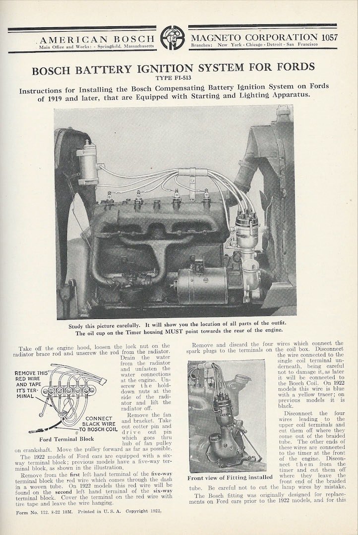

Hello,
I have a 26 engine that has an original Bosch front plate 448 distributor. The car has always been very hard to start and I am trying to verify the basics. Could someone confirm install instructions on an original Bosch 448? I currently have TDC identified, points are open but the rotor is pointing to the passenger side fender. I read the rotor should point to the #1 cylinder. Also, this distributor has a thumb screw on the opposite side of the coil wire. Is this intended to have a ground wire or strap attached?
Thanks!
Posts: 6586
Re: Bosch type 448 distributor set up
Post by TRDxB2 » Sat Dec 09, 2023 2:02 pm
Think the pages may b in reverse order
1923boschmaginstmanual.pdf
(419.76 KiB) Downloaded 83 times
Post by Fisher400 » Sat Dec 09, 2023 2:09 pm
That’s great, thanks for the doc!

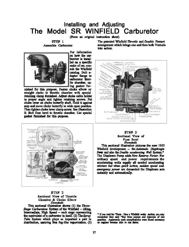

Instructions were great, set up as described and added the ground wire as instructed. It did start, but I am having a rpm surging at idle. I am running a Winfield sr downdraft. Any thoughts on the source of this? Intake gasket and carb gasket have been replaced…
Posts: 6586
Post by TRDxB2 » Sat Dec 09, 2023 5:43 pm
Fisher400 wrote:
Sat Dec 09, 2023 3:31 pm
Instructions in the PDF first page below
2104WinfieldSR.pdf
(374.83 KiB) Downloaded 51 times
Think this Winfield
