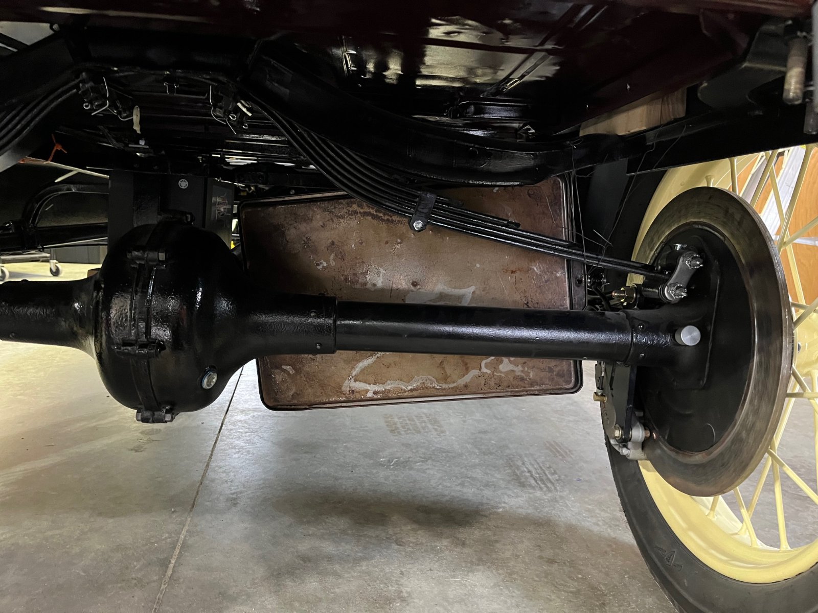

As Criag Leach recommend in the original post, I purchased a laser thermometer and have taken a number of readings after a 20 mile run. During the run, I never applied the brake pedal. As shown in the photo, I installed a shield between the end of the muffler and the axle.
Left Disc Rotor -- Left Emergency Brake Drum -- Pumpkin Right Disc Rotor -- Right Brake Drum
Prior to Run ==== 62F --- 60F --- 60F --- 62F --- 60F
After Run ==== 128F --- 120F --- 179F --- 120F --- 126F
Note: The temperature of the axle shaft, between the pumpkin and the wheel, did not increase significantly, nor did the outside of the disc calibers.
I plan on making another 20 mile run and check the temperatures again.

I think you're OK on the brake rotors. Very slight drag is normal. Be sure rotors don't wobble, since that will increase drag. Both the rear axle and brakes will probably pick up some engine heat.

What is that large rectangular thing in front of your rear axle, where I would expect to see a cylindrical silencer??

Chris, that looks like he’s using a cookie sheet to keep the exhaust off the rear end for his temperature test.

Chris, I installed the sheet to keep the exhaust off of the pumpkin as Andy indicated.

How is the exhaust inside the car? That pan behind the muffler looks like it would direct the exhaust through the floorboards into the car?

The pumpkin will normally generate heat during operation. Some is from mechanical friction, and some is from fluid friction in the lubricant. Higher speeds will produce more heat, as will more applied horsepower, but the actual temperature rise will depend on many factors, such as ambient temperature, car speed, wind speed, how much engine heat reaches the axle assembly, type of lubricant, duration of trip, and more. If you're worried about excess friction, checking for any indication of abnormal binding when the axle is warmed up fully and listening for any abnormal noises would be a good idea, as would checking the lubricant for excess metal particles. Most axles will show some tiny metal particles in the lube, especially if the axle is new or recently rebuilt.
- Posts: 8664
Re: Has Anyone Experienced This? (UPDATE)
Most disc brakes, and especially older designs, will show a temperature rise when the car is driven, even if the brakes are never applied. Loose wheel bearings, calipers that lack some "float", warped discs, or sticky caliper pistons will increase heat and drag.
A T axle might be expected to have more axle shaft end float than a modern axle, and thus might cause disc brakes to run slightly hotter than normal. More end float might cause a little more pedal travel than normal, but probably would not cause any other issue.
