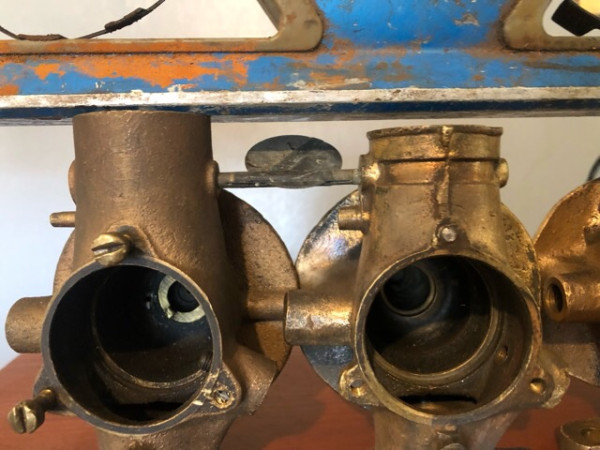

Thanks to Mark Eyre I beleive the attached photo is of the first version of the the early Holly G Carb.
Notice it is shrter in length from later G''s and would explain why my correct choke pull rod is too short for the later G?

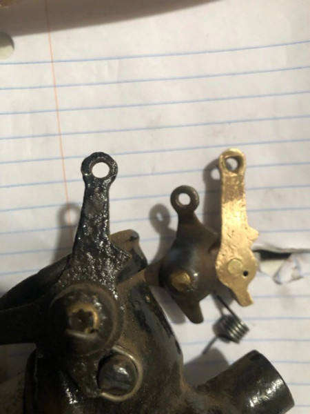

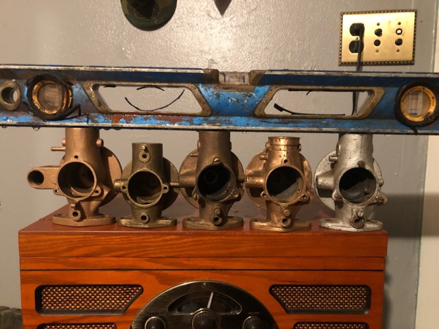

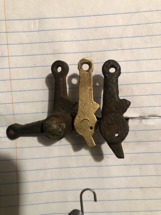

The Holley G you have pictured with the ring around the air horn is a bit shorter. The other brass and cast iron G’s are the same length. These are all the Holleys from 1912-1919.
The choke arms are all the same length.

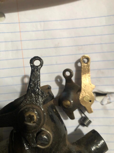

Re: Holly G Carburetors

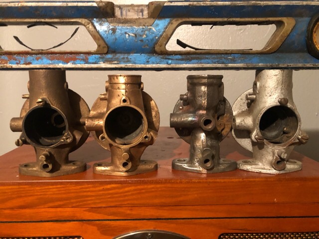

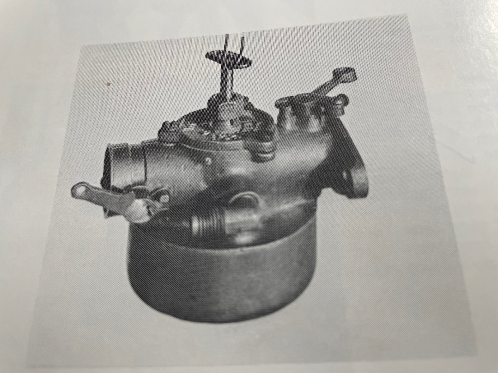

The shorter G is the same length as the NH.
Hard to tell because of the perspective but the long arm NH choke arm is the same length as the G.

Thanks for the photos. Can you tell me the difference in height between the early and later Holly G carb.
The great information you supplid and my discussions with Mark Eyre's and information he brought to my attention shown in Bruce McCalley's book help clearly explains waht was giving me so much trouble with making a choke pull rod for my 1915 Runabout.
Little did I know wha the simple task of making a choke pull rod would lead.
There’s 3/16” difference in height but the choke shafts are in the exact same location.
