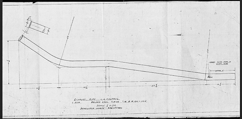

Or, you can make your own to the Ford Print. Image is captured from Benson Ford Research site, under digital documents, free to use. Just search in the search box 'Model T exhaust pipe'.
