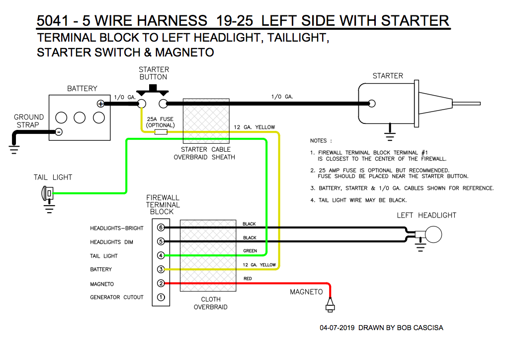

I've had this 1923 touring for eleven years and was aware that it has some of those old reproduction wiring harnesses with mostly wrong colors. But today when I started to install a fuse it dawned on me that all the wires that are supposed to be 12 gauge are actually 16 gauge. Obviously Ford used 12 gauge for a reason, but I'm enough of an electronic dummy to wonder: What is the effect of the undersized wires?

Hap, I'm going by the wiring diagrams from Ron Patterson and Bob Cascisa. They show 12 gauge for the generator, ammeter, and battery wires. That information may not be documented in Ford literature, but I expect it's based on the actual original wiring in a good many cars.

To answer the original question, yes wires are sized to load. The proper loom is not expensive so you should just replace your bad loom. Wrong colors and wire size is a bad combination. Also remember That The fuse is sized to protect the wire, small wire small fuse.

Several years ago, I purchased a show quality wire loom set from Langs. The problem is, it wasn't show quality! The generator wire was one gauge too small. I found an original Ford script loom, and had it copied exactly. Cost me three times the price, but I got it right. They even wove in the Ford script tag.

Steve, the short answer is that whatever the weakest link in the system is will be the hot spot. You want that to be a fuse, not a random spot in the harness. With 16 ga., the only way to accomplish this would be to go to a lower amp rated fuse, at which point you would get a lot of nuisance blows. I'd put new harnesses in. FYI, when I got mine this winter, the vendor's vendor had made a mistake and made the short yellow/black jumper wire on the back of the dash out of 14 ga. instead of 12 ga. The vendor promptly replaced the wire with 12 ga. for free. It's something to check in your new kit, though. Just hold the jumper wire up to the other yellow wires and ensure it's not smaller. 12 ga. to 14 ga. is noticeably different side by side.
