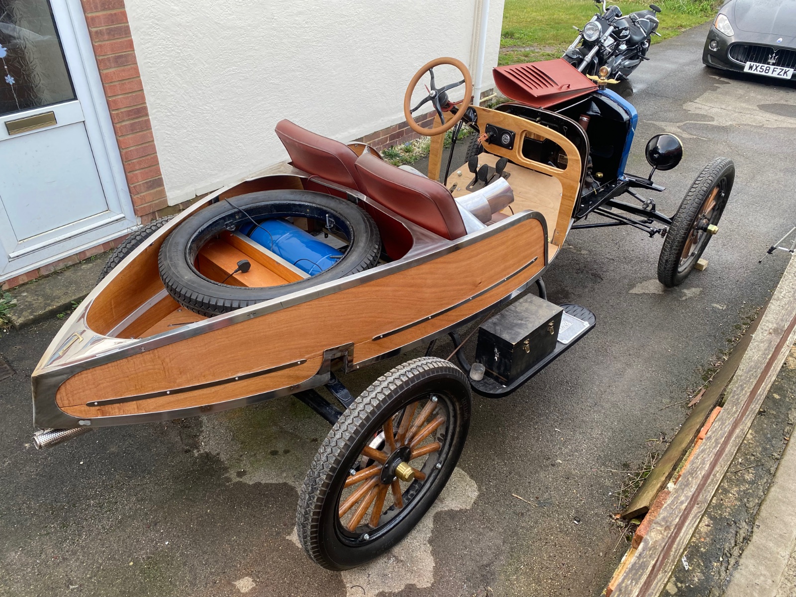

Hi all,
Well I started her for the first time yesterday, she ran well on battery and magneto. I let her cool overnight and then tightened head bolts. Today was first drive, at first low gear made nasty scraping noises, but settled down a bit. Reverse though sounds terrible, does not engage well and you have to push quite hard to get the car to move. When pushing her back into the garage (engine not running) the reverse band was chattering as in making a ratchet noise and shaking (I took the cover off and was touching it as I was moving it. The drum was hot but I could touch and stay finger pressed without burning myself). Now she has cooled down again, pushing the car back and forth she is not making the noise.
I am not quite sure how to set the bands up. They are Kevlar and I am nervous of overheating. I did the initial setting as per Mike Bender, so the pedals will move halfway up the cam. Is chattering a sign of too loose or too tight?
Thanks in advance for any insights.

Well another day, actually another year now and another problem…
Got her out again. I tightened up the fingers half a turn, readjusted pedal again and took all the slop out this time. Still only 1 and a bit movement at top of clutch pedal when moving from fully forward brake lever to neutral. Low gear felt better, reverse a bit better but still rough. High gear suddenly felt too fast… however the misfires are a bit annoying and I tracked it down to a what seemed like a very active coil that was sparking a lot, but not delivering the spark required at the right time to the plug or rather to the cylinder. I did the short each plug to figure that one and did get a nasty belt out of it when my wooden handled screwdriver decided to be conductive. Swapped plugs and the problem moved as did swapping coils. My spare coil did not work either nor my five other cheap ones that came with an old box of crap I bought at the auction. So without the means to check coils, I am going to take a trip to a coil guy this week.
Reverse still not nice, I suspect it may be partly due to using too many revs possibly due to the imperfect running. She does sound surprisingly sweet even when firing only on three cylinders only. Starts up well too and had some free starts. Reverse still chatters when pushing her back in engine off. Drums look fine with no bluing. I did get worried about some metal dust in the transmission oil screen, but on second look, it’s just some very fine stuff that may be connected to new rings etc. I also spotted a very small amount of grey sludge that must be a bit of Babbitt wearing in - I had used timesaver on an obstinate camshaft bearing that would not free up (at that point camshaft would have been very difficult to extract again so did it in situe).
I am really hoping it will all settle down soon as after 3 years or so, I want to drive it properly.
Happy New Year all.
Happy New Year all.

Just given her the first long run and I have to say, I have ridden a ZX7R at 170mph, driven a Jag XJS at 150mph, but driving the Ford at 40mph was scarier! Having said that after the second drive home, I started to feel a bit more comfortable. I still misjudged one junction and nearly hit a car, but I am beginning to get the hang of it. I really need to re situate the brake lever though as it is a bit too much of a reach.
I am now sure that any slight issues remaining are actually the rear axle. It’s not too bad, but given the safety implications and how many hills we have round here, I think I had better make it my priority. Now given the jump from lo to hi, do I go for the 3:1 or the standard? I best go do some research!
Thanks everyone for your inputs, this has been quite a stressful few days, but I now feel that I am finally getting there.
