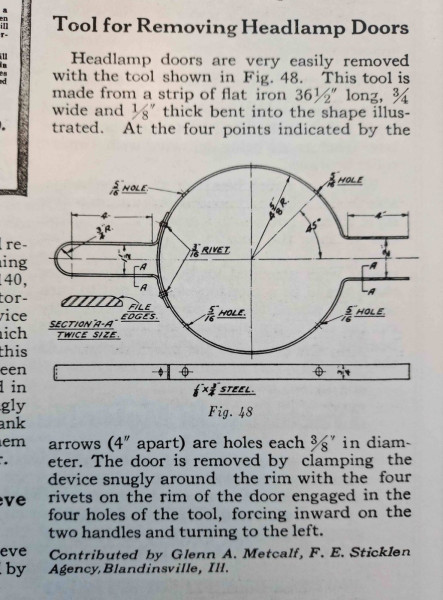

A while back I saw a post where someone had a link to the home made headlight rim removing tool (the good one), but I cannot find it now that I want to make this tool.
Could someone please guide me on this issue?

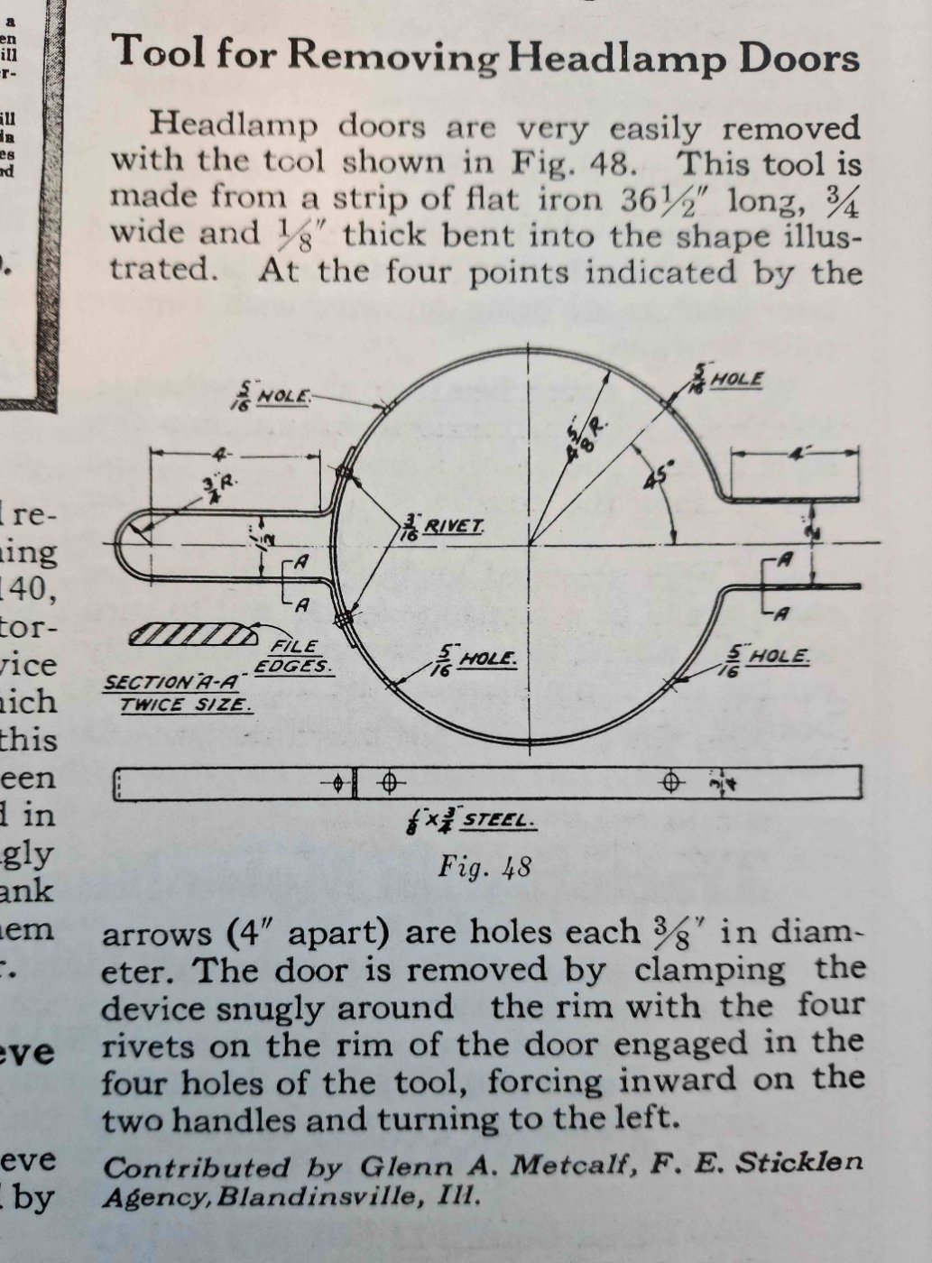

Re: Headlight rim tool
This is from the Ford Service Bulletins. Volume 2, No. 4, page 27
Link to my earlier post. It works for me.
