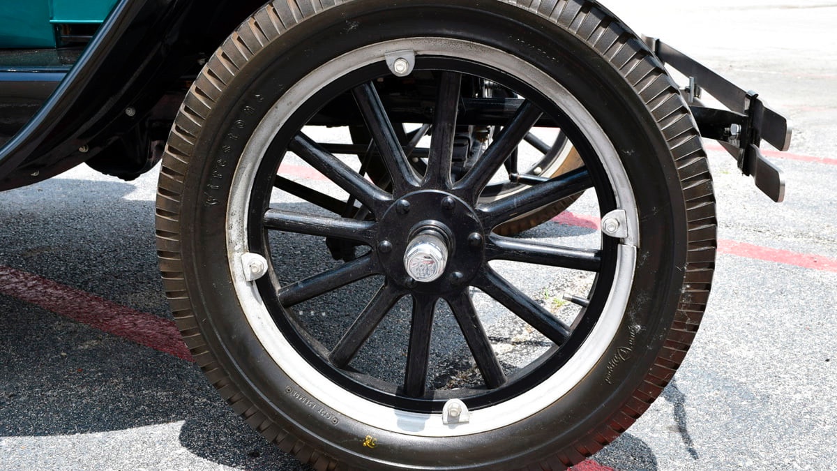

I got to thinking about this after I learned split rims were galvanized and not painted silver. (Mine are crap IMHO and I'd love new ones)

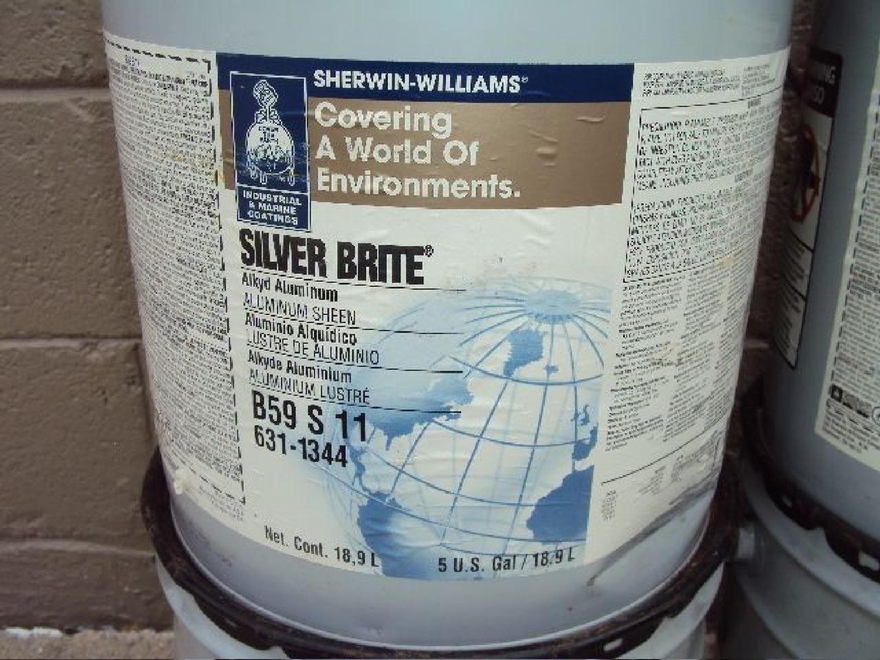

PS. I discovered a great paint for painting the split rims of the Model T. A very durable roof paint called “Silver Brite”, by Sherwin Williams that stands up to all types of conditions and weather, looks beautiful and lasts forever. It can be used on bumpers as well.

Vincent, your split rims are unlikely to have been galvanised. Galvanising is dipping components into a bath of molten zinc. This would certainly jam up the latching mechanism at the split. The rims were electro plated Zinc. This is not galvanising. It is a process which results in a silver coating like galvanising, but the coating is much thinner, doesn't clag up components and doesn't give as long lasting a finish as galvanising.

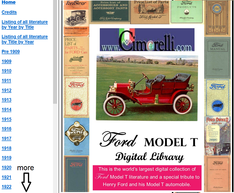

Try this site - the MTFCA has a wealth of detailed information as well - follow this link: https://www.mtfca.com/encyclopedia/
Bruce MCalley's book is available in 'soft copy' (on a pen drive I think). I have been told it has more information than in the book.

Thanks for the correction. I'm sure I read zinc somewhere and my brain switched it to galvanized upon creating this post. Zinc makes more sense. I'd buy new rims if they were not so expensive. My are badly pitted and then painted over. Would be a lot of work to weld and body fill to get smooth.Allan wrote: ↑Fri Jan 05, 2024 10:47 pmVincent, your split rims are unlikely to have been galvanised. Galvanising is dipping components into a bath of molten zinc. This would certainly jam up the latching mechanism at the split. The rims were electro plated Zinc. This is not galvanising. It is a process which results in a silver coating like galvanising, but the coating is much thinner, doesn't clag up components and doesn't give as long lasting a finish as galvanising.

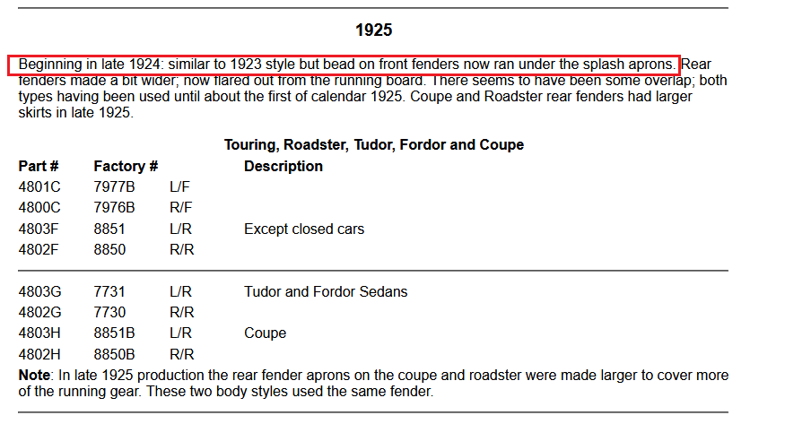

" Already found I either have the wrong fenders or splash aprons or it's totally normal LOL."
Yep. The Model T is hard to date and put together, especially when the factory parts catalogue states that it is for all Ts from 1908 to 1925. As a friend once told me -- "They all look alike." Pick a part and it will fit.

I had a parts list, update of the one George posted, dated March, 1928. It was my bible when I was a kid, and I found it very useful for identifying T stuff in the junk piles we raided. Yes, most parts were identified as being for 1909-27, although most of the problematic early parts were not mentioned, and not a few were tagged 1912-25, or so, for example. The dating notes were strictly for utility, of course, and had nothing to do with identification of any model years.

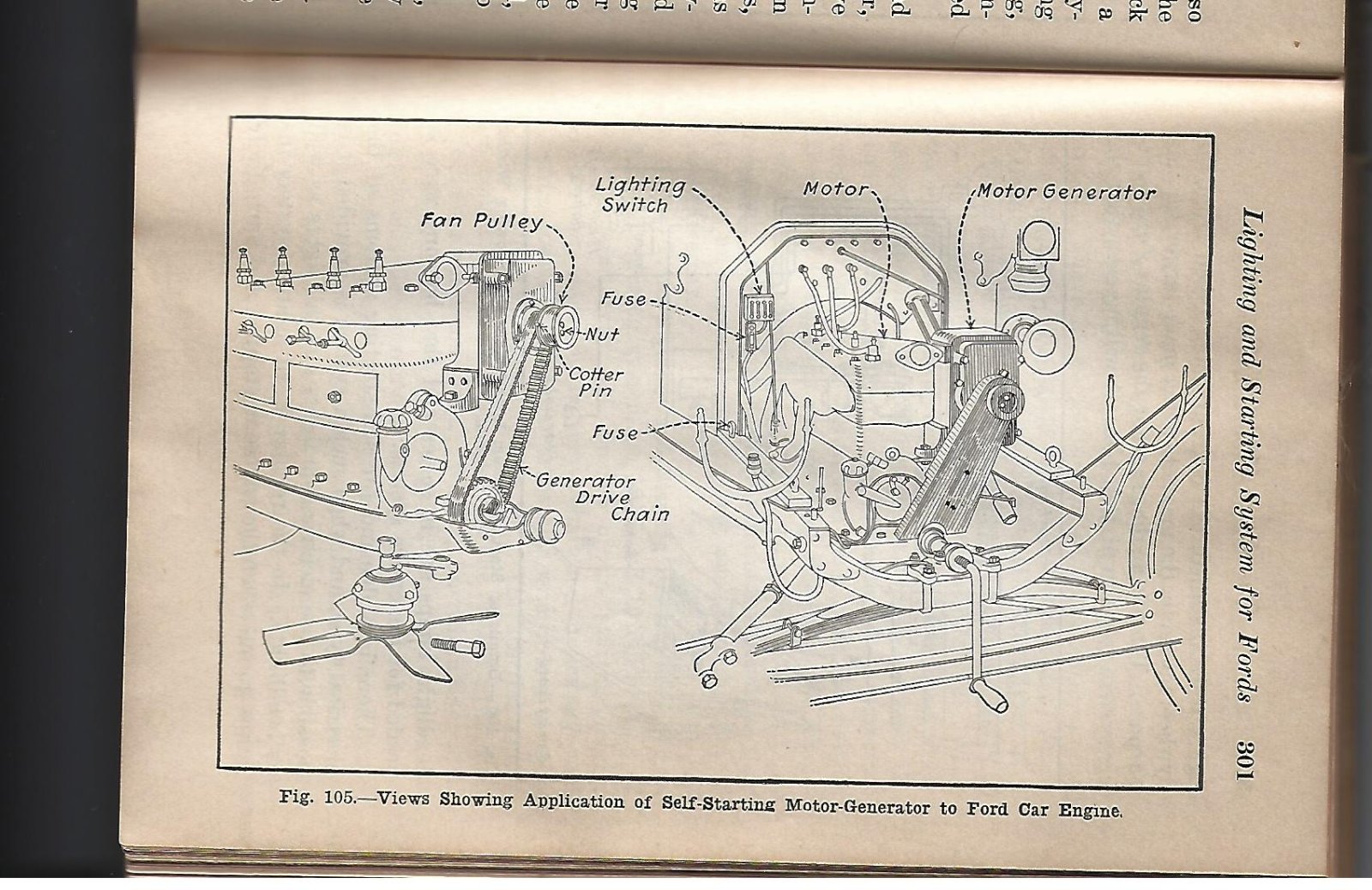

"A notable change in Model T’s came in 1919 with the introduction of an electric starter. That was a big improvement for a T. You can see and and buy older T’s with added starters and especially in the brass era cars. It’s not original to the earlier cars but people like to have the best of both eras. A brass T with a starter!"
Well yes and no.
Prior to the FMC introducing an electric, owners up to 1917 could purchase after market starters. Those with disposable cash?
Interesting too, the post that appear on the forum discuss problems with the FMC starters and Bendix.But not the after market. Too many been removed because they were not original?
No cars here with an aftermarket starter? Wow what if Ford adopted a starter generator...Oh wait one of his competitors did!

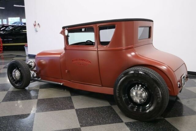

Let’s just hope the next caretaker does not have the mindset of Boyd Coddington…
Here are just a four examples out of the thousands of vintage cars that he destroyed and what that mindset can do. Coddington is dead now so he can do no more damage, but unfortunately, he has a lot of followers that are continuing his “work”. Jim Patrick

This website has just about every FORD book (owners manual, parts list) by year for download or viewing on your PC https://www.cimorelli.com/mtdl/default.htm --
other useful sites
The MTFCA has to encyclopedias versions old & new. The old is easier to get an answer about a part area across years while the new version is about a specific year.
Old version https://www.mtfca.com/encyclo/index.htm
New version https://www.mtfca.com/encyclopedia/
Drawings https://www.mtfca.com/phpBB3/app.php/gallery/album/5
The site as useful rebuild instructions https://modeltfordfix.com/
and lots on YouTube
examples of slight differences - and there are lots

Apparently the term "commercial fender" (aka "Truck Fender") is only in reference to a style of fender applied to different model & years. Several discussions indicate the TT truck continued to use the 1925 fender through 1927 hence the name"Turck Fender" was apopted
continued to use the the 1925 fender in 1926-27
From the encyclopedia --
