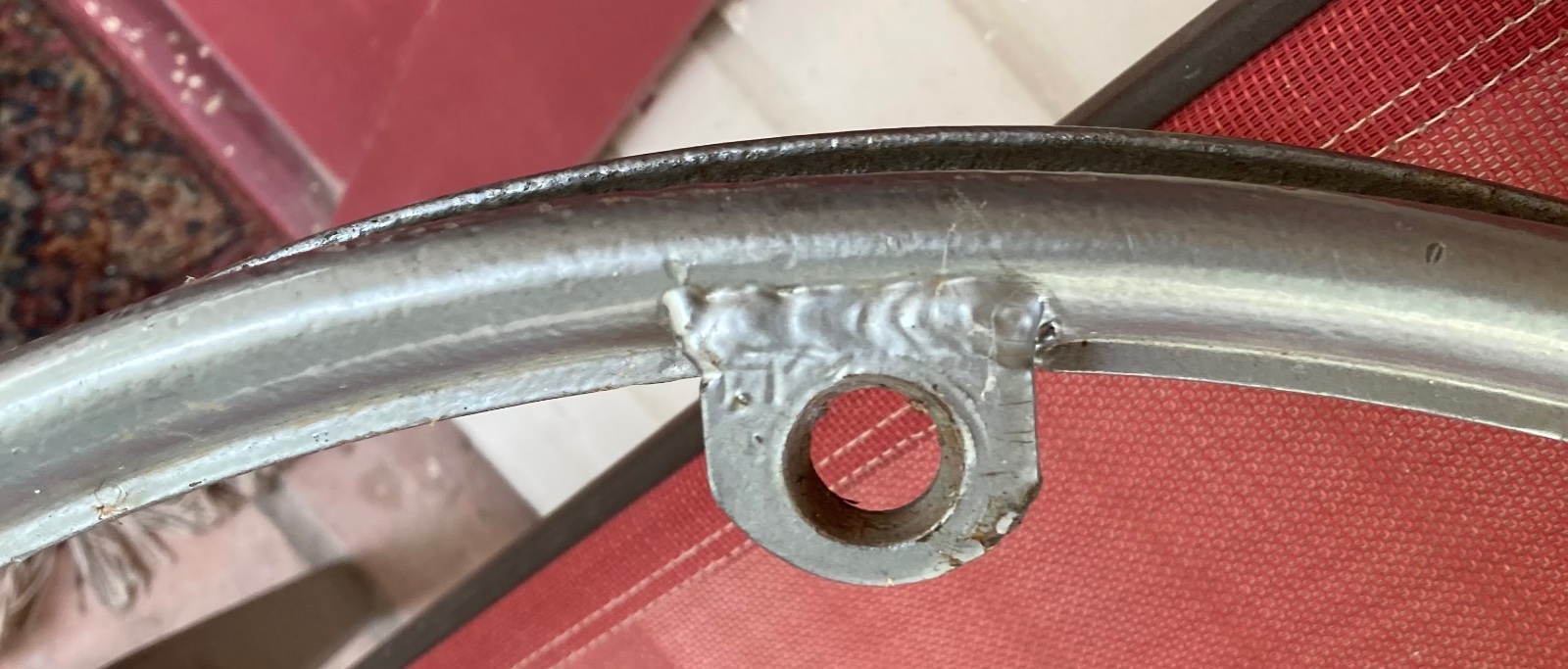

Do it look like this ? If so, easily welded. I just didn’t dress it down before powder coating.

Mine was V’d out from behind and the V filled with weld, for a cleaner looking weld. Jim Patrick

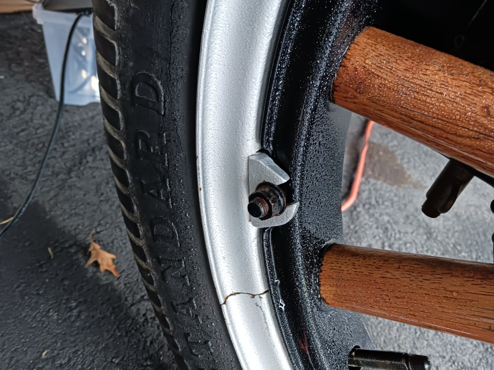

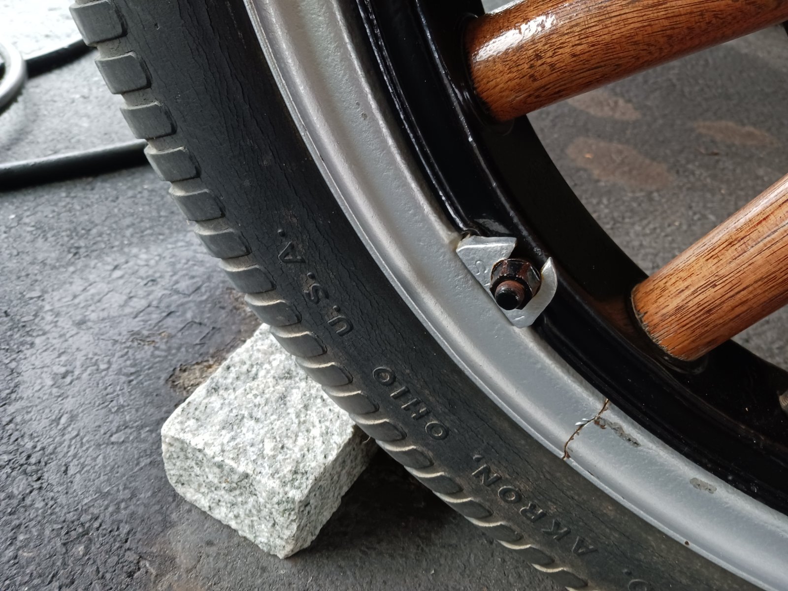

Post by TheSaintDiscJockey » Sun Jan 07, 2024 10:42 am
Here's how they look.
Two on each wheel rim.
Both located near the split in the rims.

They are supposed to be that way. That’s the way they left the factory. Without the split you have to stress the rubber valve stem to install the rim and is impossible to install a metal stem rim.

His rims in the picture are the way they left the factory. It’s not an opinion IT’S A FACT. The rims in the picture are TT truck 23” Hayes rears… If you haven’t much experience with TT’s, it’s an often overlooked detail.

I had assumed that these lugs had broken. Sounds like they are perfectly normal. One less thing to worry about. Many thanks for the insight!

I have a later 1924 - 27 TT with the 23inch Hayes split rims on the rear that are rusty, plus some other 23 inch Hayes split rims that are in good shape, all of these rims have the lug by the split like you show. That is so you can install the rim with inflated tire on the wheel with out forcing it on and bending the valve stem.
