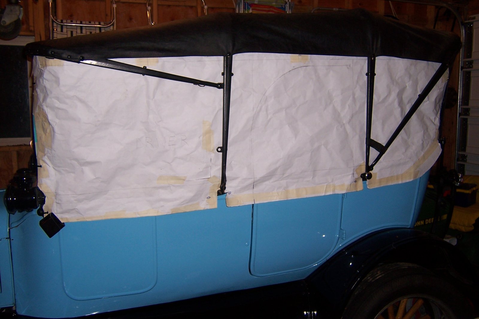

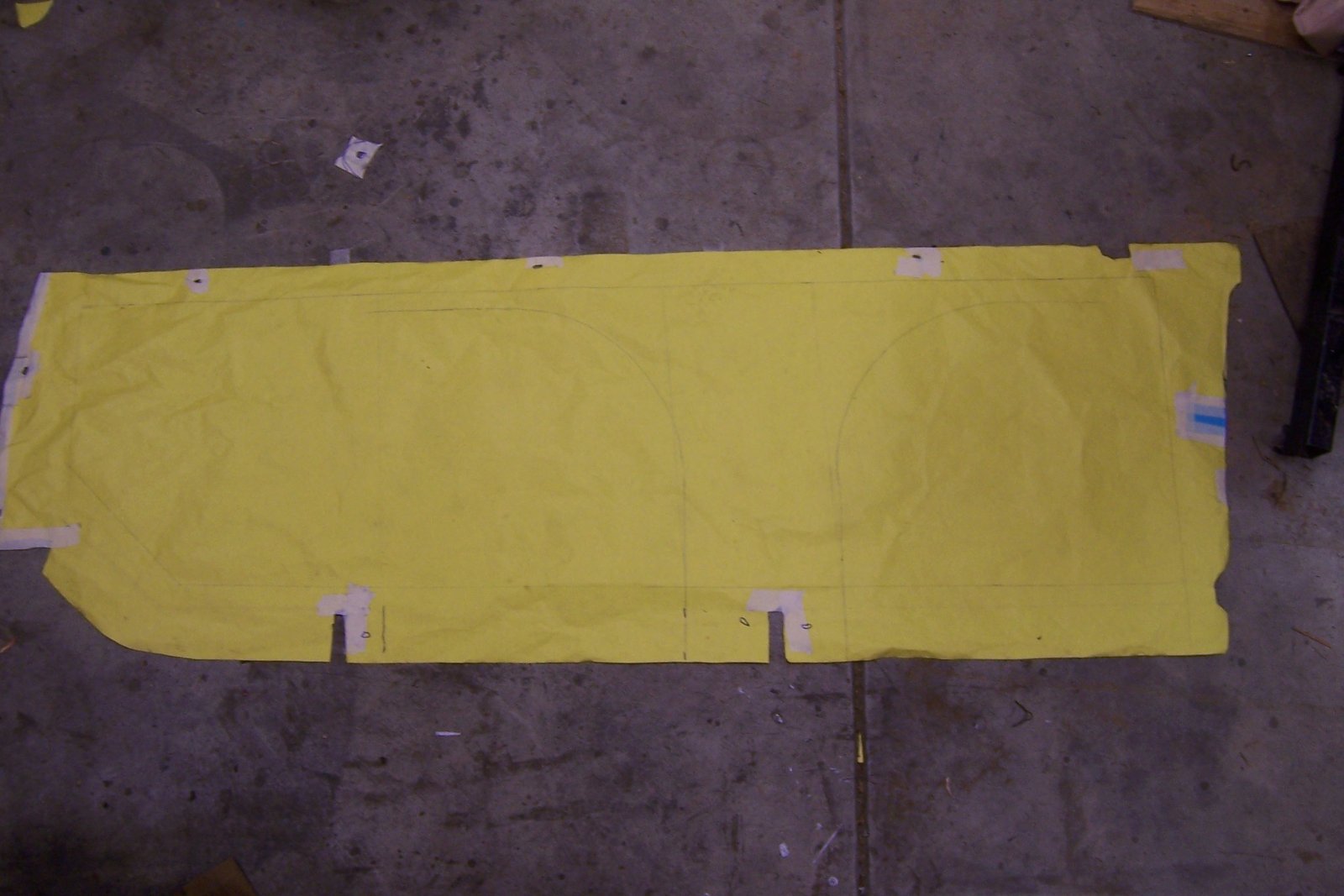

Austin, We've made side curtains for our 23 touring as well as our 20 roadster. We took some heavy paper and made a pattern for each side, going back behind the rear side portions of the rear top segment. We purchased some plastic/vinyl sheet from the local WalMart and cut it big. We fitted it, trimmed where needed, and rimmed the periphery with Naugahyde so it would hold a fastener. We looked at how stock curtains are attached and used the same type and locations of fasteners. We sewed in double sided zippers at the rear of the door areas so we could open from inside or outside. . There were holes in the top bows for common sense fasteners so we used those locations. I made thin brackets to loop over the lower irons on the bow at the sides. There are hooks on the windshield stanchions that we fasten the curtain fronts on with metal gromets. Teresa did the sewing for both sets. they were inexpensive, aside from time, and work well for rain and winter driving. We've used them on several tours. The vinyl allows full visibility. I'll try to find pictures.

It will be easier if you can find a local person with side curtains for you model that you can trace for a pattern. It will also inform you how the fasteners should work.

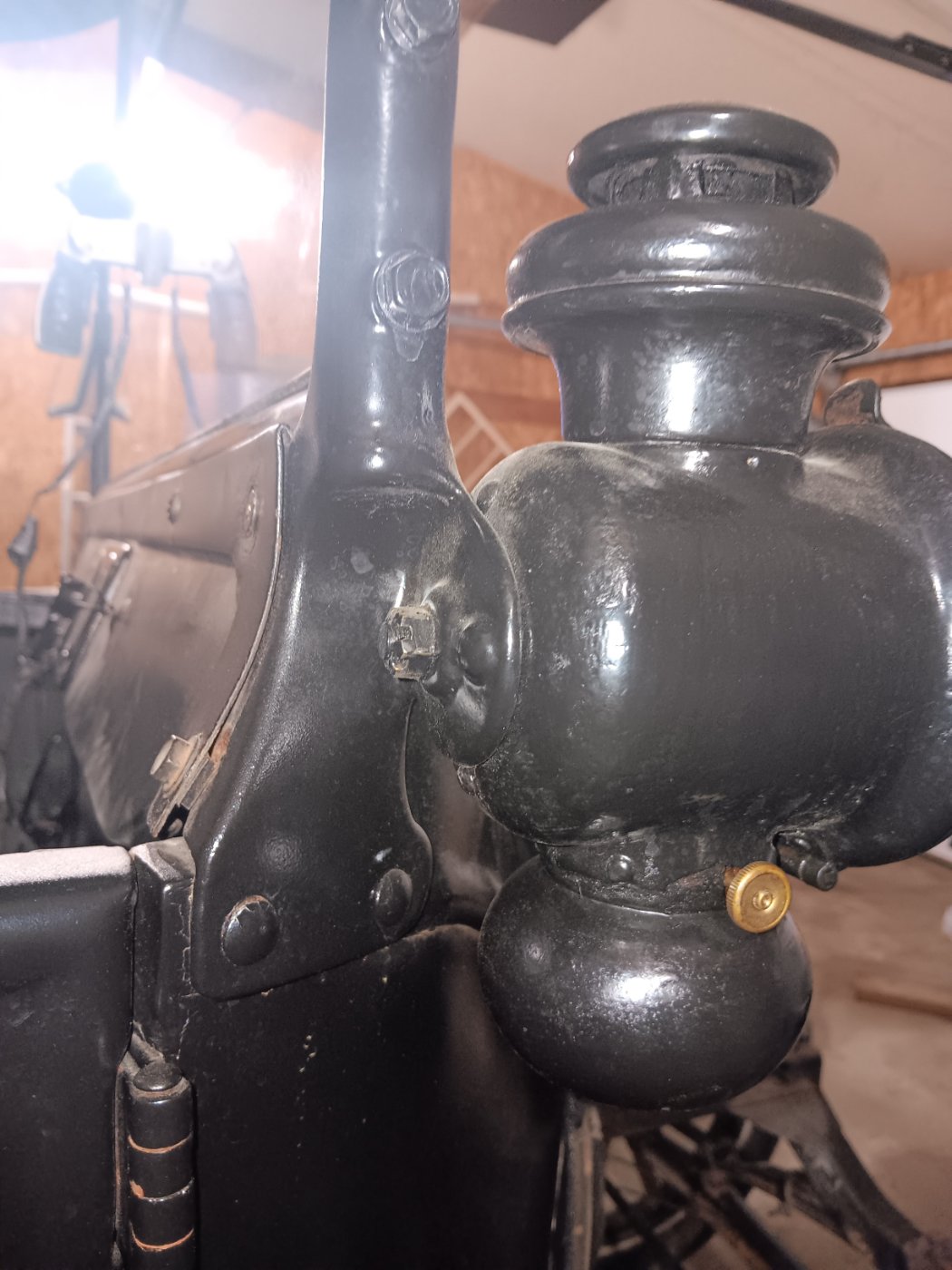

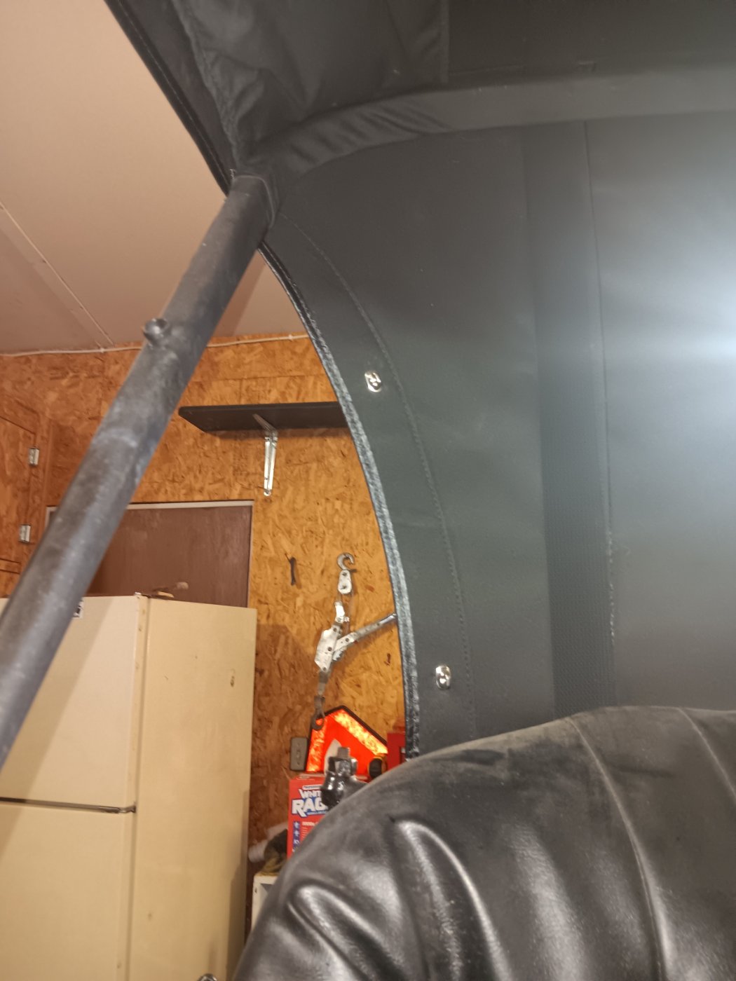

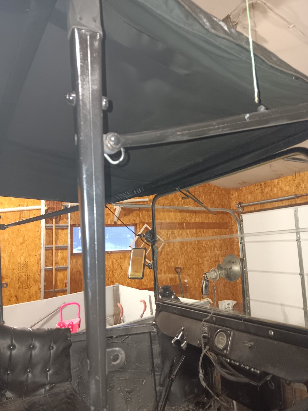

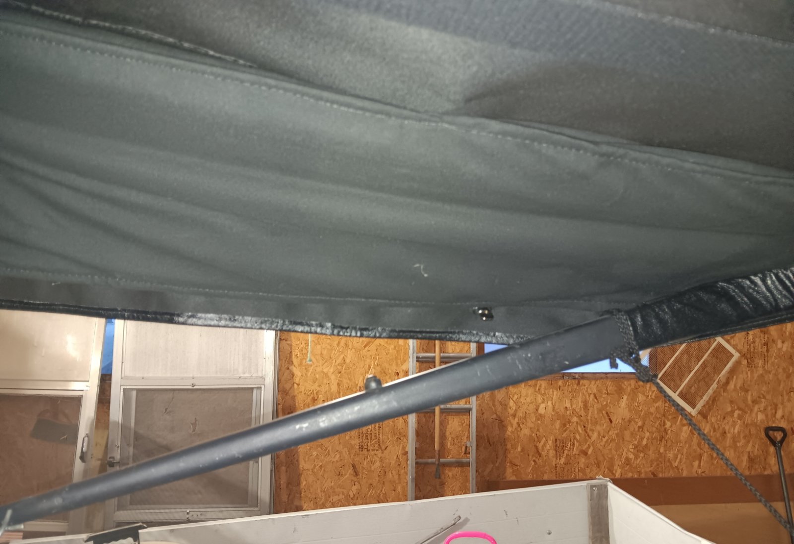

Topic author - Posts: 887
- First Name: Austin
- Last Name: Farmer
- Location: N.W. Illinois
Re: Wanted: Ideas for side curtians for 1922 2 man top

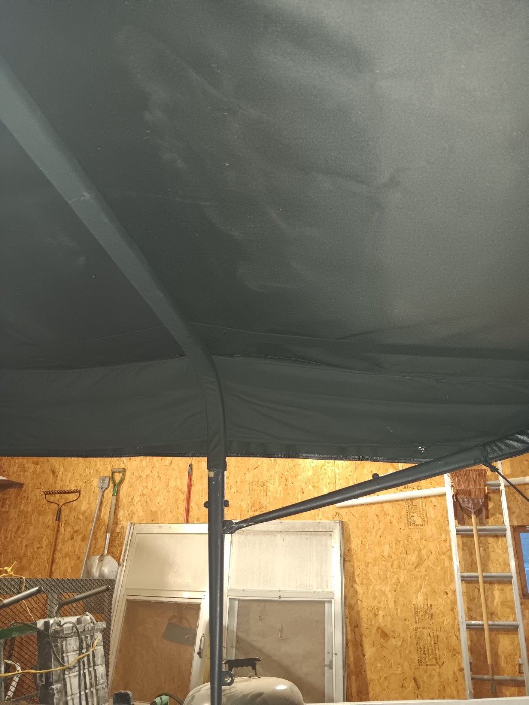

These are all the Fasteners I have so far on the top. The car came with them.

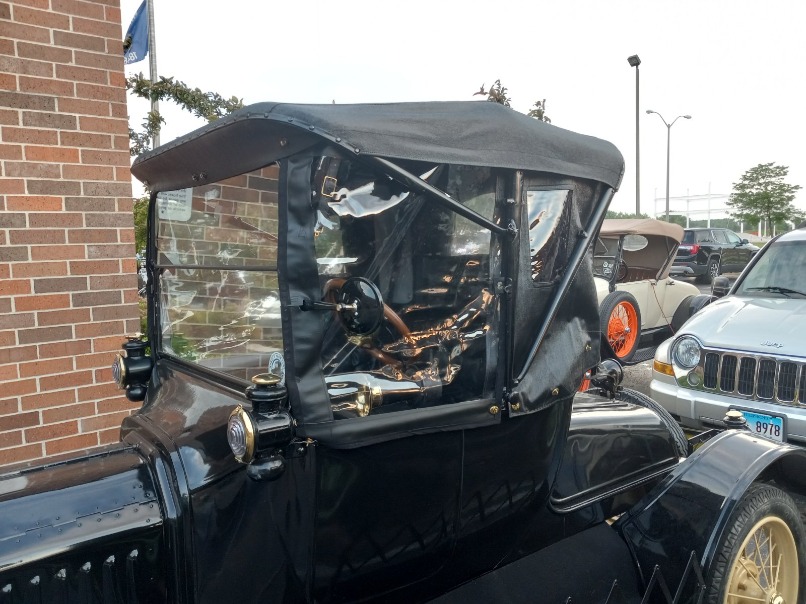

I designed my hi-viz side curtains with two sided zippers on each side of each door. Unzip from the bottom, open the door and get in, then zip down from the top.

This is the type of side curtain that I would like to make. Do you have any plans or detailed pictures of the snaps and the zippers and overall construction?KWTownsend wrote: ↑Thu Jan 11, 2024 12:06 pmI designed my hi-viz side curtains with two sided zippers on each side of each door. Unzip from the bottom, open the door and get in, then zip down from the top.
Keith
Much appreciated!

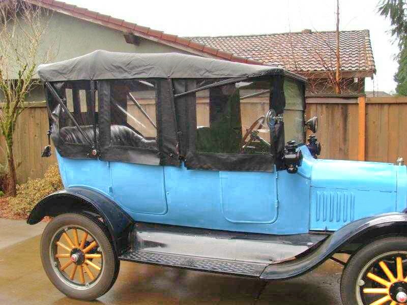

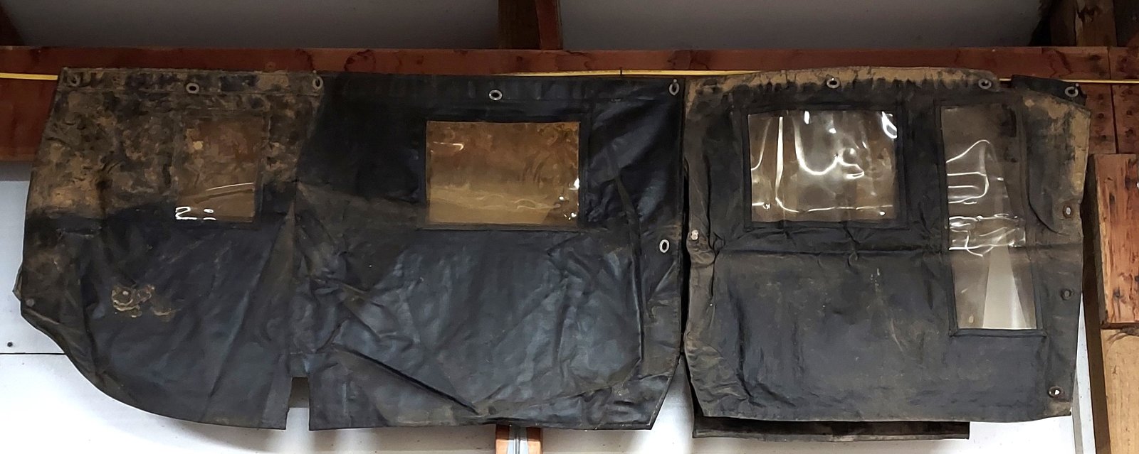

Driving around in an open car with the top up makes me a bit claustrophobic to begin with, side curtains must be like getting an MRI. The attached picture is a NOS set of 17-22 touring side curtains. The windows are way too small for my liking, OK for the driver curtain, but forget about seeing anything thru the passenger side or rear curtains. Those that made their own with extra large windows like Ford eventually did in 1927 is probably the way to go if you plan to use them when driving.

I went to a fabric store and they had marine grade vinyl material. It is a relatively soft material (easier to sew?? I havent sewn before.) It claims to be ok in the sun and good for marine applications. It has a white backing.
They also carry clear vynal however they didn't have a good stock.
What types of material have you used?
***I would appreciate pictures! ***
I am interested in making them with large windows, like the blue T in an above post.

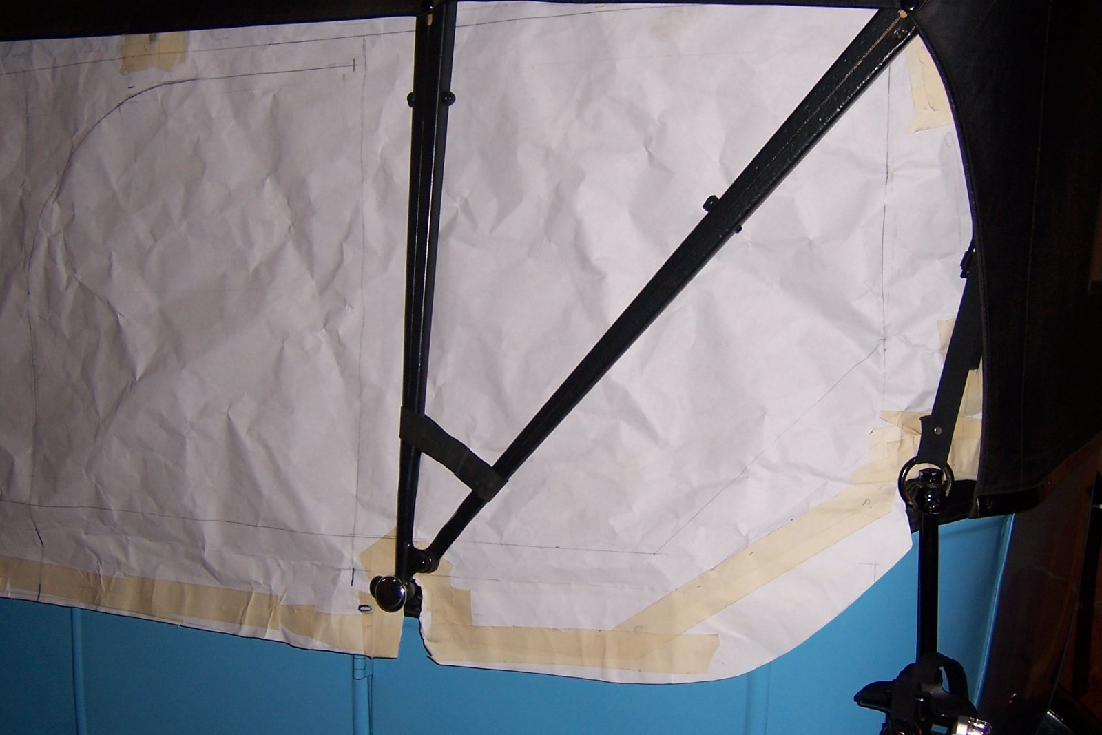

Austin,
I made paper patterns for my side curtains.
Fortunately, my guy was able to work with them and create what I had envisioned.
The correct material is available from Michael at Classtique. It is black on the inside.
contact me offline and Can sent you some detailed photos.
-Keith
