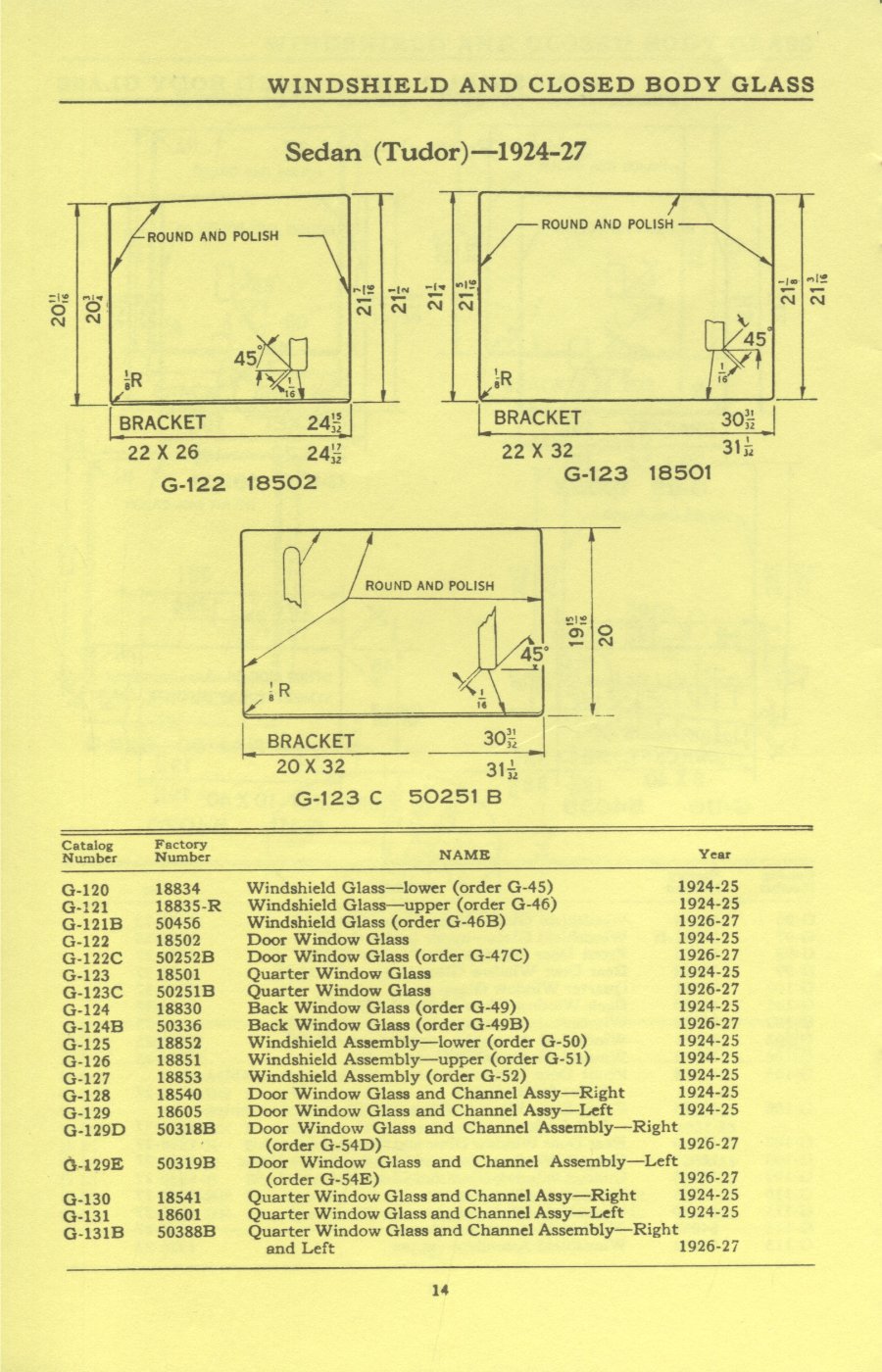

Would anyone happen to have a piece they could measure and share the dimensions? I'd like to if I can, leave the door intact and order the glass now.
Bad idea? Did Ford tweak glass for each car to make it fit?

Re: 25 Tudor driver's door glass
Here is the diagram from the Ford glass booklet.
Larry

If it were me, and what you have fits properly, I would remove it and use it as the pattern.
- Posts: 4623
The illustration of the glass size is good to take with you if you take the car to a glass shop.
Better yet is to take the originals as patterns to the shop if possible.
Remember that the glass is not square!!
Most of the glass shops don’t cut glass for antique cars. Don’t go to the first shop you see but call around and find one that has cut glass for antique cars. Most don’t and are clueless.
