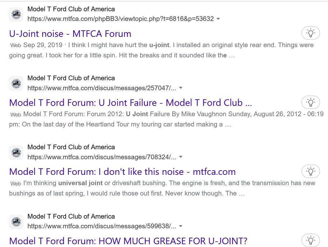

Multiple discussion on possible U-joint noise https://www.bing.com/search?form=MOZLBR ... oise+mtfca
