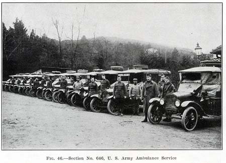

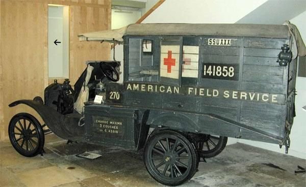

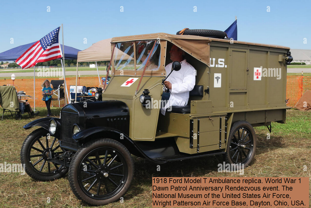

Did a bit of research. First: for the US there appears to be ambulances belonging to the" "American Field Service", "Red Cross" and "Ambulance Service" (aka "United States Army Ambulance Service)". In attempting to colorize several WW1 photos I don't feel that any were the olive drab that we visualize as a WWII color. Also the colors of these vehicles may have been different based on the organization that belonged to.
https://www.worldwar1centennial.org/ind ... rvice.html
The American Field Service (AFS) was a volunteer ambulance and camion corps serving with the French Army during World War I. AFS ceased to exist as an independent entity and was absorbed by the United States military when the United States entered the war in 1917. The vehicle color appears to similar to others of the period that is more brown than green --

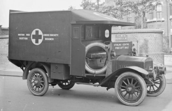

"RED Cross" images of Red Cross vehicles in WW1 may be mostly of the "British Red Cross" since the "American Red Cross" did not get involved until 1917: when the US declared war on Germany in 16 April 1917 and WWI ended 11 November 1918
British Red Cross vehicle --
The following account of the United States Army Ambulance Service in France is very much condensed from the complete historical report of the commanding officer of that service. see this link https://achh.army.mil/history/book-wwi- ... s-chapter6
you need to scroll down to "UNITED STATES ARMY AMBULANCE SERVICE IN FRANCE"
From https://landships.activeboard.com/t5024 ... 1-to-1916/
The October 1918 US Army Ordnance Department publication “Painting Instruction for Camouflaging of Ordnance Vehicles” stated that “Prior to 1914 the only attempt to lessen visibility was by painting the vehicle with a monotone, battleship gray or olive drab.” The 1906 US War Department Circular 66 specified the use of Olive Drab for army wagons and indicated that this color could be mixed using 6 pounds White Lead in Linseed Oil, 1 pound Raw Umber pigment, 1 pint Turpentine, and ½ pint Japan Drier. Surviving samples show it to be lighter that World War II Olive Drab. This color remained standard through World War I, and was authorized in the annual editions of the “Manual for Quartermaster Corps, United States Army” through 1917.
Perhaps this is what people in the WWI error refr to the color of Olive Drab as opposed to the WWII version

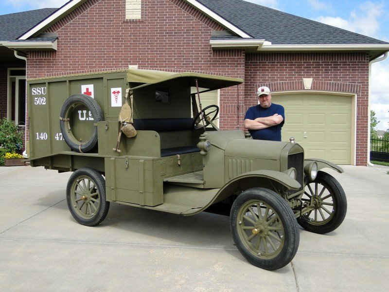

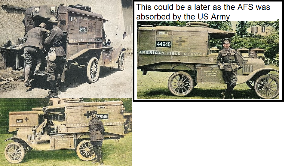

Excellent research, Frank! From your pictures, it looks as if the spokes and rims are the same color as the body. Very helpful. I guess the only decision is whether to paint it flat battleship gray or WWI flat olive drab. I like the olive drab that is the same color as the WWI Uniform tunic. That seems like it would be the best camouflage for the battlefield ambulance. Jim Patrick

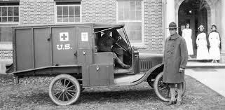

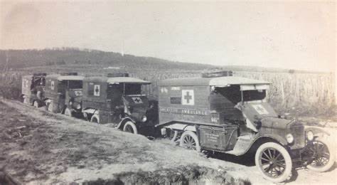

two more photos

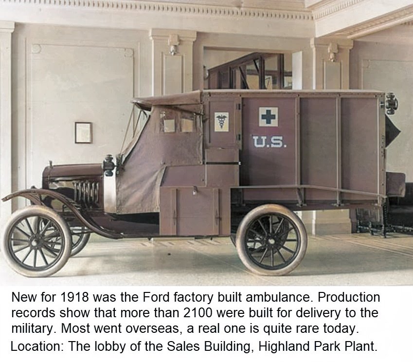

The correct painting depends on which organization & year is to be replicated. This a US Army version after which the color standard was adopted in 1918 (see above). It is not the same color for an "American Field Service" ambulance nor the WWII & beyond Olive Drab

Robert, demountable rims on Civilian cars were Zinc plated rather than painted. That is why they appear silver in colour, and that is why many of them are painted with silver paint when they are restored. WW 1 production wheels would have all been non demountable wheels. That means the rims were painted the same colour as the rest of the wheel.

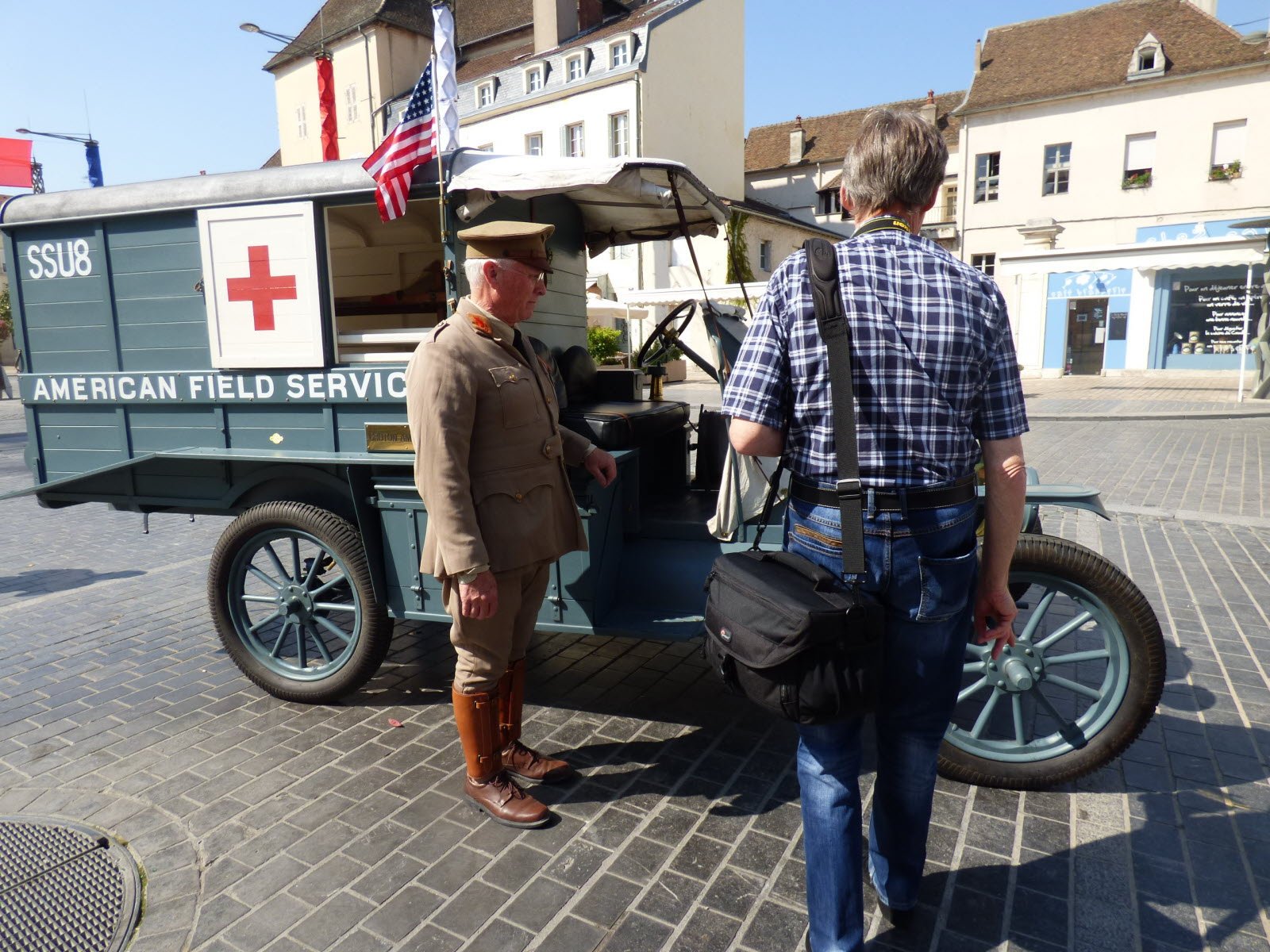

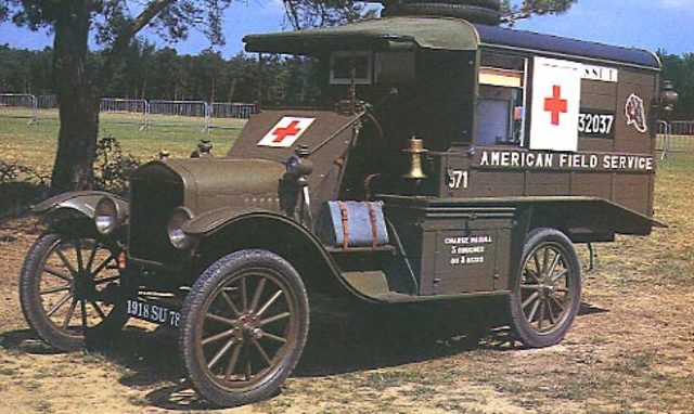

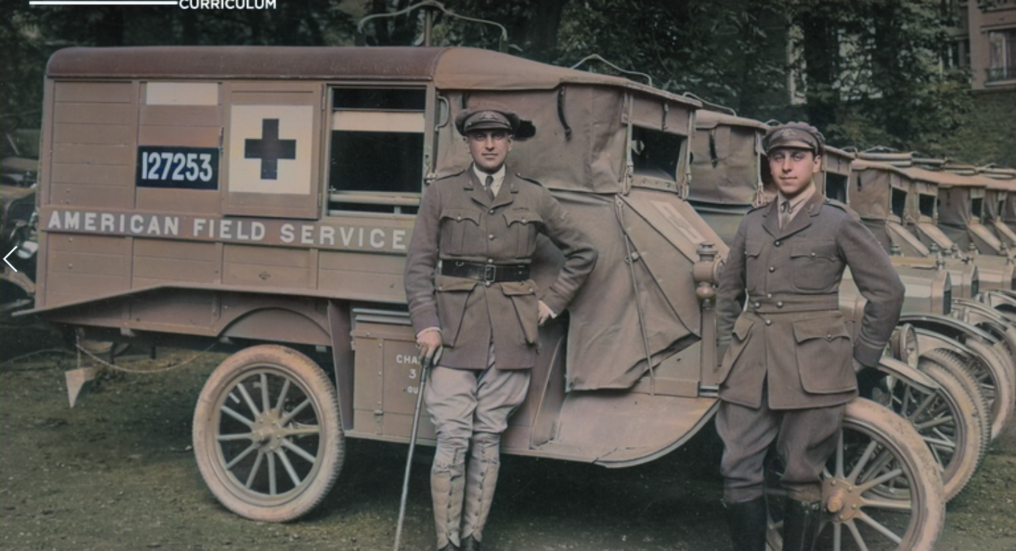

A couple years ago i did some extensive research into WW1 Ford ambulances, pertinent to your plan on colors;
The ambulances of the AFS were painted a light(ish) blue, as that was the standard colour of the French Armee, under which command it operated, there is only one original car left, it resides in France in the AFS museum near Paris. Most of the AFS ambulances were later fitted with Goodyear demountable rims, as Ford did not yet produce demountables then, the Goodyears can be identified by having 5 lugs The Standardised US Army Ford ambulances of the 1917 model were painted a rather light olive drab
In answer to your question : no bright finish or surface was allowed, so yes all rims were painted body color.
