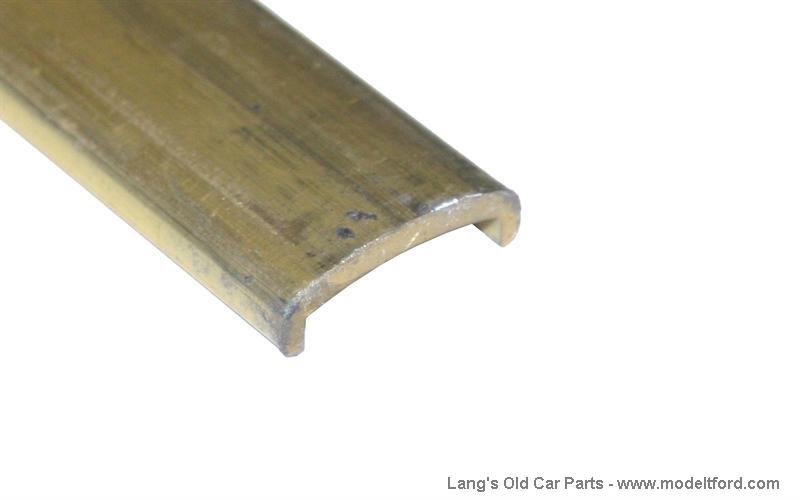

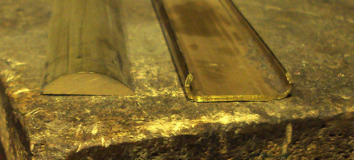

Just for reference, here is the repro molding that was available when I did mt '14 at right and some half oval from a brass dealer that I used on my '09.
This was available from Lang's later. It has the curved top.
All are 3/4 as mentioned earlier. The pictures are for those not familiar with them.
I had some trouble finding 3/4" plywood as most available where I was looking was a but thinner.

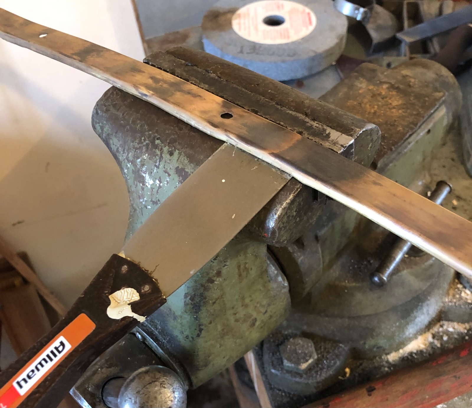

Re: '13-'14 brass dashboard trim

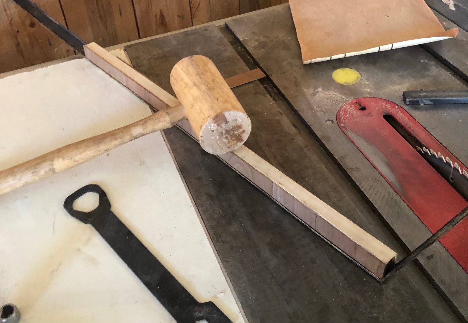

Thanks for that, Rich ! That pretty much clears up questions I had. As nothing is currently available new, I pondered the best way to make the trim I have fit my "new" dash. The trim as formed was work-hardened enough to not respond to efforts to "tweak" the channel 1/16" wider to admit the panel I made. I opted to anneal the piece, and it went limp as a spaghetti noodle in boiling water !
Rather a Fred Flintstone approach, I was able to tweak both legs of the channel using the vise and a joint knife.
A strip cut from the panel blank and a mallet made sure of the fit, and straightened up the trim strip.
Lizzie ain't no show car, I believe the trim will be adequate when polished.
