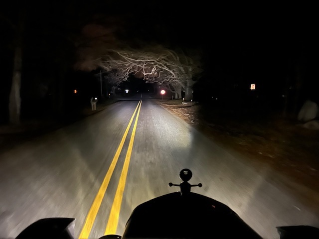

Just sharing a night drive photo using LED’s.
My ‘23 Touring is 6v. The LED’s will run on 6-24v. No difference in brightness with higher voltage but mentioned it since they do have an input range. These make driving at night actually fun and you can see the road. Don’t forget to refresh your reflectors if they are dull or tarnished.
The best part is they draw less than 2 amps. So I run my generator at 4 amps and have a voltage regulator so little stress on generator and battery.
Good luck!

Woody23 wrote:
Sat Jan 27, 2024 9:53 am
Good luck!
David
Okay.... What LED Bulbs are they (model & supplier)? Also are you using the stock fluted lens? This is best picture I have seen of well focused Model T headlights!!!!
They are focused well for oncoming drivers but a bit high which might annoy a car in front (but that's an issue with the lens)

I would hate to be driving into David's lights. As far as focus goes, the led's cannot be focused as that relies on shifting the globe holder so that the reflector can focus the light output. They can be aimed, but that does not concentrate the beam. The led's throw light forward, so the reflector has no function. Some led "globes" have rings of led's to throw light sideways onto the reflector. There are banks of them, so the light is scattered about when projected forward.
What the led' bulbs do is emit loads of ill directed bright blue/white light with little current draw. The latter is a positive in a T. The former leads me to ask, are there design rules on auto lighting in the USA? If so, have any of the replacement led bulbs been assessed to see if they meet these design rules? In Australia many of the conversions for use with standard parabolic reflectors, [like T's], are for off road use only.

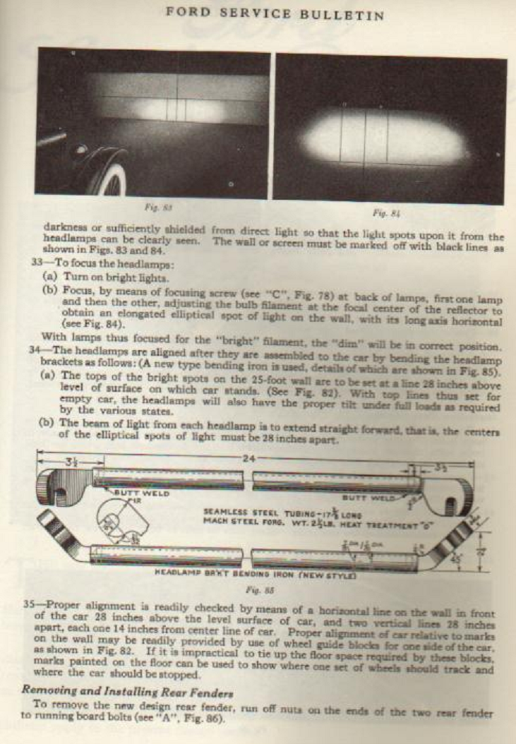

Luke, I agree with Allan on his statement about the picture of David Wood's LED headlights not being aimed properly as I stated above. I have commented on several LED bulb designs in the past, some good & some bad. These were the best I have seen, with the exception of a lack of cutoff.
Normally focused low beam headlights cutoff height so that don't reflect into the driver's compartment in front of them. Now we don't know if the picture was with Low Beam or High beam. Just that the picture would bother drivers in front. So any bright light above the white line is a distraction. Illumination the tree branches is a bit too much above the cutoff
Now Model T headlights are not the easiest to aim. One screw to get the bulb into the focal point of the reflector for maximum brightness. The fluted lens is what actually bends the light pattern.
Matching new technology to old has always been a challenge. The first electric headlights had a flat glass lens just like the early brass headlights. It wasn't long before the brightness of th new electric light (like today) caused some laws to eliminate the glare to on coming drivers. This cause numerous aftermarket headlight lens patterns

I have not tried to focus them yet but I need to. The original thought was to run these during the day for visibility around traffic since I had cars pulling out in front of me all the time and they do help during the day.
I did try the original 32 candle power bulbs or whatever they are but they seem to be more of a marker for other cars than being able to see the road so the first time I took the car out at night I was hooked.
In the photo I’m actually on dim because one bulb has a failed LED used on the bright circuit but oddly enough there is not a huge difference in brightness between dim and bright. I think bright is a bit wider pattern since both sides of the bulb are on.
I have the car out many times at night and never had oncoming traffic flash high beems ( I do get a lot of oncoming drivers flashing me in my Equinox on dim). So these are not as bright as a modern car but as you can see from photo I have not done anything to adjust the pattern.
The photo was taken with my iPhone so that may have made it a bit brighter but I don’t think much. You can still see the reflection on the street signs further down the road.
I can tell you it’s a blast to drive at night and would not ever go back to the incandescent bulbs. The best part is I run my generator at 4 amps so even with the headlamps and tail light I still have a 2 amp charge.
Hope that helps happy to share more if needed.
