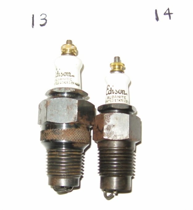

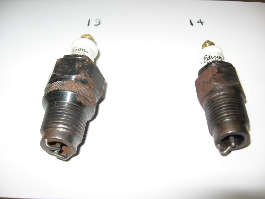

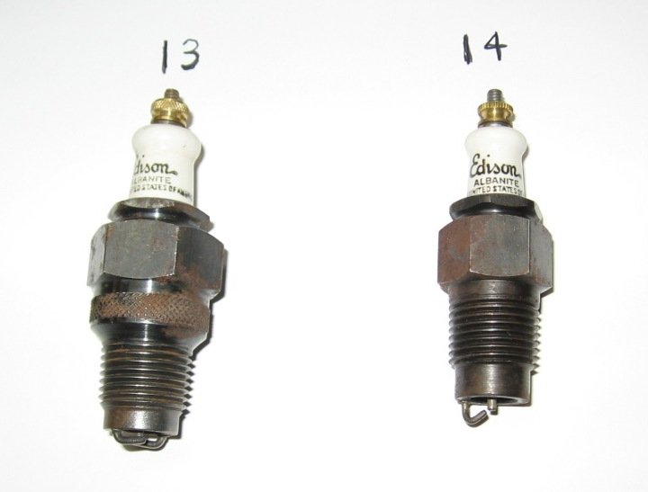

And right you are. The Edison 13 is a somewhat larger plug and requires a larger than standard T plug wrench. However its most important distinction is that the base is a dual fire. Whether dual fire has any real advantage or not is still debated. Although most automotive engineers seem to believe the advantage is minimal at most.
The Edison 14 is about the size of a common Champion X, and regular single fire base.
Both the Edison 13s and 14s changed in details over the years. some can be taken apart, and some cannot be. The size and placement of ridges varies as well. Putting together a set can be difficult. I have three Edison 13s I have been trying to find a fourth for a set for thirty years now. Now the problem is also that I took one of them to a swap meet years ago to try to match it, and somehow misplaced it when I got home. A household move since has had either the single, or the pair show up at different times. But it has been almost twenty years since I have seen all three of them at one time.

If anyone has one or more Edison 13 plugs, I would happily trade you an Edison 14 one-for-one. No, I will not sell any Edison plugs outright. :)

A fellow member has stepped up and is trading me two nice Edison 13 plugs for four of my Edison 14 plugs, Thanks Tad! :)
I should have enough Edison 13s now, so I don't need to do further trades.

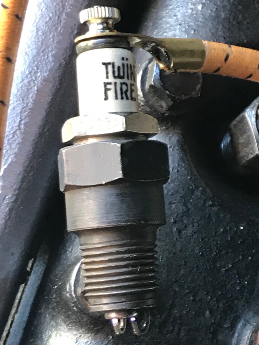

On the topic of spark plugs for T’s with multiple electrodes, the only one I know of that always makes multiple sparks is the aptly named Twin Fire.
