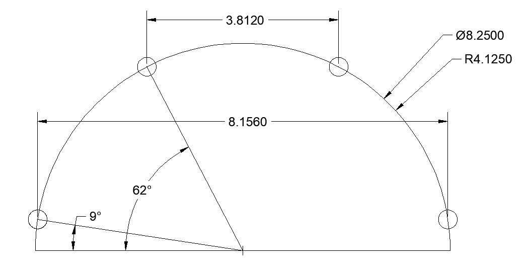

Does anyone know the radius (or diameter)
of the mounting bolt circle of the magneto field coil?
If possible I would like to know the dimension from the Ford drawing.
I need to layout the hole pattern for a HCCT spark ring.
Thanks for your help.

The holes are on a 4.125 bolt circle.
The two holes closest to the pan rail are 8.156 apart
The two top holes are 3.812 apart
This comes out to approx 8.5 degrees and 62.5 degrees from the pan rail on the 4.125 dia BC.
Almost all ford block and part dimensions are fractional dimensions in my experience.

I laid it out in CAD and it is right on.
