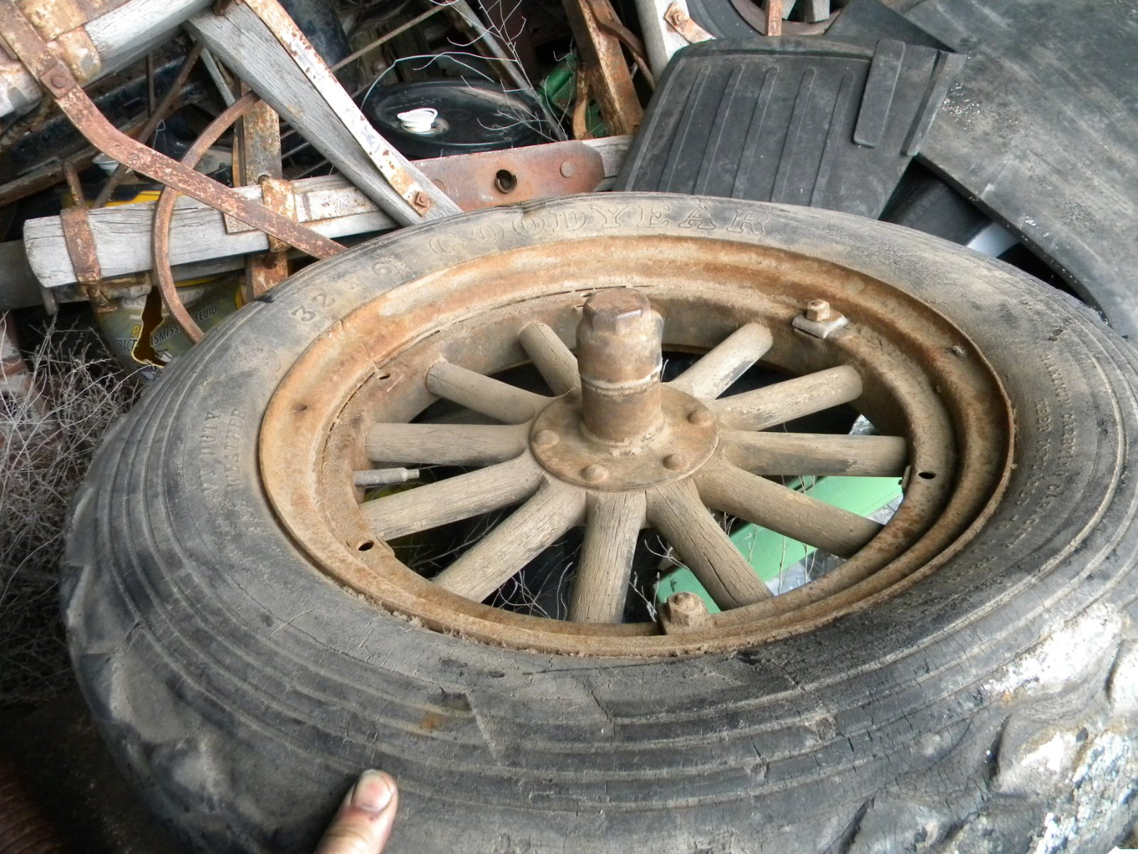

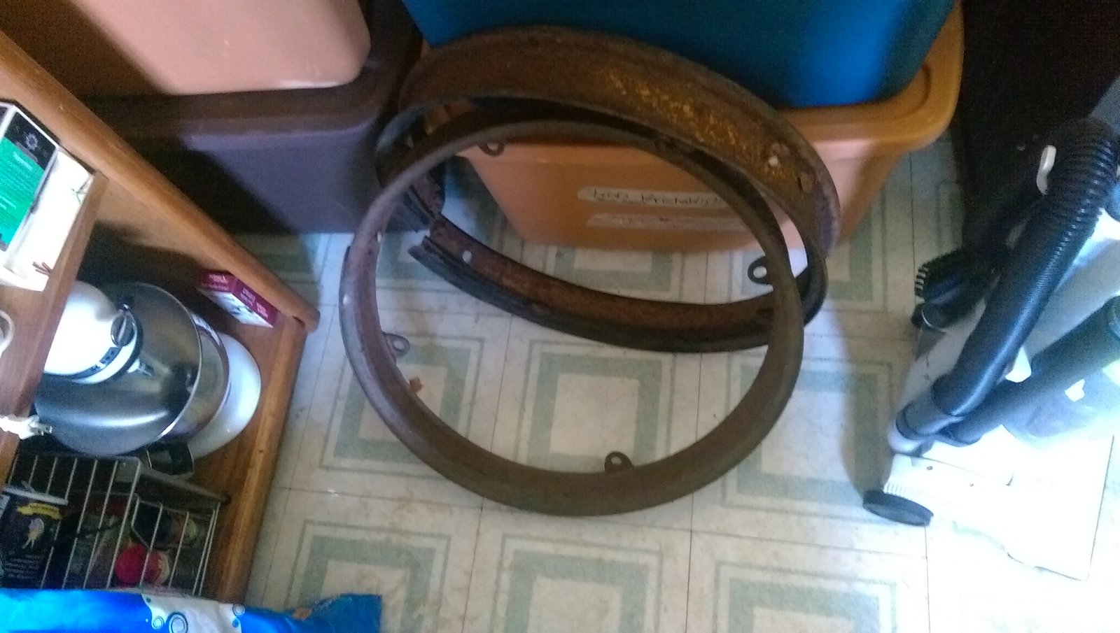

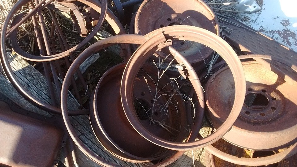

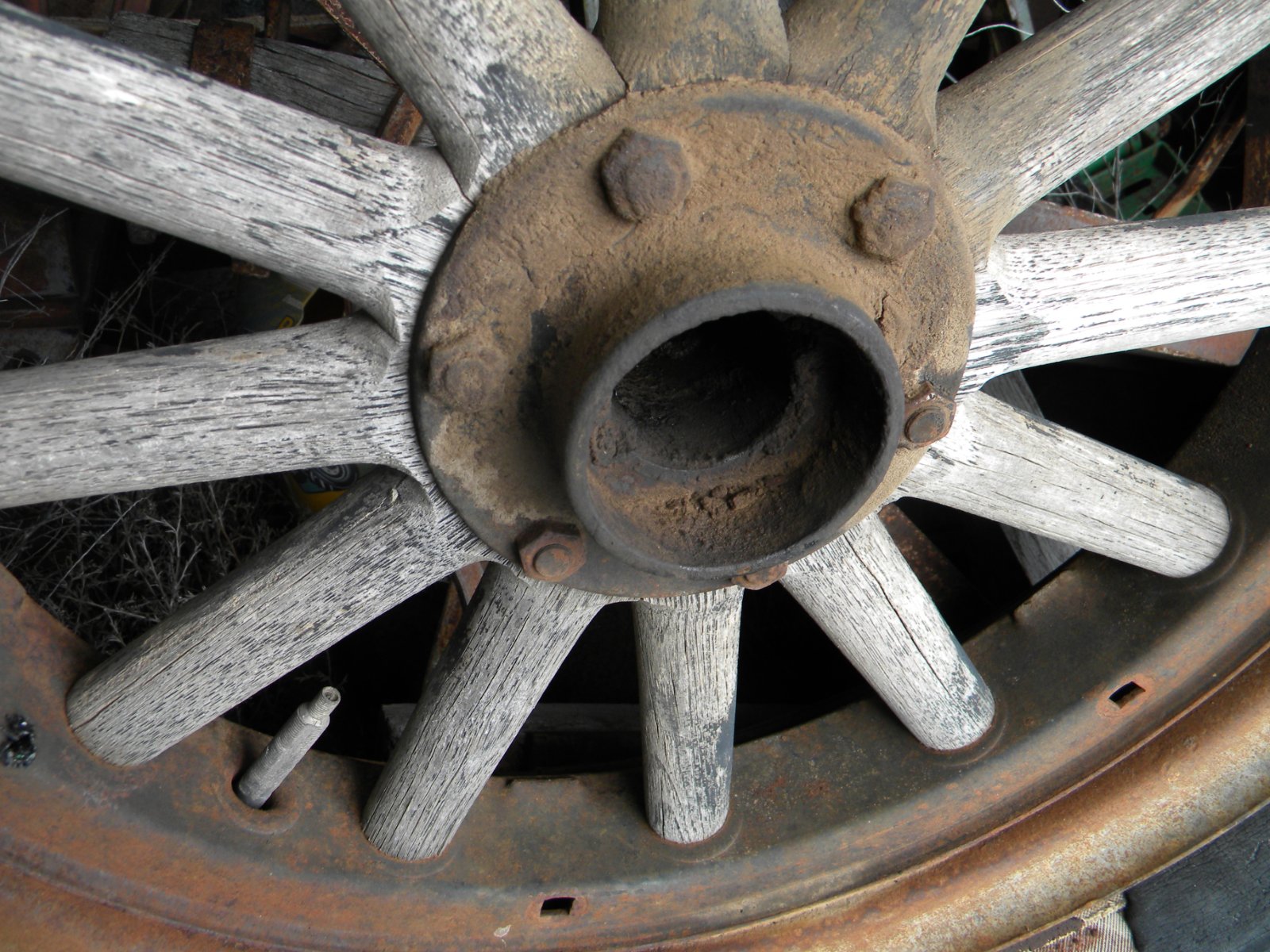

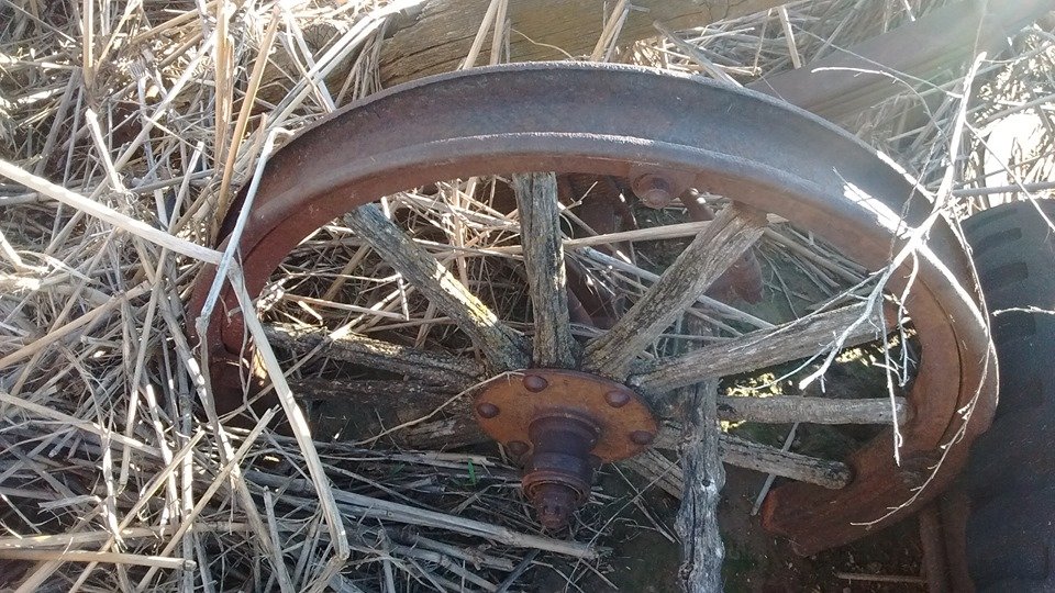

Hi, first post. I am a farmer who is wanting to do threshing shows and that got me into Model T trucks to dump the grain into. I have picked up parts here and there but rear rims and wheels have kind of eluded me. I found a set of rims and tires (junk tires) listed at an auction that were the right size so I went and bought them. The people selling them thought they were really Chevy but the rims look about right. One still had a decent spoked wheel that I have posted pics of that had a plain hub cap. I don't think the wheel itself is Ford but can I use a Chevy rim on a Ford wheel? I don't yet have the TT rear wheels, just a bare axle with brakes so I don't have anything to compare. The clincher type looks kind of the same? Sorry for the stupid question but I am just starting out. Its been a lot of fun so far and if this truck turns out I could see a car in my future. Thanks for any help you can give me.

Not going to comment on the wheel photos but the first/top photo is of a Canadian rim - they use a "special" rim tool inserted into the small holes on the outer rim area and that's a removable pin holding the joint together, which apparently, the latch has become un-riveted !

I don’t think that’ll work farmer Aaron. The inside pic of that hub appears to be for a front wheel. Don’t see any way a brake drum can be fastened. The taper for the ends of your TT axles probably won’t match that hub either.

That is a good question about the year, was the original engine the only way to tell? I got a replacement out of a car, the original frame is TT with the worm gear rear end. I suppose I could tell some by the height of the radiator and firewall? I have not got a hood yet, or a good one, cattle tromped this one. I do not have the fenders or brackets so unless I can tell from the frame I don't know? Like I said, I am very new to this.
I didn't know they put front tires that big on back then but I see what you mean about the brake drums, Thanks. Kind of confused about the Canadian rims, these had been in the family of the people who sold them for as long as the 65 or so year old man could remember?

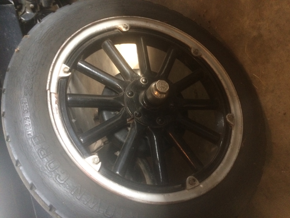

The interior and exterior view of a FOR SALE TT 6.00-20 wheel, rim and new tire and the mounted wheel picture is of a TT 32-4.5 wheel, rim and tire. Both will have the emergency brake drum. I also have some good TT emergency brake shoes for sale. I hope this helps

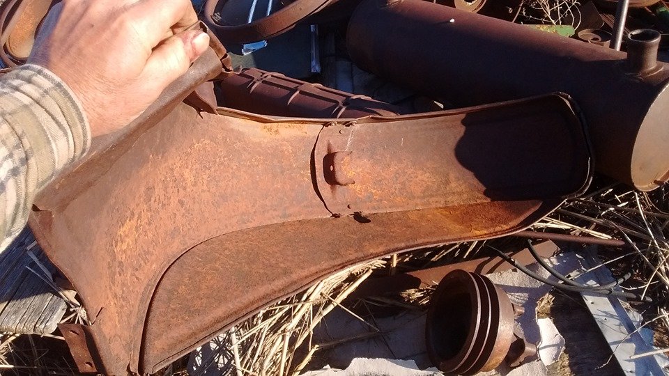

Here is the fenders and small center wire wheels, Thanks

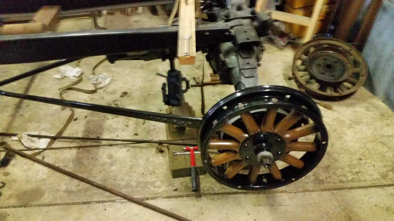

Here are what mine on a 25 TT look like before and after refinishing

Should have clarified, mine are 20's with 700 20 tires

That is a Model A wire wheel. I have a friend in Salinas(sp) that might be able to help you out. Is that relatively close to you?
