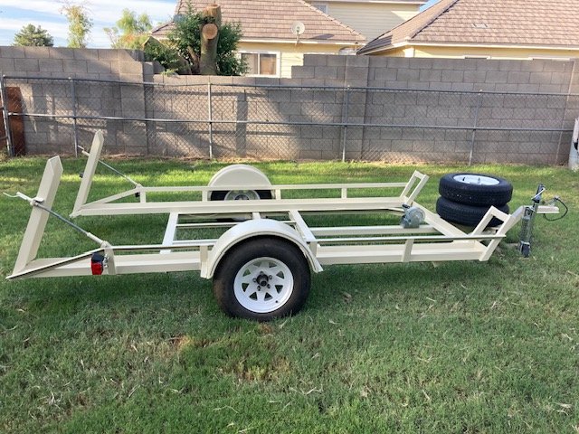

Hi Bill,
Landscape trailer or utillity trailer? I'm assuming it is a basic angle iron, wood deck, expanded metal tailgate model? If so I unfortunetly
have some experiance with mine to share that may or maynot apply. I have a 16' Big Tex single axle of that type that I picked up for a song &
dance because my 18' tandem diamond plate dovetail is worthless for hauling anything other than cars & tractors. I figured I could haul model
Ts on it if needed & I suppose I could in a pinch. The tailgate is too short for comfortable loading but tall enough that it turns into a parachute
at 65 mph so I get the same lousy milage loaded or empty. As bad if not worse than the much heavyer tandem. I would suggest getting a pair
of long ramps if it does'nt come with them. I would install a low means of tying down as the top rail will let the T float around. Make sure the
wood is good where the wheels set. As mentioned by Robert find a way to meassure the tongue weight with the T on the trailer & mark or block
the trailer so you dont get to little or to much weight on it. ( this goe's for any trailer as it is easy to just tie up to the front rail & that in many
cases will overload the tongue ) Check with your insurance carrier as many will not cover your trailer if in a accident.
Craig.

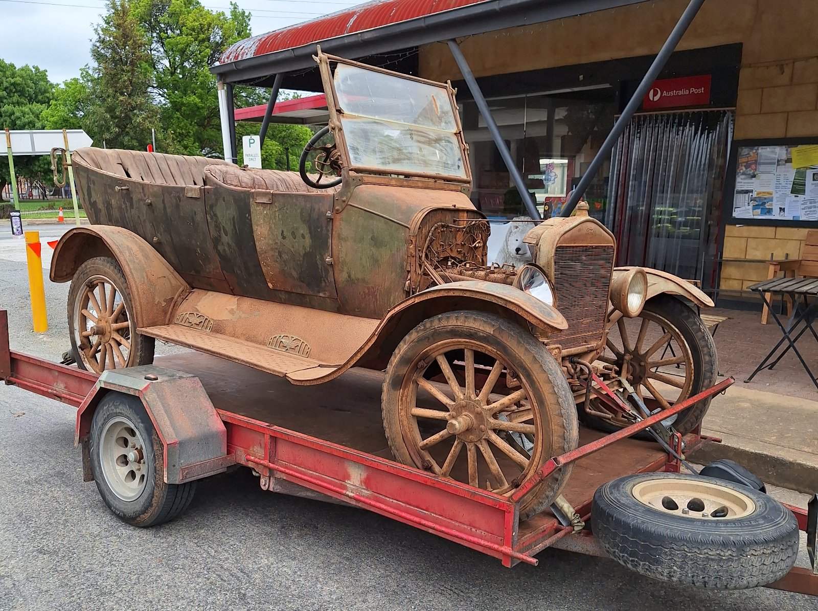

My single axle trailer is quite adequate for a T.
I have built and sold 5 of these 6' x 12' tilting trailers. The key to loading is the restraining bar at the front.
I drive the cars up the tilted deck to the bar. A good handbrake will hold the car there while I get out to lower the deck.
Again the bar is key. Two short 2000kg tie downs around the front axle tie the car forward, and DOWN. There is no real load on the axle/ radius rod. All the tie downs do is hold the tyres against the bar.
Similar tiedowns go round the outer ends of the rear axle. These do the work of holding the car from going forward on the deck.
I have used this combination to haul T's to rallies aĺ over the country. I have had two blow-outs. It was just a matter of pulling over in a convenient spot and fitting the spare. Absolutely no dramas.
My cars are all open cars except for a 27 Tudor. I have corflute panels to zip tie over the windscreens, the headlights and radiator. The tops are folded, or in the case of Henrietta, removed and put in the pick up.
It does not have to be complicated.

I forgot just how much thought goes' into towing. Trailer capacity, tie downs, tow vehicle, decking, ramps, securing things on the car being
towed. Overall weight & brakes seem to be somewhat left out. I only use my pickup for towing about 5% of the time I drive it so for economic
reasons I have a V6 manual trans 1/2 ton. When I tow the fire truck on the tandem dovetail I'm within 100# of the max towing capacity. I don't recommend pushing the limit that much as it will slow you down going up hills & push you down them. On that trailer I have 4 wheel brakes
that will by themselves stop the hole rig if needed. I have a professionally built custom single axle trailer that I pull my speedster with that
only weighs in at 500# and tows very well. I guess what I'm saying is make sure your tow rig and your driving ability is safe enough for the task.
Craig.

Craig,
Excellent points. Many, commercially built, trailers have either 3500lb or 6000lb axles. Trailer axles available: 2000lb, 3500lb, 6000lb, 7000lb, 8000lb, 10000lb, and 12000lb. I have a half ton pick up. My total towing weight with the TT and trailer is 5000lb on a twin axle trailer. If I move up to the 6000lb axles, the law says I need a 3/4 ton truck based on the Gross Vehicle Ratings, and it doesn't matter if you're towing less weight or not. Check your vehicles' GVW ratings for towing capacity AND GVW load ratings.
NOTE: In Craig's photo, there are 2 spare tires. As wise choice for a single axle trailer but a tad bit of overkill as the possibilities of BOTH tires going flat is not high, but still a good idea. My son taught me: IF you have a double axle trailer, ALWAYS carry 2 spares (at least). The reason: IF you run over something that will flatten a tire, you have a great potential for flattening BOTH tires on that side.
NICE trailer Craig. A real beauty.
Good Luck

Two Spares is a result of past experience. I have had two flats more than once on a trip. I loaned my tandem trailer to the XW & HIL once & it
came back with three new tires on it. I don't run trailer tires more than five years regardless of tread depth, tires are cheaper then body work.
Craig.
