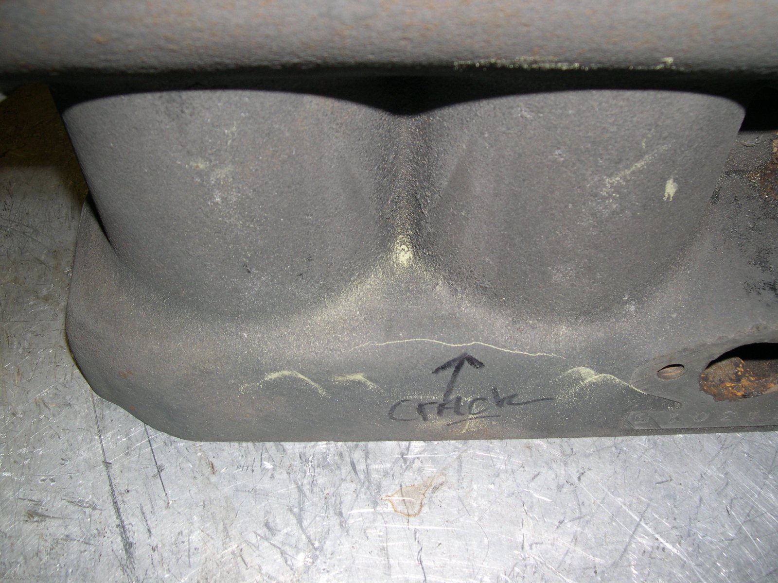

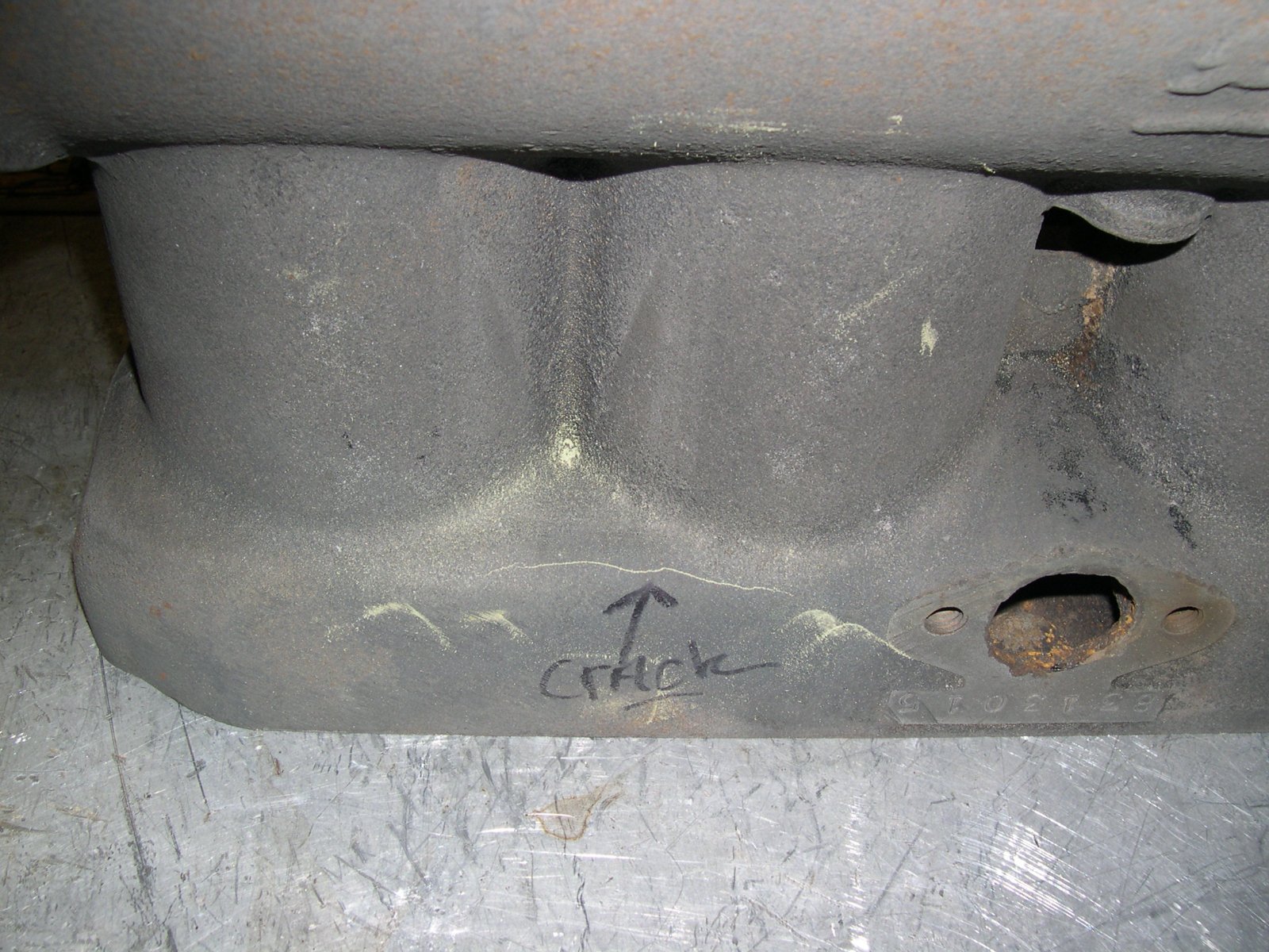

Greetings Everyone:
RE: Water Jacket Crack -
I've just started rebuilding what appeared to be a good '23 block to replace the tired engine in my '23 touring car. Yesterday my machinist discovered a fine crack in the water jacket area of this "new" block. It is in that "classic" spot on the lower left hand side.
I've seen lots of posts and articles in the club magazines over the years about this issue, but I have it admit that I did not pay enough attention. I just did search of this Forum and didn't find too much information.
My questions are: 1. Do you think this is a serious crack? 2. Do you think it will get bigger? 3. If you were rebuilding this block, what repair would you undertake, if any?
Here are some pictures: For what it's worth, the block currently in the car (last rebuilt in 1990) has an even bigger crack, which I fixed years ago with a slathering of J.B. Weld. It's still holding, but I always felt it was kind of a "cheat" repair. But maybe not!
I am aware of the "dangers" of Lock-N-Stitch in this area. The Babbitt is good on this block, by the way, which is why I don't want to discard it.
I look forward to your suggestions. Many thanks for your kind attention.

1. No.Rick_Benjamin wrote: ↑Fri Feb 09, 2024 9:47 pmGreetings Everyone:
Sincerely,
Rick Benjamin
Lewisburg, PA
2. No.
3. I might try applying some "weeping" LocTite, type 290, https://www.walmart.com/ip/Loctite-290- ... 010506fee7 . Or, if it does weep a bit, it will probably seal itself off. I have pretty much the same crack in my '21 Runabout. It's never left a drop on the pavement and I've never done a thing to seal it.

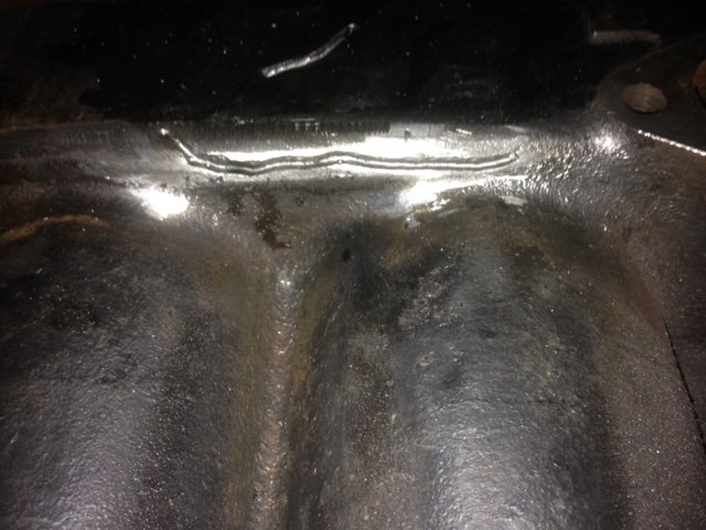

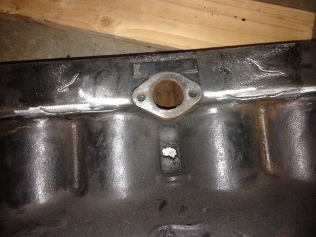

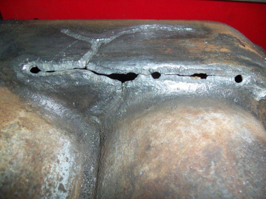

Here's a block that had been soldered up - never got the weeping to cease !

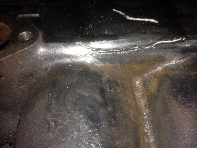

There was a how in one of the Ford Owner and Dealer magazines on soldering cracks with lead. I have done it a few times with success.
I also have used lock n stitch too. Most blocks are too thin there due to core shift.

I drilled holes in the ends of the cracks. Used an air file to groove the block. Used Belzona which as someone else just mentioned is expensive. It is a 2 part mixed molecular metal as Belzona would advertise it. My babbit was good too. Belzona dries very hard. You have to file it smooth as sand paper won't work. I used it in the paper mills to make emergency repairs to pumps and steam valves. I have a thousand miles on that engine now since everything rebuilt except babbit in mains and rods. It had plenty of shims to get a thou and a half tolerance.

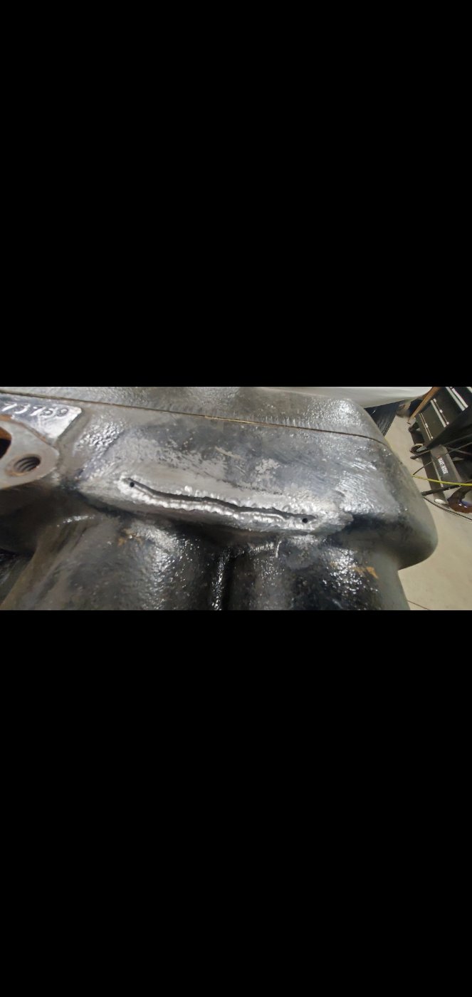

Here's another option which I think is the correct solution and permanent repair. I do this in my shop. Have someone who uses lock-n-stich products and finish with Irontite ceramic block sealer which is applied by circulating the block with a plate on the top and the solution flows at about 180 degrees and puts a ceramic coating and seals the water passages and stops any further rusting.
