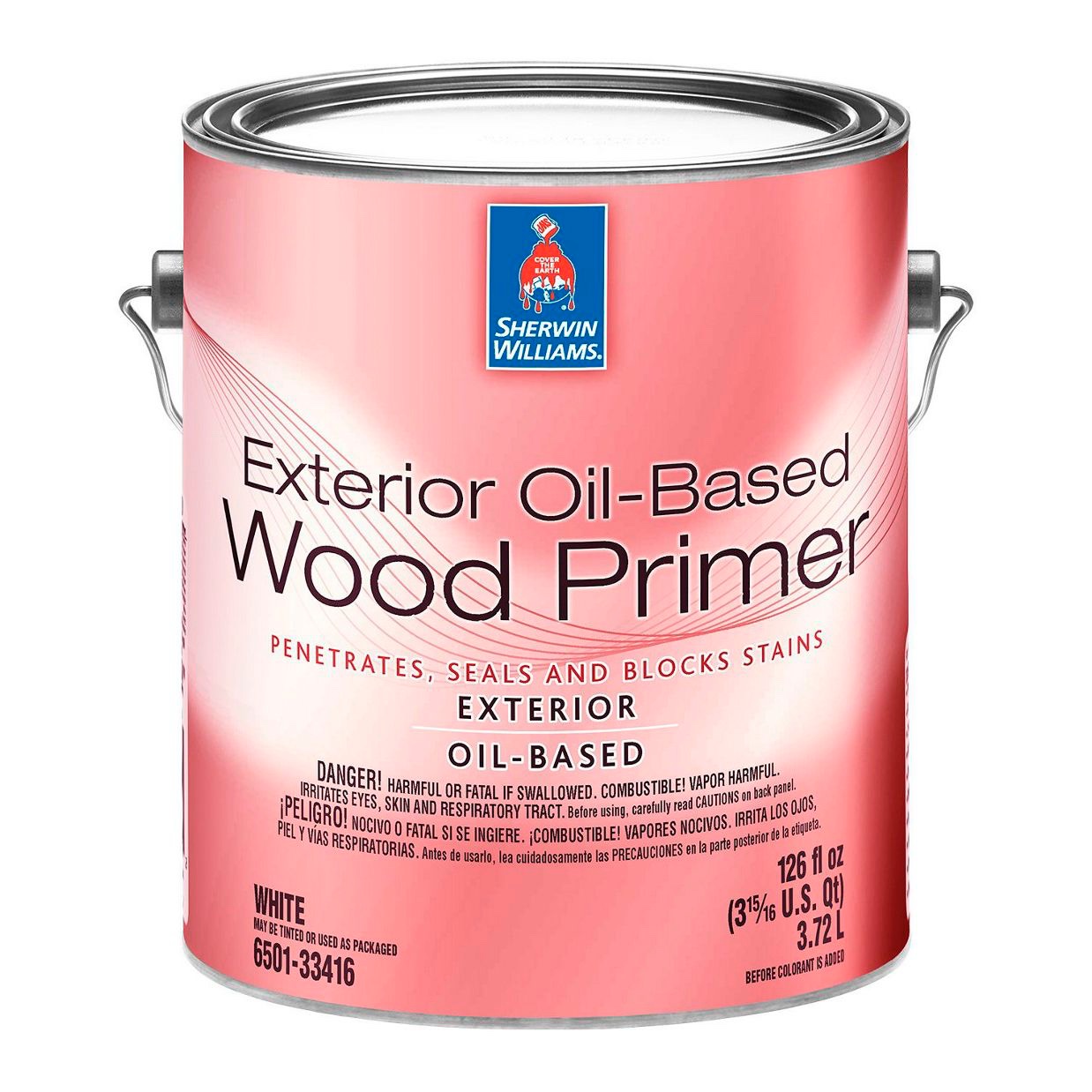

Post by jiminbartow » Fri Feb 23, 2024 4:18 pm
I would use a good oil based primer. With a good oil based black enamel over it. The primer penetrates deep into the wood, providing a good base for the finish coat to adhere to. I painted my house 30 years ago, primed with Sherwin Williams exterior primer and it is still protecting the house. Jim Patrick
