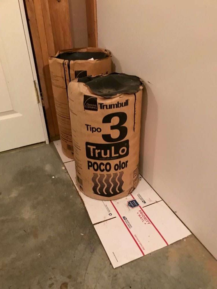

When you contact roofing contractors looking for coil rebuilding tar specifically ask for Type III Steep roofing asphalt.
Ron Patterson
Ron Patterson
Re: Coi Tar
Post by Ron Patterson » Fri Feb 23, 2024 6:14 pm
Here is a photo.

Post by J1MGOLDEN » Sat Feb 24, 2024 7:49 pm
There are three or more heat levels, you have to get the highest one.
That one Ron showed you weighs about 80 pounds and costs around $150.
Almost a life time supply though!
