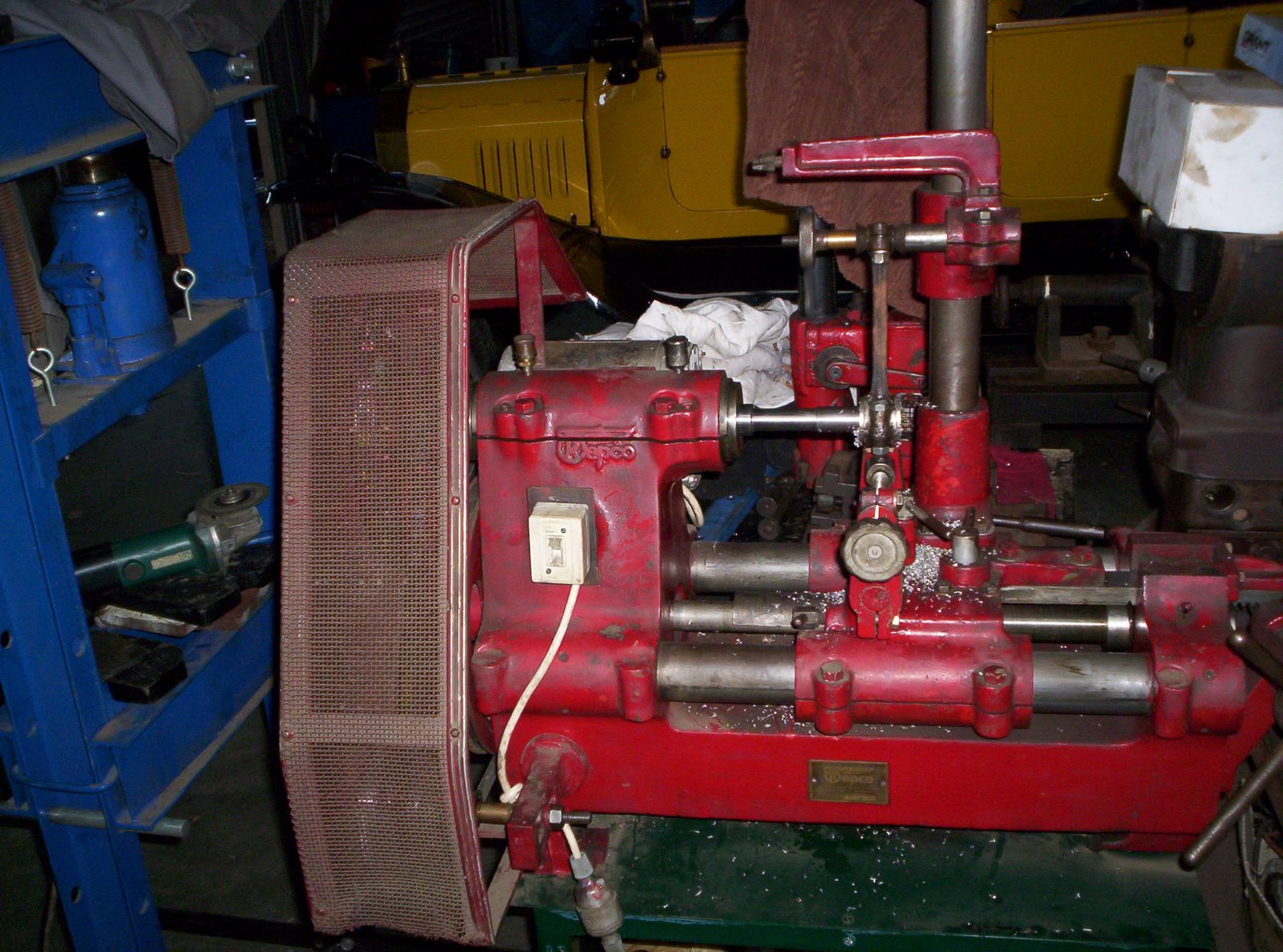

Sounds like a plan, my crank grinder does in .005" increments and often end up with inbetween size journals, no problem as
I do my own rod work.

nice rod lathe. i will be using a bridgeport and a fixture i made. philip
