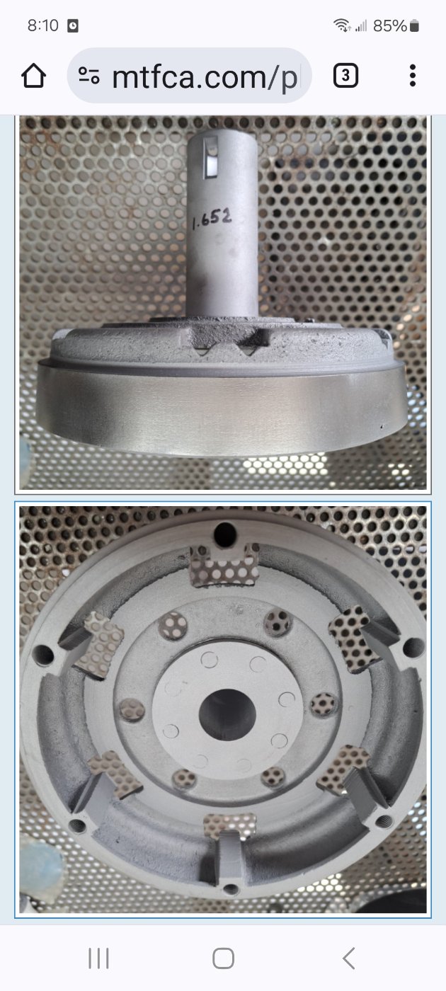

Has anyone adapted the 26/27 sheet metal lugs to fit the earlier brake drum?

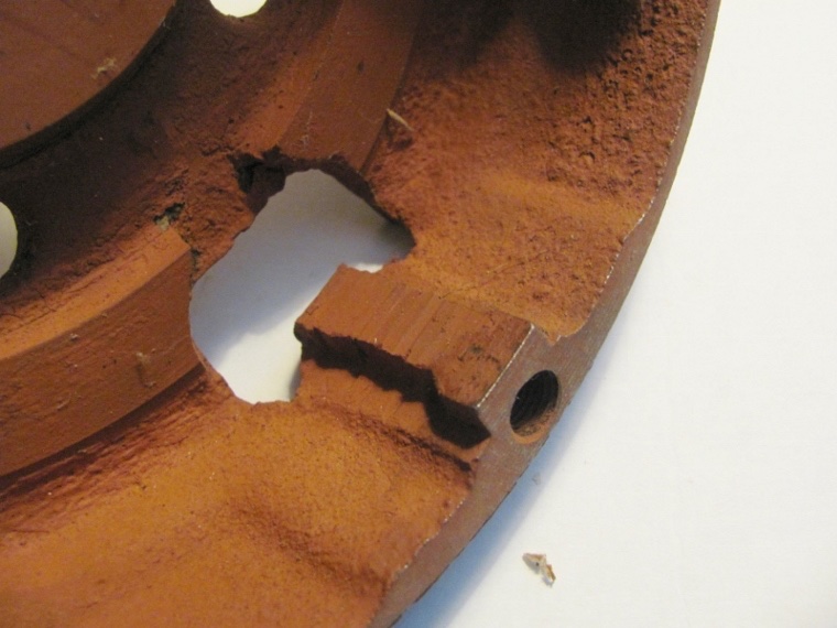

There is no room as the other Dan stated above. Trying to cut the sides of the bosses to install the replaceable lugs is not possible because the driven plate attachment threads/holes would be severely weakened.

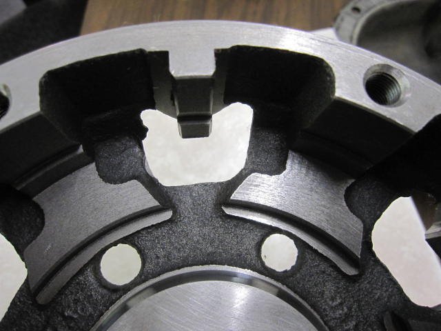

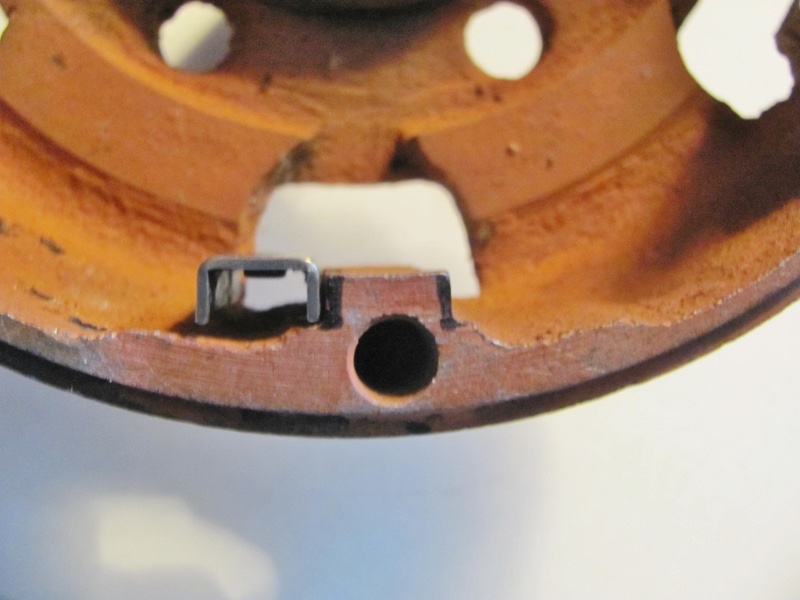

As others, the lug boss is rather narrow to begin with on the small brake drum. Ink mark shows what might be needed to cutaway to install the replacement lug.
Then again, the lug may look like this! Hardly anything left to cut on.

I don't know if they are still available, but years ago someone was making new narrow late '25 style brake drums with the extra bosses for the later lug shoes cast in, my '24 came to me with one.
Update - looks like Lang's still sells it as a bare drum, you have to rivet it to your shaft. https://www.modeltford.com/item/3311D.aspx

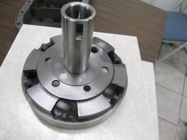

Dave Nolting drums have the lugs for the shoes for the early cars if that’s what you’re asking.

The threaded holes on all brake drums, early and 26-7 are a weak point. Both styles are often cracked. Machining the earlier ones would only make the problem worse.
Best solution is a Dave Nolting new drum with the separate clutch lugs. Next best is a good 26-7 drum and drive plate, which is a trouble free drop in solution with the added benefit of one continuous brake drum surface rather than the often stepped surface of a mis-matched drum and driven plate.
Or, hunt down a good original, with little drum wear, no cracks,smooth clutch plate lugs and sound threads for the driven plate bolts. Good luck with your search.

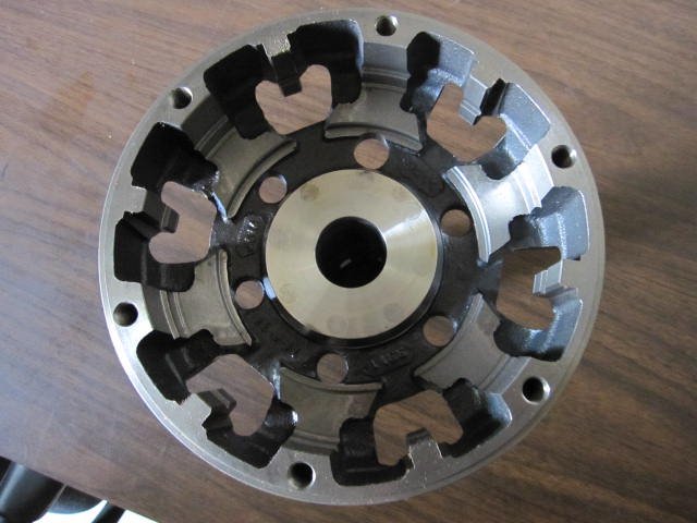

Yes we make the drums and gears and sold as an assembly.CudaMan wrote: ↑Fri Mar 01, 2024 8:23 pmI don't know if they are still available, but years ago someone was making new narrow late '25 style brake drums with the extra bosses for the later lug shoes cast in, my '24 came to me with one.
Made exactly to the Ford print not a cheap copy.
