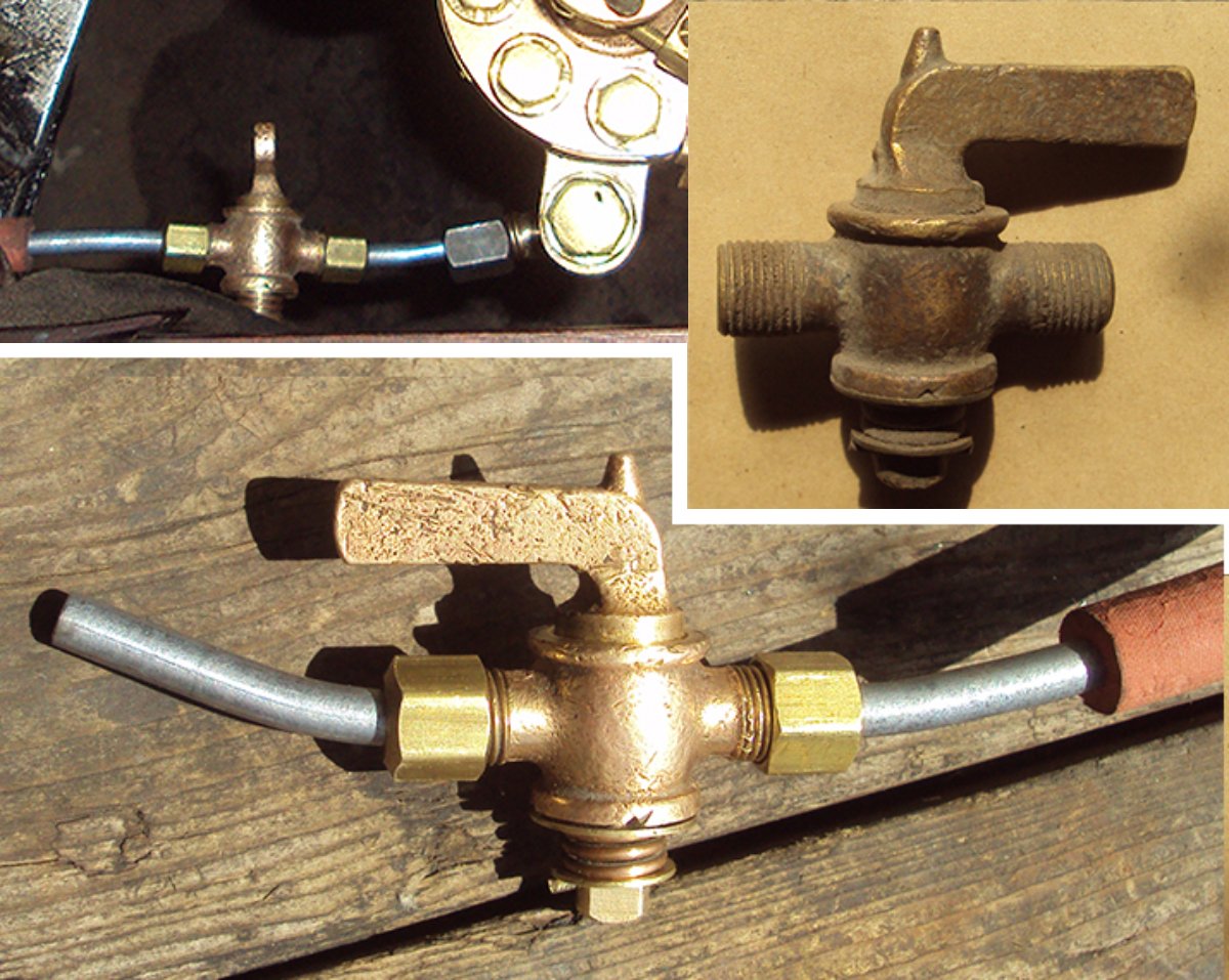

Only options are to take it apart and "lap it" with that yellow stuff...I forget the name of it...or buy one of those repop cheapie things that frankly ain't no good. After two weeks you'll be using pliers to turn it and it'll probly leak also. Rotsa ruck buddy!
- Posts: 5390
Re: Fuel shut off valve
Tim is correct - Time Saver is the lapping compound then re-assemble with Aviation fuel lube. The trick with the available valve is to lift up slightly while turning then slight downward pressure when you want it where it needs to be.

My valve at carb weeped..replaced with new one from Langs. Steve at Langs said they dry out and the fuel "cruds" them up over time. Said you can rebuild or get new one. Got new one and rebuilt old one...lapped the old valve..used EZTurn sealant on valve. Turns freely now..put away for use as a spare. The old valve was tough to turn..used a pliers sometimes.

I've been using the same tube of EZ Lube for 20 years - nothing in it's compound to go bad !

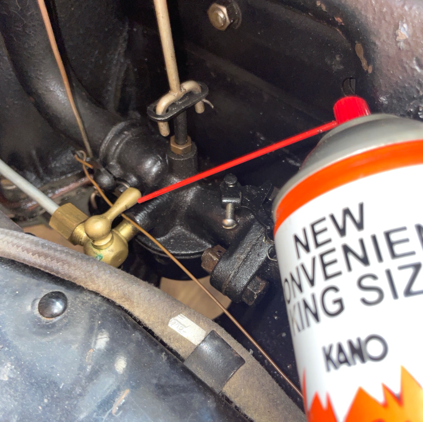

Modern gasoline has so much environmental additives that gum up most anything
If the gas sits too long, like in a carb or shutoff, then things can stick.
My fix is simple, a shot or two of good penetrating oil. Lift the shut-off handle a bit, spray a shot, then twist a few times, spray again to freely turn.
Works for many months, then when sticky again, repeat the process. Easy peasy.

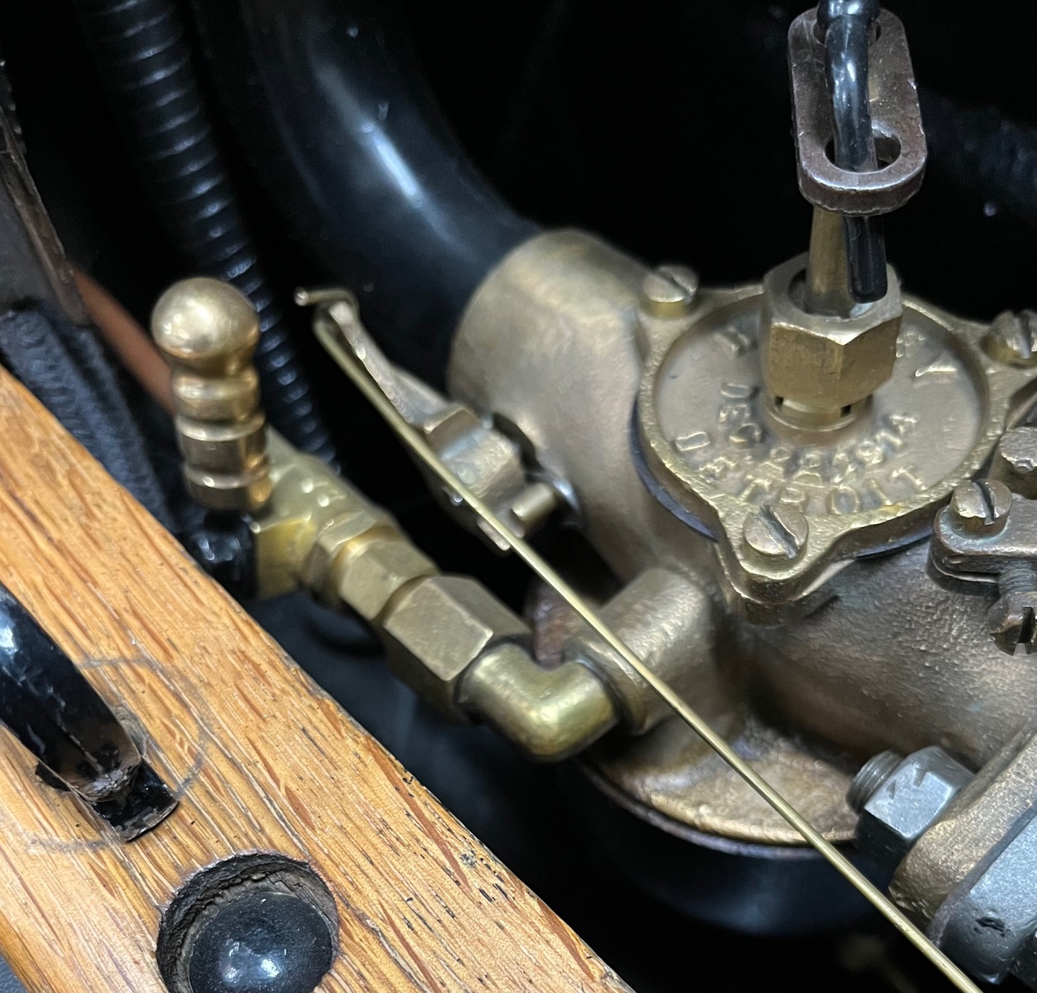

I found some old valves at a swap meet that I like to use. I don't know how old they are but I'm happy with the look and they work well.

The aircraft EZ lube works great. Make sure the extra goop does not block the hole or you will be taking everything apart again. While apart, try to stretch the spring a bit, not much, to make up for the collapse that happens naturally over the years.
