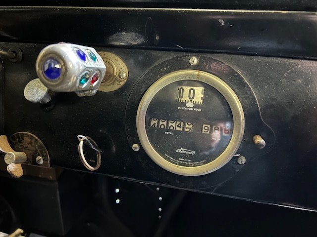

The driven gear for the speedometer needs replaced. The odd thing is it's a 17 tooth gear and all of the replacement ones I can find are 16 tooth. I have no idea of what it was originally on as I found a receipt from when the guy that restored my T bought the whole package at a swap meet back in 1980. I think he paid $100 for it. If I have to I'll draw up a gear in Solidworks and make it.
While I have the drive pulled off, what maintenance should I do to the drive and cable?
