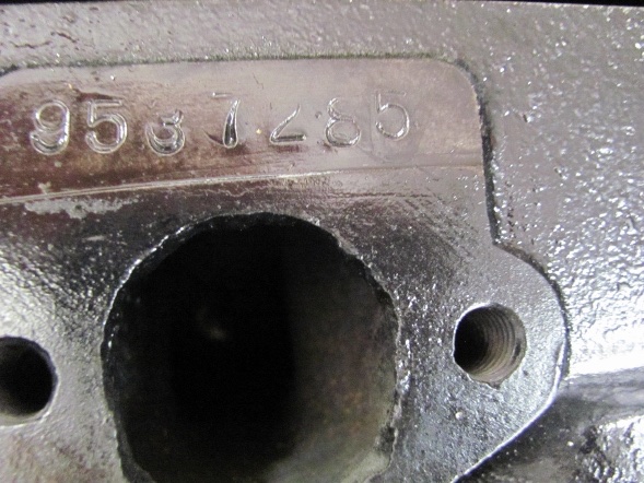

When using a set of number stamps, how much effort should be required to stamp new numbers into the block pad above the water inlet on the side of the block? I have a block that's original use was probably for a stationary engine as it has a non Ford type motor number stamped on the pad of a 1927 vaporizer block. I know its going to require a machinist's hammer or such to hit the stamp hard enough with; a carpenter's claw hammer or a light weight ball peen hammer isn't going to be heavy enough. I only want to hit the stamp hard enough to create an imprint like the factory did, and not cause damage to the block. What do those of you who have experience, recommend?

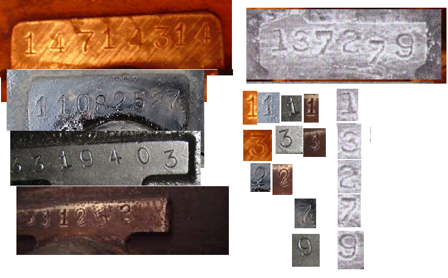

2. The stamp font should be similar to what as well. Aliment isn't to critical but reduces suspicion

Terry, you don't need to stamp the block at all. Get a sheet of white paper, dirty up a finger, and make a pressing of the block water outlet/engine number pad. This will give you a paper template to make a brass sheet cut to shape. Then stamp the number you want on the sheet off the car, with whatever stamps and hammer you like. Then fit the nicely stamped brass plate to the block with a good smear of black RTV, then the usual gasket and the water outlet casting. You can smear the excess RTV around the edges of the plate and no-one will ever know .

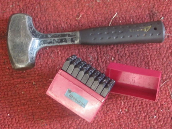

We have stamped both thin data plates as well as engine blocks with serial numbers. The data plates take very little force as you will go right through the brass or zinc plate. The engine block can be done by hand with larger numbered stamps and a 2 or 5 pound hammer. We cobbled up an old socket to hold the numbered stamp die so we did not mash our fingers. Drew a felt pen line so we could be reasonably straight and hammer away.

Have done both, the brass tag, cut to fit completely over the boss, then stamped, and using J-B Weld Quick glued over the serial boss.
Have also filed off an original serial and re-stamped. The brass plate was very good at hiding, and looking original.
The file drag caused a line across the boss, if you used a mill you could get a true flat boss. Then you have to choose nice fonts, I found Harbor Freight numerals to be pretty good to use. A 2.5 lb. mallet was best, but the factory guys used a machinists hammer with a wide swing, but they did thousands!
Takes steady fingers to hold the small stamp dies, and worry of hitting them with the hammer
So some are more faint than others, but it sort of looked like some factory stamps, but the file line is a give away. The brass tag over was better looking and less work.

I use a 3 pound hammer and a decent swing.
