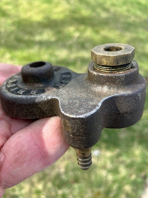

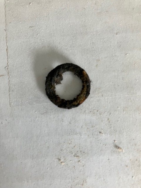

Here's some pics of a of the top of a Bridgeport No 5 I happened to have off a pump. You can see how the top of the pump and the nut squishes the packing. The "antique" packing seems to look like it is oil soaked leather.

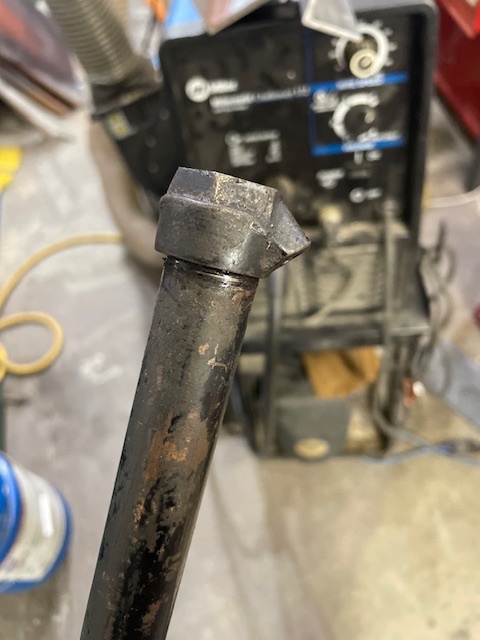

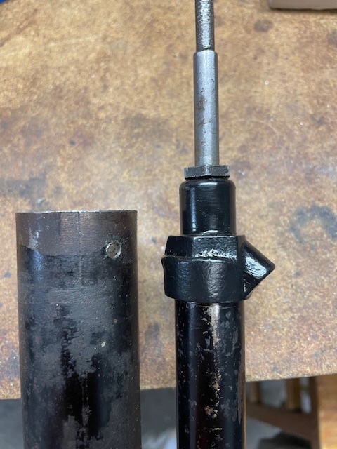

I got this pump and in addition to the standard worn out leather cup seals, the threaded portion of the cast iron top on the small tube was broken. I made another one of steel and silver soldered it in. So now I now have good threads. The packing goes inside the threaded part and is compressed by a hollow bolt of sorts (that allows the rods to pass through) that compresses the packing. I still need some cup seals and a new hose so it’s still in bits. I have been thinking about making the cup seals (not a tough job) but I might order them.
Here is a photo of the top of the small tube I fixed. The round top is the new part I made.
I added a couple of shots of the repair in progress.

Morgan: Nice work there. My experience with 2-stage hand pumps has been that the pump rod on the small cylinder has to be perfect, any pits or surface roughness will quickly destroy the upper seal. jb

That makes sense. I plan on polishing the rod and if it’s rough, I can replace it.
