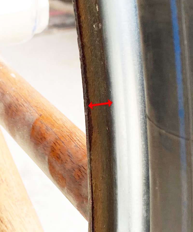

I ordered rims from Australia... unfortunately the placement of the raised "bump" behind the lugs would not allow the rims to go on the felloe far enough to make contact with the rear flange so they were just running on the lugs and the front of the felloe. The nuts won't even go all the way on the lug bolts so there was no way I was going to drive on those rims.
The rims do fit the narrower Kelsey felloes but not Hayes or Ford felloes. I've had some discussion with the seller about the problem but he has not replied to my last two emails.
In the photo you'll see the gap (arrow) between the rear flange of the felloe and the rear of the rim. They should be making contact.
