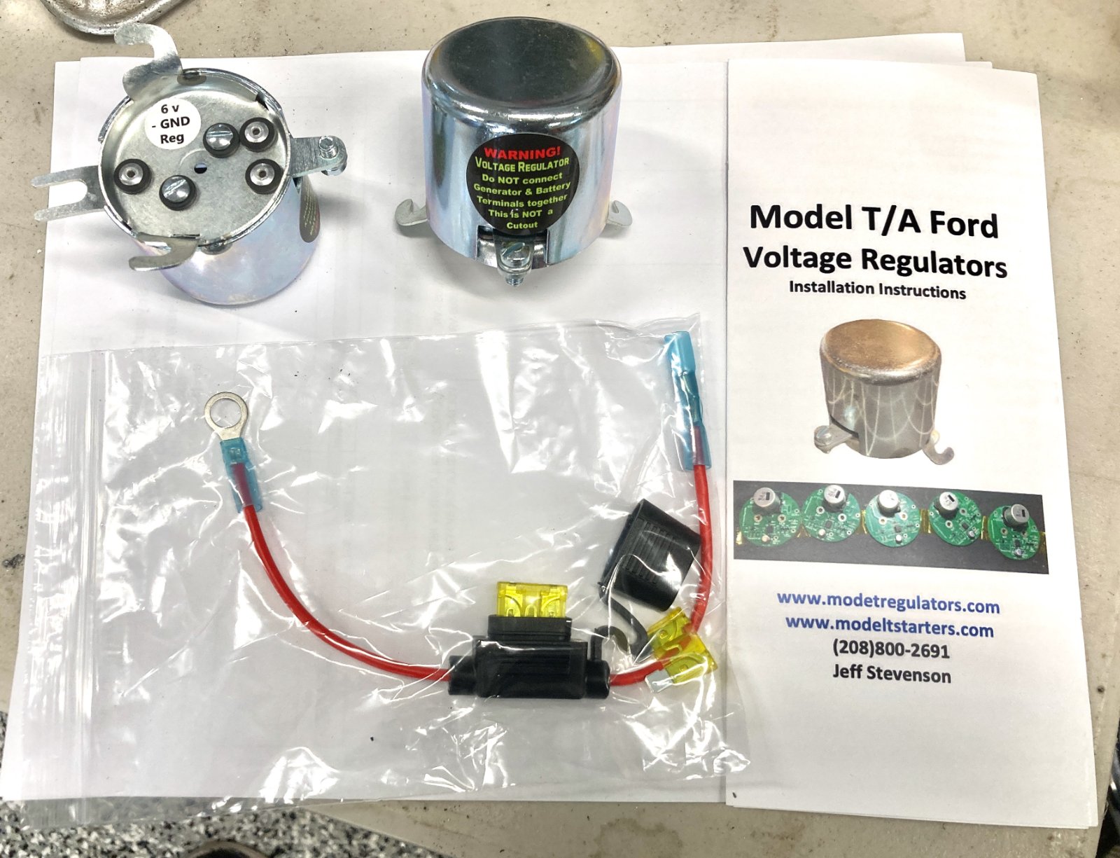

To help prevent this in the future, ALL my new VR's now include this little warning, right up front. Remove it at your own risk!
If you want one of these stickers to put on your FP regulator, let me know - Im happy to send you one, no charge.

I’m working on that! A round sticker on the bottom.
If you pop the top off, all my contact info is on the circuit board.
The new tops fit so well that I’ve decided to stop spot welding the tops on and just put a slight bend in it in 2 spots. This also means it will be user adjustable (there are pros and cons to this). If someone needs to raise or lower the charge voltage, it is now possible.
