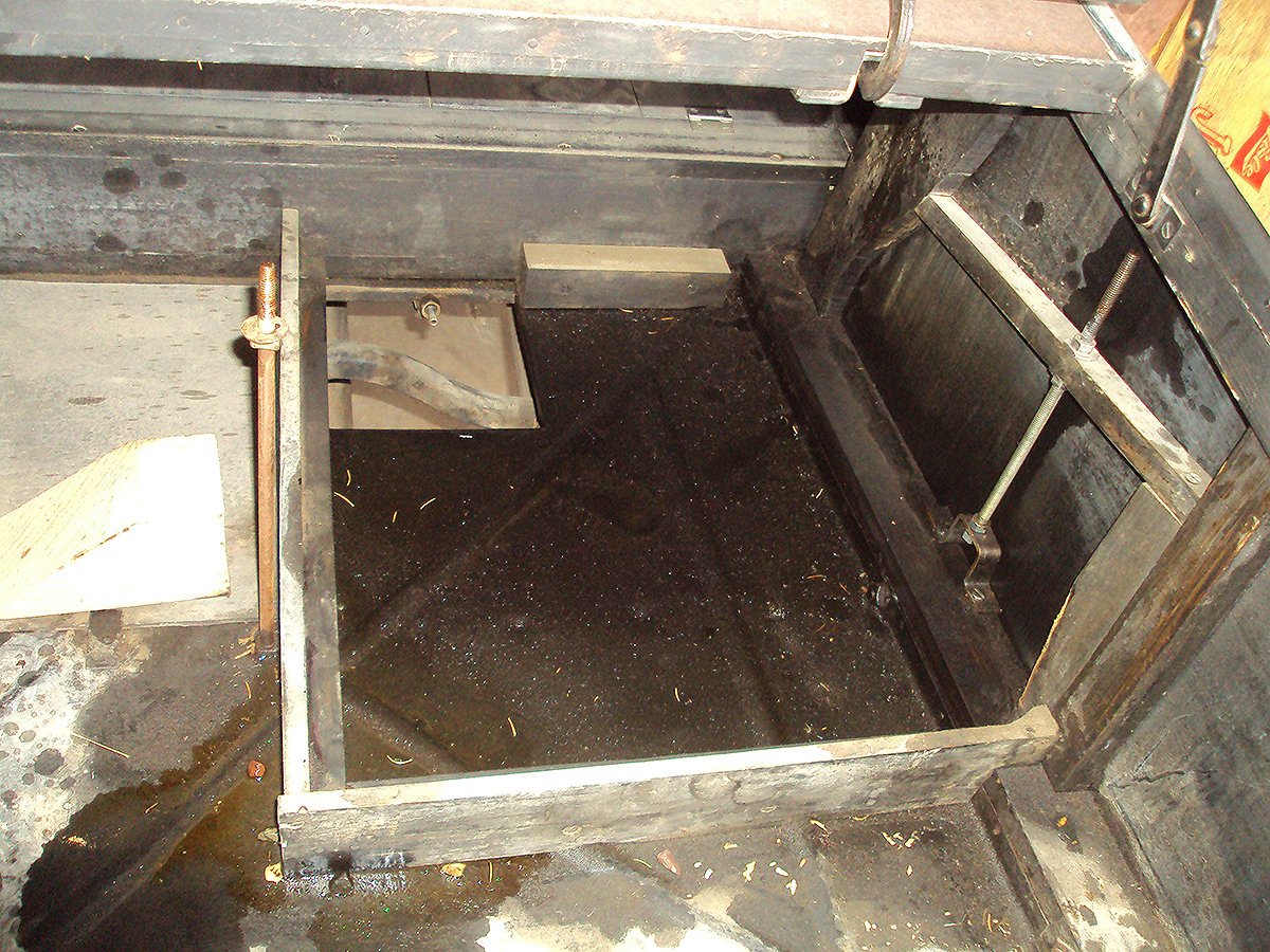

I have a 22 doctors coupe and the gas tank was just set inside the truck with a couple of two by fours which were not secure to the floor and it was not mounted level. Does anybody have pictures or descriptions of how it was? mounted If you see missed spelled words, I'm letting the computer spill because I can't oh, I need the measurements for the platform that the gas tank sets on the gas tank it's not square so the platform is angled so I would appreciate that information

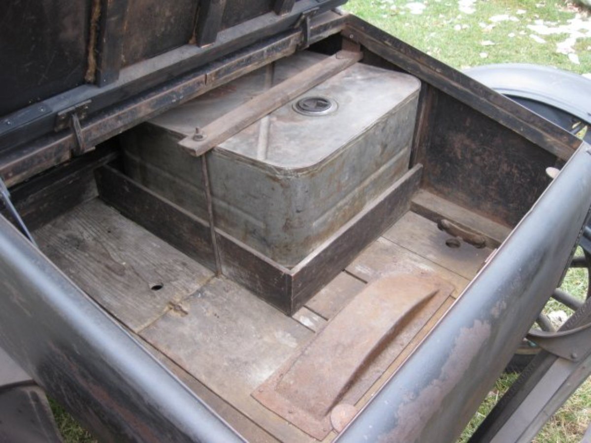

Post by Rich Eagle » Fri Mar 22, 2024 1:36 pm
I hope these help.
This is how I installed mine.
These have a bracket on the right side which is more correct.

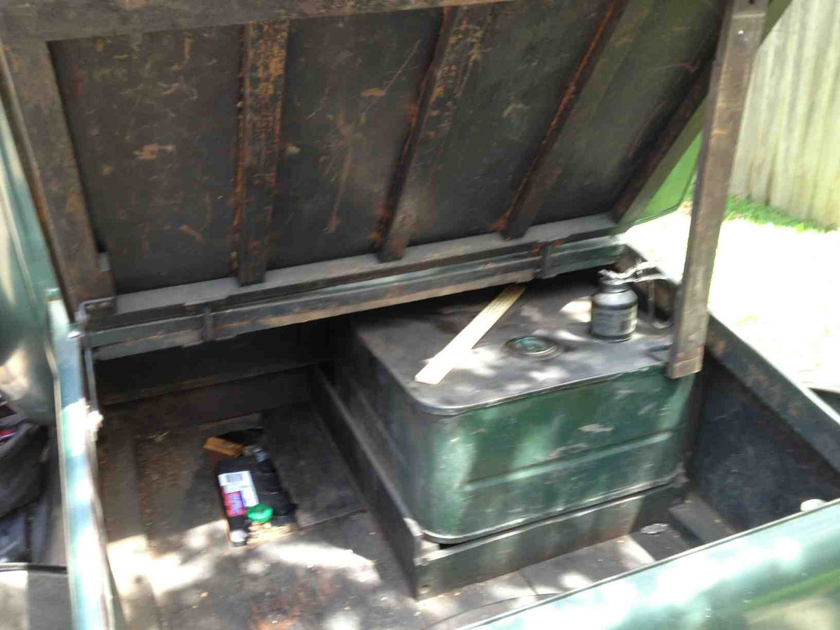

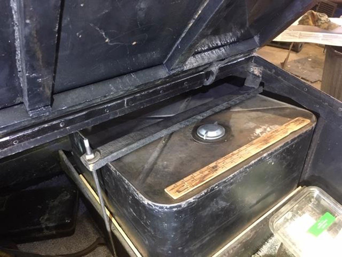

Post by Been Here Before » Fri Mar 22, 2024 1:49 pm
Yep. This is more accurate, as my 1922 Coupe has the same arrangement.
borrowed photograph.
Square tank is positioned on a squarish platform with a 2x1 ish hold-down.

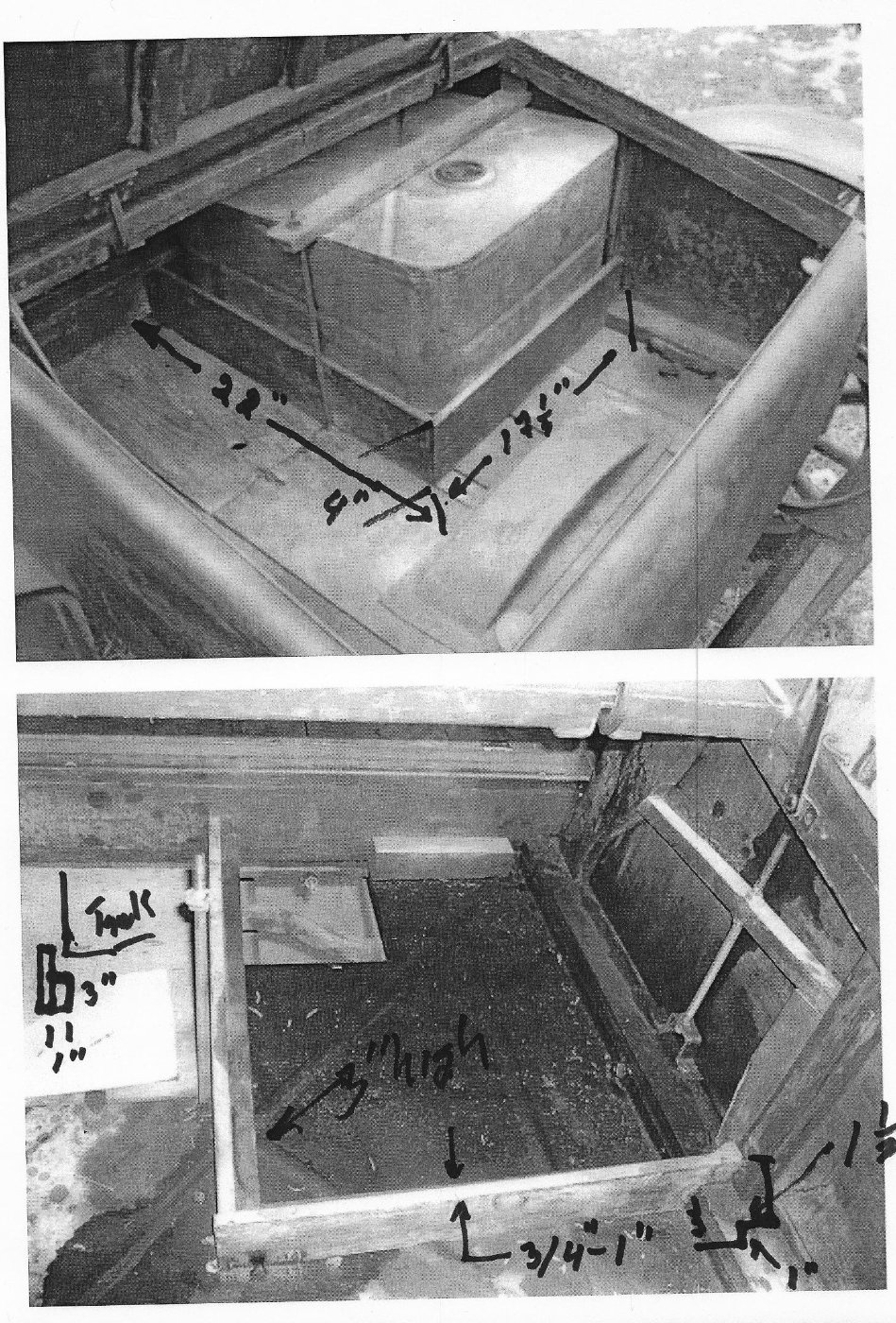

Post by Been Here Before » Fri Mar 29, 2024 5:57 pm
The request for 1922 tank support may be answered. If not this is what my car has for measurements. All in inches.

Post by Wayne Mims » Thu May 30, 2024 6:48 pm
What measurement is missing move to top
