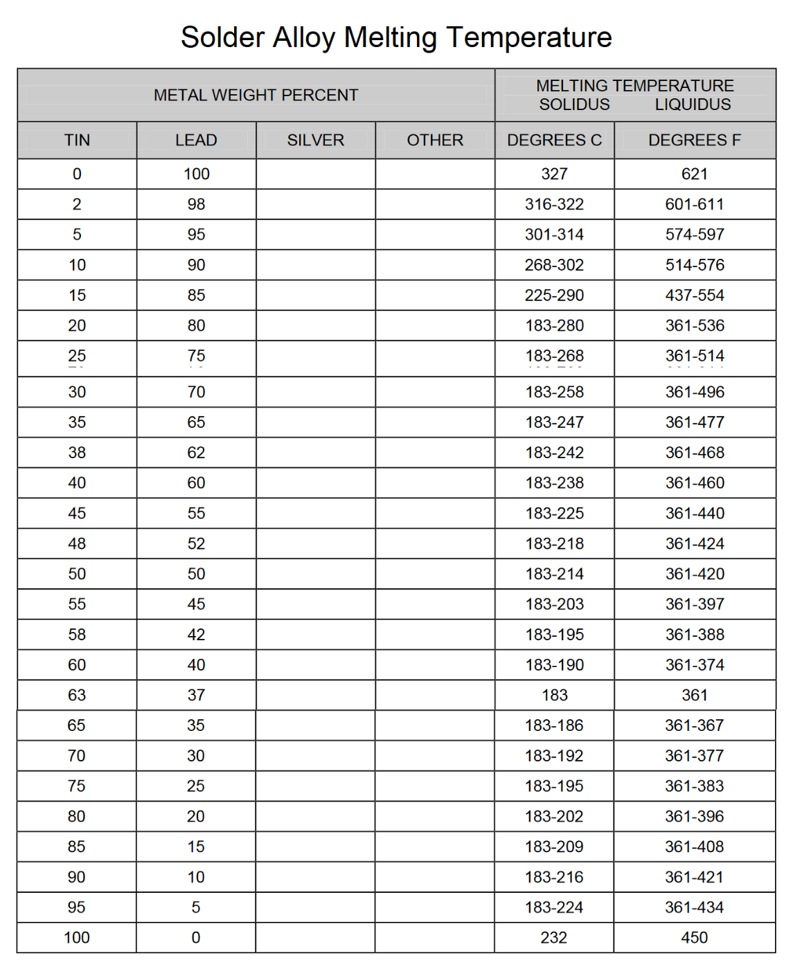

Not sure what ratio solder is being used but likely Ford used 50/50
Bottom line no fumes - no problem. Case where there was an explosion - underestimated fumes
